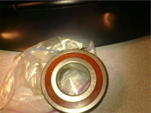

If its necessary to replace the Outer Tub bearings, (at this point of troubleshooting I believe you will) Tub Seal and Tranny O-ring the cost should be under $60. The Outer tub bearings are 6207-2RS you would need two. Google for best price. You can get the Tub Seal Tranny o-ring thru this site. I just want you to get a feel for cost. I can help you with part numbers.
Quick Google and I found the 6207-2RS bearings for under $6 each no shipping cost info…Dick

Qty 2 6207-2RS Bearing 35x72x17 Sealed

Putting back together the spinner support - did an outer tub bearing replacement, tub seal, etc. Can you tell me how snug the spinner bolt on the spinner assembly should be? Shoud the spinner support rotate? Thanks. Bob
[quote=bobdicks;430116]Dick:
Putting back together the spinner support - did an outer tub bearing replacement, tub seal, etc. Can you tell me how snug the spinner bolt on the spinner assembly should be? Shoud the spinner support rotate? Thanks. Bob[/quote]
Hey Bob,
The SM on page 19 top left states 64 to 80 ft lbs. I used no torque wrench just snugged it down. Yes the Spinner support should rotate. Do you have any binding? The Spinner Support is riding in the Outer Tub bearings you replaced.
Did you follow this post for your work? FAV6800A/FAV9800A Outer Tub bearing replacement
Did you remove the old Tub Seal aleeve see on post three of that thread?
Did you replace the Spinner Support bearings with your rebuild?

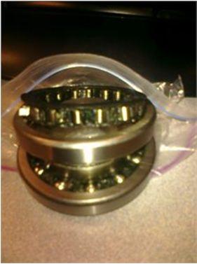

The new Outer Tub redesign incorporates the One-Way Upper bearing ring One-Way bearing as part of the Lower Outer Tub Bearing assembly. You would not use the Upper Bearing ring on your replacement Clutch Pulley with that new Outer Tub with no notches.
I got to give this a try and see If i can get them to send me one. That’s a $400+ part retail you got from them. :smiley:
Good Luck…Dick
Dick:
Do you happen to know the part number of the clutch for the redesigned tub? I will probably need it in the future if my “old” tub bearings fail.
Also, when I called Maytag for the replacement, I only told them that the old outer tub failed and was leaking. I did not speak specifically to the tub seal leak or bearings. Good luck.
Thanks. Bob
I use this Clutch Pulley p/n [COLOR=#000000]25001169 used for all FAV6800A/FAV9800A original Outer Tub and your new redisgined Outer Tub. I find it for under $80 + shipping. For you new Outer Tub you don’t use the Upper Bearing ring above the Clutch Pulley. That’s the only difference. That Upper Bearing ring functionality is now a combined bearing assembly in the Lower Outer Tub bearing assembly. Here is what it looks like;[/COLOR]
