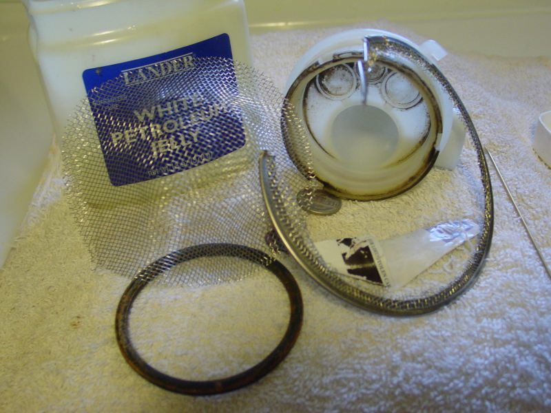

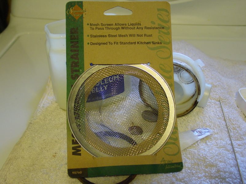

[COLOR=#333333][COLOR=#333333][SIZE=3][FONT=Calibri]“”(We do animal rescue and have washed a LOT of animal hair covered beds/etc…so I fear what is inside…but we ddefinately cannot afford to replace the machine).“”[/FONT][/SIZE][/COLOR][/COLOR]
[COLOR=#333333][COLOR=#333333][SIZE=3][FONT=Calibri][COLOR=#333333][SIZE=3][COLOR=#333333][FONT=Calibri]Good for you on the animal rescue and your DIY efforts. The machine is very easy to work on (except for the drain pump and pressure switch). So let’s DIY this puppy. :slight_smile: [/FONT][/COLOR][/SIZE][/COLOR][/FONT][/SIZE][/COLOR][/COLOR]
[COLOR=#333333][COLOR=#333333][SIZE=3][FONT=Calibri][COLOR=#333333][SIZE=3][COLOR=#333333][FONT=Calibri]We have a stray cat that has been hanging around since spring and have been feeding him. Looks like he was tossed out a of a moving car, face scraped up and left front leg damaged we call him Limpy. He has only three good working legs.[/FONT][/COLOR][/SIZE][/COLOR][/FONT][/SIZE][/COLOR]
[COLOR=#333333][SIZE=3][FONT=Calibri][COLOR=#333333][SIZE=3][COLOR=#333333][FONT=Times New Roman][FONT=Calibri]Back on topic… I recommend to all FAV6800A/FAV9800A owners a DH1200S retro fit of the Sump Cap with a filter screen as I show below to protect the Drain Pump from impeller jams or destruction from debris i.e. coins, stringy fibers from the wash load and pet hair.[/FONT][/FONT][/COLOR][/SIZE]
[SIZE=3][COLOR=#333333][FONT=Times New Roman][FONT=Calibri]The Maytag Skunk Works design team made it extremely difficult to get to the Drain Pump.[/FONT][/FONT][/COLOR][/SIZE]
[SIZE=3][COLOR=#333333][FONT=Times New Roman][FONT=Calibri]Let’s fix the current issue but I would recommend a retro fit of the Sump Cap with a filter screen like this;[/FONT][/FONT][/COLOR][/SIZE]
Removing the Sump Cap is a lot easier then trying to remove the Drain Pump for service…Dick [/COLOR][/FONT][/SIZE][/COLOR][/COLOR]

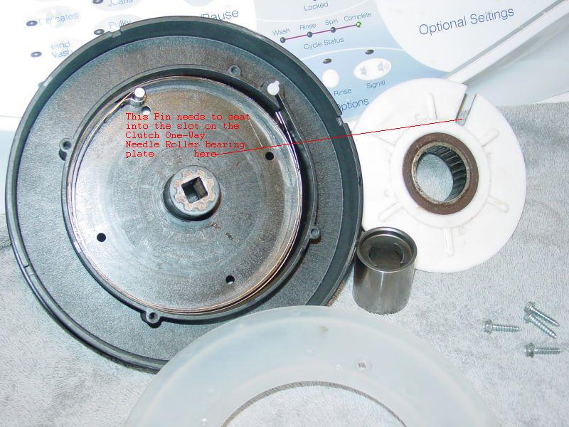

Now I have a problem with the clutch. I followed the instructions you have in this thread. Everything worked well. As far as I can tell, the bearings only allow turning in one direction. I cleaned and greased everything and put it back.
But could the spring be the problem? Before I took the clutch apart, I could hear something clicking at lower speeds (90 and 150 rpm, and even at a little higher). At higher speeds there was nothing.
When I had the clutch apart, one end of the spring was not connected to anything. That seemed wrong.
Now with the clutch back in, I can still hear the clicking. The only thing I think it could be would be the spring.
Does this mean I need to buy a new clutch? I have a machine with a serial number starting with 10.
Thanks!

You provided a picture of the spring with the two pins. The stationary pin in my clutch was loose and not doing anything. So after seeing your picture, I managed to put the loose end of the spring in the hole where that plastic pin goes, and then jam the pin in to pin the end of the spring in there. That was hard to do, but I finally was able to do it.
That may have been the problem. The rest of the clutch seems to work as it should.
I reassembled the clutch and put the belt back in. When I tested the spin at 90 and 150 rpm, there was no clicking at all. So that clicking problem seems to have been the spring.
But I still was not sure if that was the whole problem. I did not know if the washer worked. I had four wet towels to try the washer with. I put them in and gave it a whirl. It did not work at first. It took four retries for the load to balance.
But then it did balance, and moved up the spin ladder. It worked the whole spin cycle, so the four towels were spun dry.
Tomorrow my wife will try another load of laundry. If it all works, thanks again for the excellent info. If not, I’ll post again.

[SIZE=4][COLOR=black][SIZE=3]“”The stationary pin in my clutch was loose and not doing anything. So after seeing your picture, I managed to put the loose end of the spring in the hole where that plastic pin goes, and then jam the pin in to pin the end of the spring in there. That was hard to do, but I finally was able to do it. [/SIZE][/COLOR][/SIZE]
[SIZE=4][COLOR=#000000][SIZE=3]G[/SIZE][SIZE=3]ood deal with that Large Wrap SS spring not compressing the wash basket would never spin up. During the Spin Cycle if you raised the washer top from the base just far enough to observe the wash basket with no wash load in the basket you would see the Tumblers spinning and very slight rotation of the wash basket in the CCW direction if the Outer Tub bearings are not draging. [/SIZE][/COLOR][/SIZE]
[SIZE=4][COLOR=black][SIZE=3]I believe when you remove the 4 screws holding down the Clutch Pulley cover you can then rotate the white bearing plate around so that the Large Wrap Spring pin end will slip into that slot of the White Bearing Plate. I have not done in a while but I believe that would help you line up that spring end into the slot. [/SIZE][/COLOR][/SIZE]
[SIZE=4][COLOR=black][SIZE=3]I’ll post that pic so any other owners can view what we are talking about.[/SIZE][/COLOR][/SIZE]

Everything seems to be working fine now. It seems that, unusually, the problem was with the end of the spring coming loose, rather than the roller bearings slipping.
What was supposed to be the fixed end of the spring was not fixed. Once that was corrected, the washer worked.
Thanks again for the invaluable pictures and description. What a relief to have a working washer so quickly. And at no cost but a couple of hours of my time!
Good work John. Yea for that inside Pin to come unseated is strange. You see how it all fits together.
I have worked with forum members at other sites that had that Pin end of the Large Wrap SS spring that fits in the White Bearing plate end break off, be streched straight etc. The test of time is next…Dick
[QUOTE=dh1200s;332801]Yea for that inside Pin to come unseated is strange. You see how it all fits together. [/QUOTE]
Looking more closely at your picture, I think what happened to me is that the fixed end of the spring broke off. I was able to bend the end of the spring and jam the pin back in, and it seems to be holding for now.
But who knows how long it will hold. I guess from your previous comments that other people with broken springs have bought new pulley clutches. Maybe that’s what I will eventually have to do.
