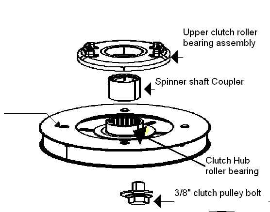

Did your Clutch Pulley use the Upper Bearing ring?

Sounds like your series 16 machine used the upper bearing ring as part of the Clutch Pulley assembly see pic below. The old style tub design used the upper bearing ring. I thought for a while Maytag moved over to the intergrated lower tub bearing in series 13 and above machines based on other owner feed back…not so.
The 6207 DU bearings are original and yes 6207-2RS is the replacement Outer tub bearing for the rebuild for all series machines from what I have seen…series 18 machine is the highest I have seen in the production run to date.

Clutch Raw 3 with title info.jpg (22.9 KB)
Dick,
That is what my clutch assembly looks like.
Dave
