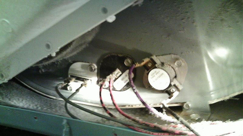

The ignitor has continuity. I’m guessing the thermal fuse is the leftmost gizmo of the three things mounted on the blower duct (see attached photo) . . . it looks like it contains a little flat thing that will pull out for replacement. If I pull one wire off, the gizmo shows continuity. What are the other two things? The rightmost one looks like a disc thermostat.
Is the control panel up at the top on the back of the dryer? Do you get to it by removing the back, or does the top lift up somehow?
Found this advice on a nearby post: "
[LEFT][COLOR=#000000]Using the multimeter check continuity of the hi - limit thermostat, cycling thermostat, ignitor, flame sensor (remove one wire off when testing). You should read less then 1 Ohm (except the ignitor)." Is the flame sensor that small box mounted to look through a hole in the sheet metal flame duct? I see another thing that looks like a disc thermostat mounted on the flame duct, too. Please explain where all the parts are for these tests. And what they look like. [/COLOR]

Hi.
The three things on the picture are thermal fuse, thermistor, cycling thermostat. At the top of the burner is hi - limit thermostat and flame sensor.You should reed <1ohm. Thermistor at room t*- 10Kohms (approx).
Refer to the link in my previous post for the diagrams and parts for pictures and locations.

OK, here’s what I’m getting –
thermal fuse – 0 ohms (continuity)
thermistor – 20,000 ohms
cycling thermostat – 0 ohms
hi-limit thermostat – 0 ohms
flame sensor – no conductivity – is that the part that’s defective? Or is that the normal situation when the dryer is not running?
At room t* the flame sensor should be closed. It’s opens at 1500*F.
If you sure in your measurements then it’s your bad part.
You can test it by installing jumper on the sensor and turn the dryer on a for few seconds.
