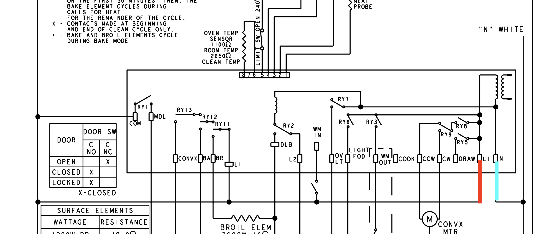

I guess all the burners on top work? Does oven light work? I am wondering if you missing neutral as the board you replace needs that.Have you check the power from L1 to neutral and you should get 120 volts at the plug at the back of the range?

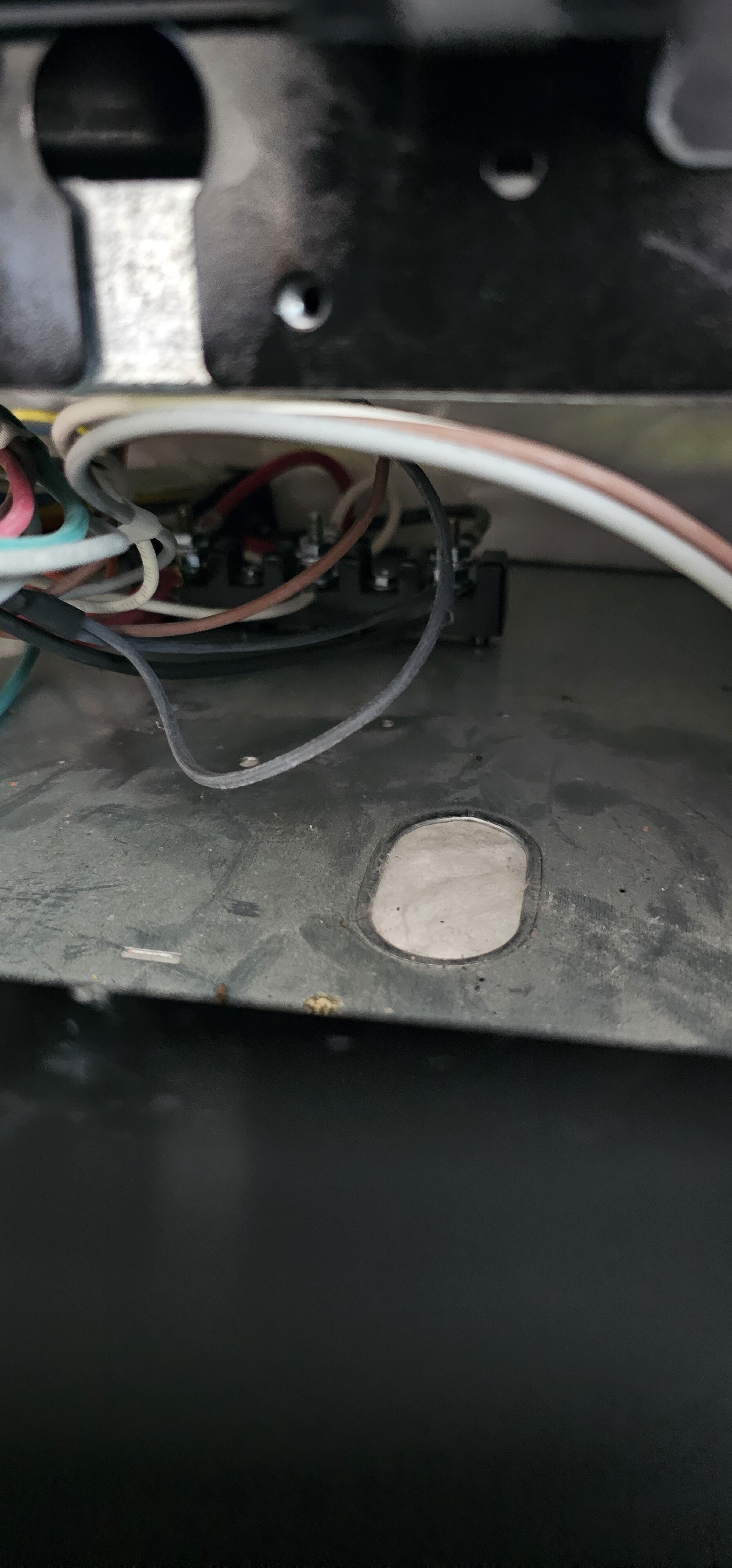

Well, one thing about the power is there’s 3 wires coming out of the wall and there’s 4 wires on the back of the oven. I don’t know if that could affect anything. The 2 hots are wired to the 2 hots and the ground and the neutral on the oven are going to the other wire coming out of the wall.
All the burners work Yes, I have to check the oven light tomorrow. And what’s the L1 ?I’m novice With this stuff.
Here is a video!https://www.youtube.com/watch?v=PEI1OK-DNuA

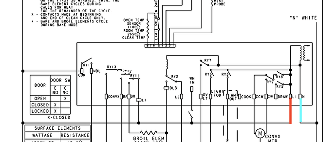

On the board you put in you should have 120 volts between L1 and N just like in this screen shot of your wiring diagram.Start with the video first and make sure you have the proper voltage there!
Okay, I’ll give it a shot tomorrow.Get back to you
So I have 120v on L1 and on N. This is the block on mine, not like in the video on the back.It’s on the inside, it’s basically hardwired up into the inside
