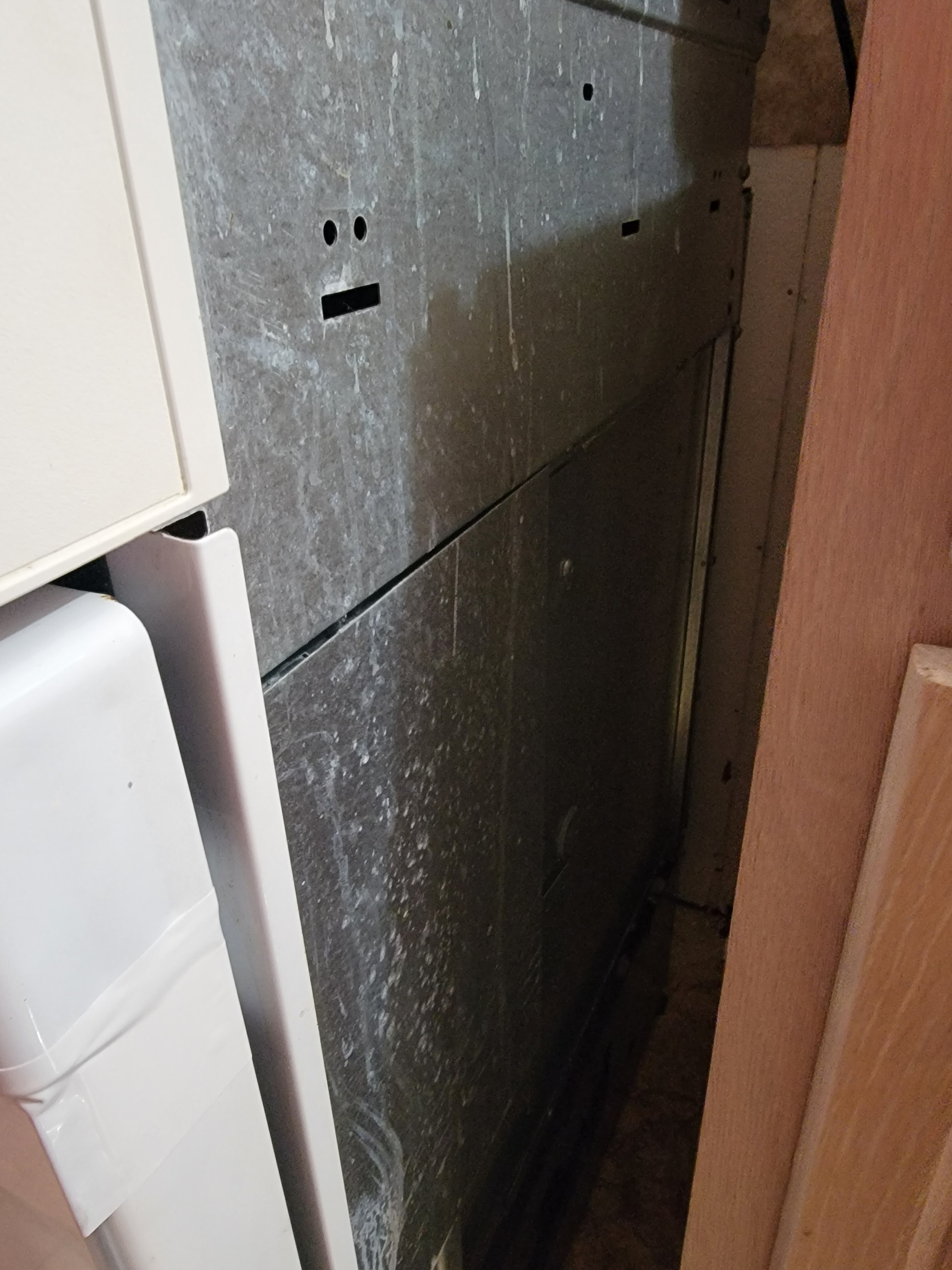

Frigidaire
Model FES367ASG
SIDE PANELS
can i install my stove listed above without the side panels without damaging my cabinets?
We would only be able to suggest what is identified in the installation guide.
