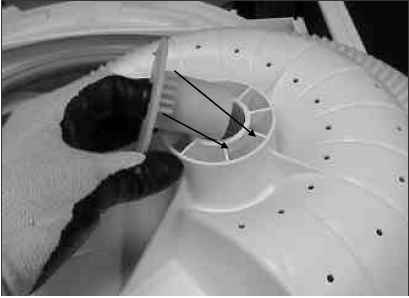

“”and is there supposed to be 2 Jounals, one on the back of each Tumbler?”” If you mean this see pick below Journal Lock
We are talking about these parts [COLOR=#0000ff]AP4009556[/COLOR] it looks like someone tried to pull the tumbler before.

Journal Lock.jpg (7.8 KB)
[LEFT][COLOR=#000000]Link did not come thru go to FAV6800AWW parts break down and view this [/COLOR][COLOR=#000000][COLOR=#0000ff]AP4009556[/COLOR][/COLOR][/LEFT]
[COLOR=#000000]Or click on this URL[/COLOR]
[COLOR=#000000]Part Details - WHIRLPOOL Lifter flange bearin, part number: AP4009556[/COLOR]

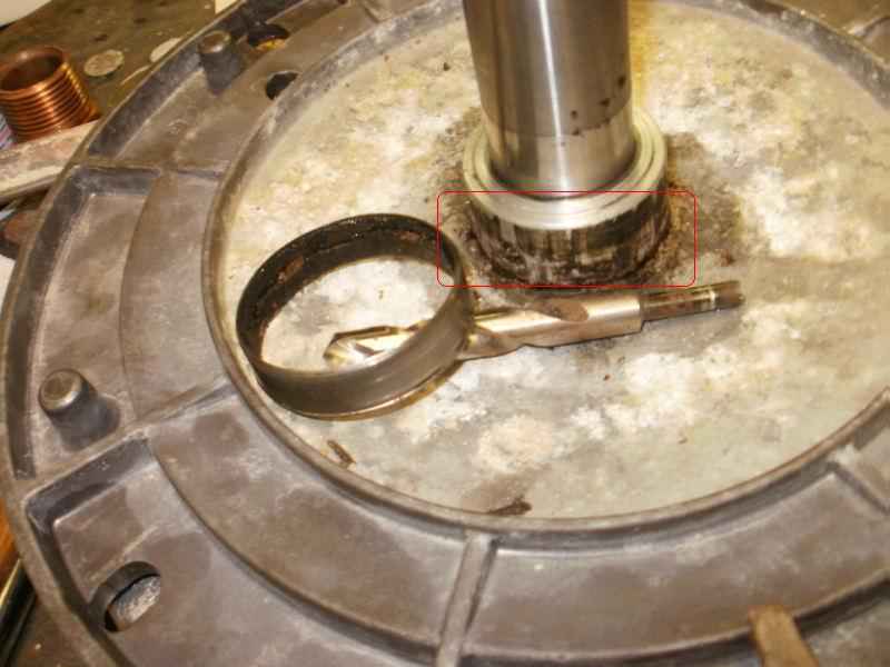

I’m cleaning up the Spinner Support Assembly, and that part bothers me. I think there is supposed to be a watertight seal formed between the Tub Seal and the inner radius of the portion of this assembly that holds the shaft. It appears to be a cast aluminum pat, and there are some nicks and aluminum oxide flowering in this area. I am going to try to smooth and polish it, trying not to cross that sealing surface with any scratches.

“”I’m cleaning up the Spinner Support Assembly, and that part bothers me. I think there is supposed to be a watertight seal formed between the Tub Seal and the inner radius of the portion of this assembly that holds the shaft. It appears to be a cast aluminum pat, and there are some nicks and aluminum oxide flowering in this area. I am going to try to smooth and polish it, trying not to cross that sealing surface with any scratches.””
Andy the scoring/pitting you are describing is that the area I have highlighted in red on the Spinner Support that slips into the Tub Seal?
Do you have a Pic?
Spinner Support Tub Seal location.JPG (33.8 KB)
Hi Bill,
Yeah, you’re picture shows the spot. I can’t see how that tub seal makes a good watertight seal there. The spinner basket rotates, so the Spinner Support must rotate inside the tub seal sleeve, right? (I did remove the old sleeve). The upper bearing inside the Spinner Support assembly on my washer had a lot of rusty buildup caked against it. I think I can clean up those bearings but I want to make a better seal.

"“The spinner basket rotates, so the Spinner Support must rotate inside the tub seal sleeve”
The metal sleeve seemed to be a tight friction fit on the Spinner Support and I think that it and the Spinner Support spin inside the seal.
[COLOR=#333333][FONT=Calibri][SIZE=3]I never gave it very much thought except the Tub Seal system seemed very lean in design for such an important function. [/SIZE][/FONT][/COLOR]
Dick
From what I can see the tub seal sleeve fits tight against the shaft and spins inside the rubber part of the seal. I think the reason it failed is because it got hard over time. It seems like a poor design but mine lasted over 6 years so maybe that’d be ok if they made it easier to fix and not tell you to junk it and buy a new washer. I dont have the new seal yet so I’m guessing you want to make the shaft as smooth as possible and I would think using vaseline on all rubber seals would be good. That’s how you do it on pools and spas. I think they should have a different drive system without making spinning part go through water. Just think how long it would last. Oh yeah they wouldn’t like that much would they? Lol. As far a packing the area between the bearings with grease I dont see any benefit to it. I do think the holes in the outer tub in that area are vents to reduce heat in there. Just my 2 cents.
