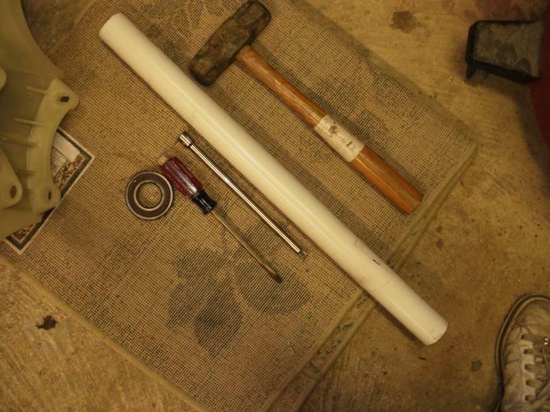

My bearing extraction tools are plain vanilla as you will see in the 3rd pic.
I flipped the Outer Tub upside down on a piece of carpet and with a large screwdriver/socket extension I started to pound out the upper bearing first. A 3/8” dia piece of drill rod would probably work better.
You will see a floating spacer between the original 6207-DU bearings 4th and 5th pics. You need to work around the inside of the spacer as you pound out that first bearing.
Once I got that first bearing out I laid the outer tub on its side and took a piece 1” PVC about 3’ long (that’s all I had on hand) and my 2.5lb hammer and with careful strikes punched out the bottom 6207-DU bearing. A helper would be handy to have during this process to help control tub movement.
Take care thru the process with the hammer strikes that you don’t have a hammer blow glance and strike the tub. Take care with the molded in Drive Motor bracket that you cause no damage to it when working on this project.

Bearing extraction tools.JPG (93.5 KB)
