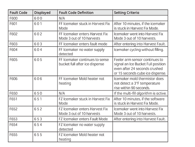

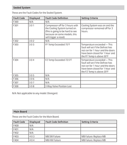

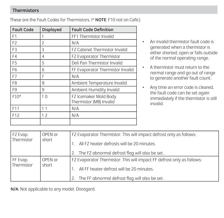

I also ran a test for error codes and this is what it showed:
l
Is this worth fixing or what do I need to try?

I’d start by checking those items, and also refer to the tech sheet to identify the error codes you’re seeing. The codes can help narrow down the cause of the problem and point us in the right direction.

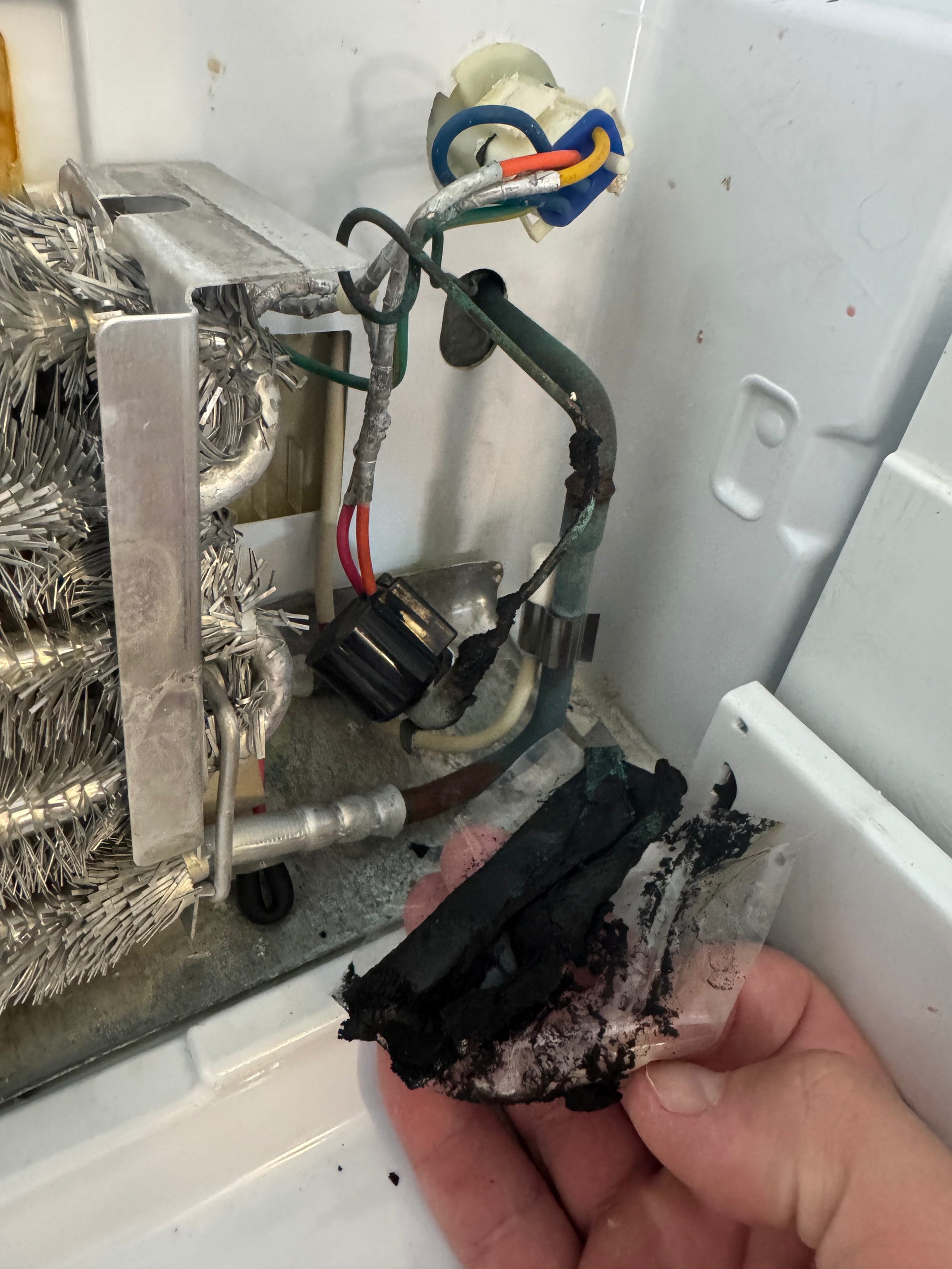

here is a photo I took a couple weeks ago. This came off and didn’t look normal to me

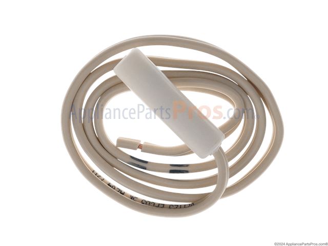

Yes, that’s definitely a major contributing factor and could very well be the cause of your problem. That component looks burnt, and the thermistor also appears to be in poor condition.
I would definitely start by replacing and testing those parts. Also, inspect the wiring and surrounding components to determine why they burned in the first place, as there may be an underlying issue—such as a short, loose connection, or another failing component—that caused the damage. Identifying the root cause will help prevent the new parts from failing again.
Gotcha! Do you all have those parts that I need that I can buy?
i would check to see what all is bad with a tester test those wires and the heater before buying parts
How do I do that with a tester? What is the component that looks burnt?
Do you think I should try these 2 parts? Anything else I should try?
