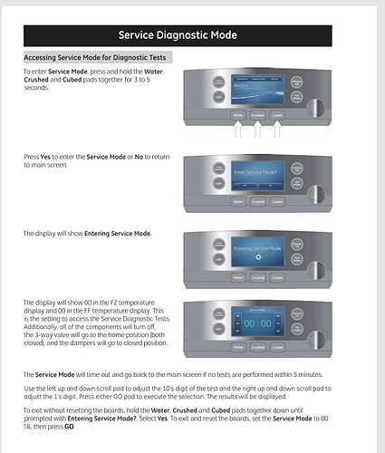

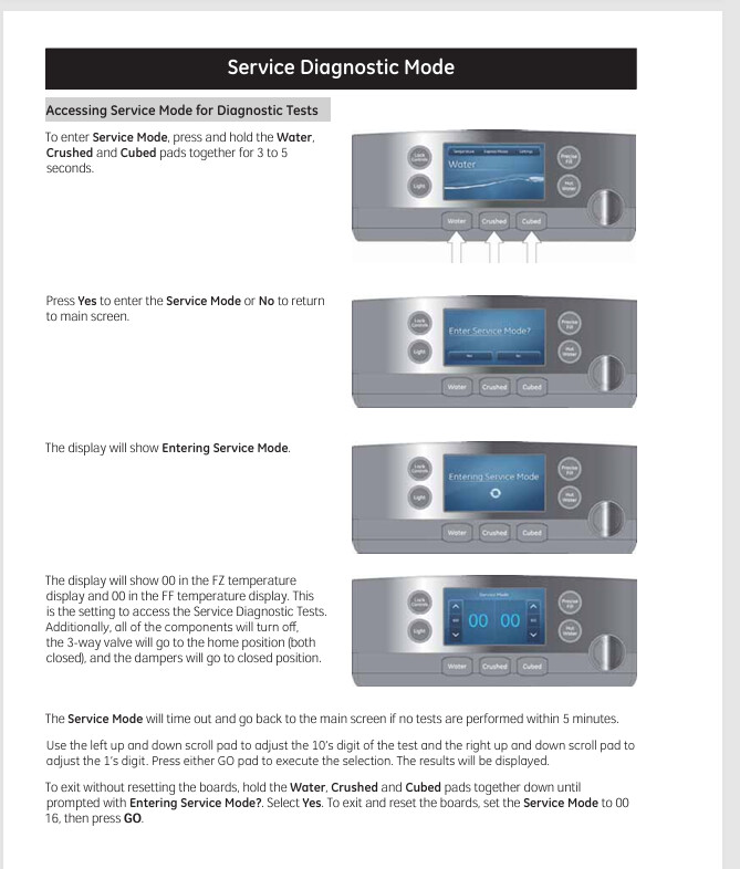

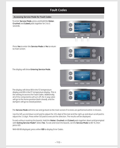

Yes, go ahead and plug it back in. The next step is to put the appliance into Diagnostic Mode. I’ll send you the instructions and walk you through it step by step as you go
Ok thank you. Was there supposed to be something attached?
no i will send now was just waiting for your response
follow the next page
You can download the whole manual here[:] (https://visualizador.serviplus.com.mx/datos_pt/refr/manuales/ServiceManual_31-9250.pdf)
I tested the fan itself in OHMS and the red black and yellow wires showed good connection. I plugged it in and wedged the black in beside the black wire and red in beside the red wire and did not get anything on DC connection.
What was I supposed to do in the diagnostic mode? I have already ran a lot of tests and posted those pictures above
