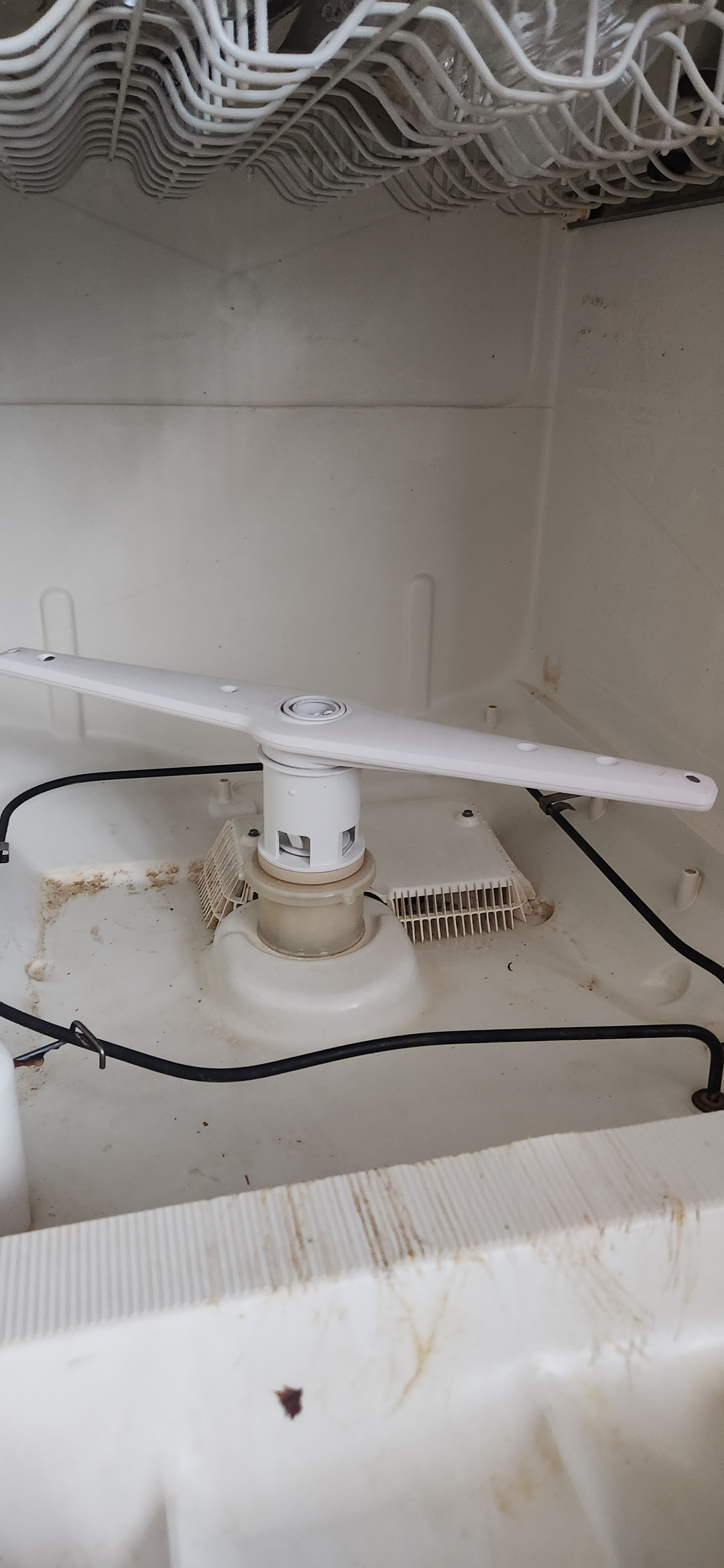

Broken spray arm tower
Brand: GE
Model Number: GSD900X-03BA

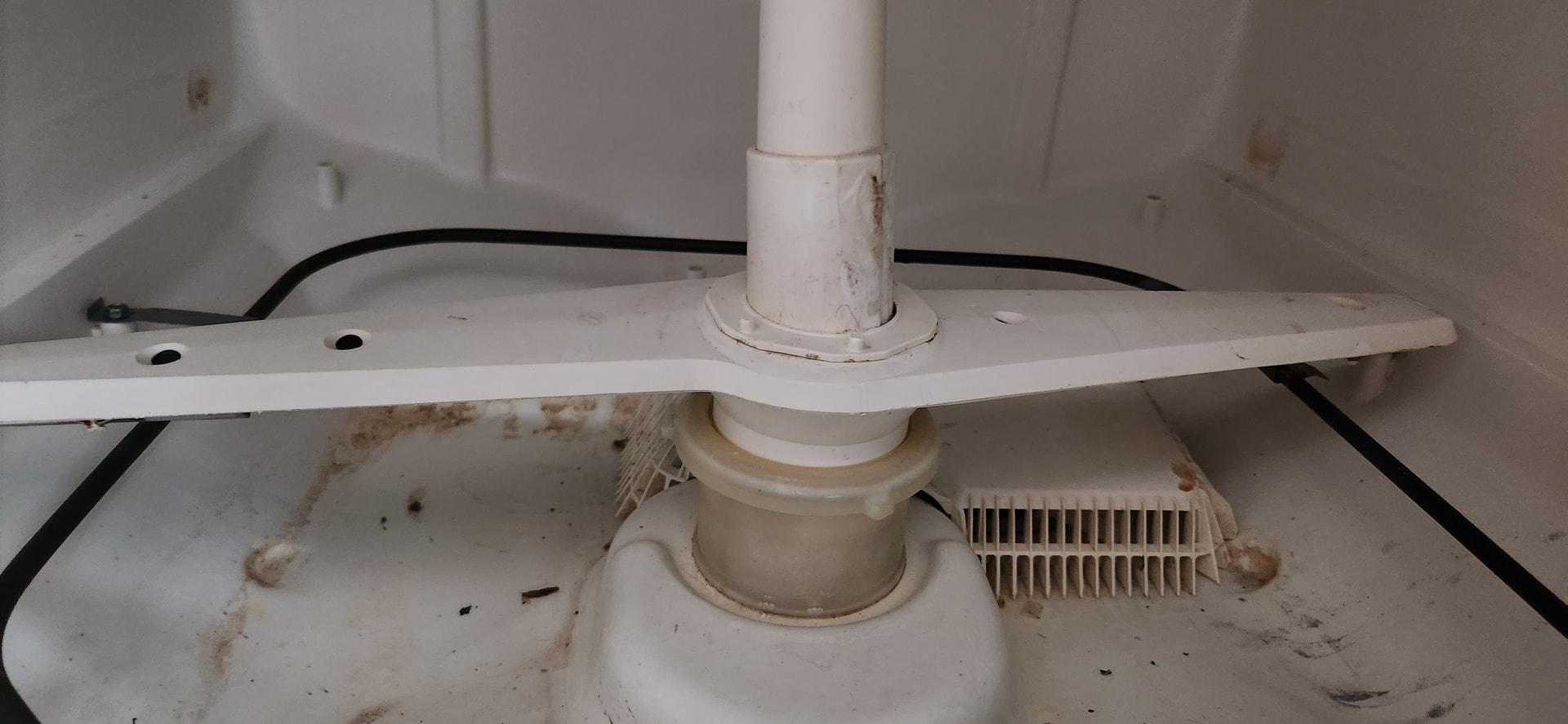

Main Symptom: broken spray arm tower. Dishes not getting clean
What happens & when: dishes are not clean. Always. Lower spray arm tower is broken. The replacement part is got does not fit. Maybe I need an adaptor. Or a different part. The replacement spray arm cannot attach to pump housing. The old spray arm attaches with a screw in the center. The new spray arm has threads on the base.
Parts or tests already tried: WD22X154 - does not fit.
Photos / video link: photos show current set-up with old broken part.

Ok, I was looking at getting this one instead. Is the small cylinder piece like an adaptor to fit into the base of the spray arm system i currently have?
Yes, ;that would be correct.

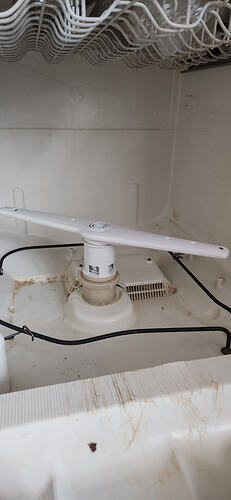

I bought the part but now I cannot put the lower rack in as the spray arm is to tall.

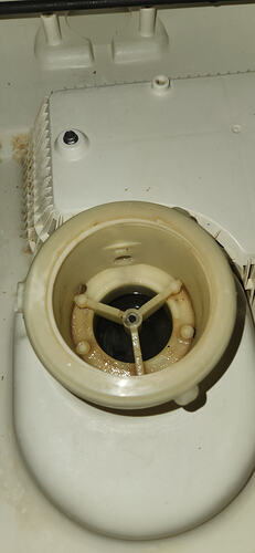

This is what it looks like inside the base of the existing piece. I dont see a way to remove it, i tried twisting it but it doesnt budge. I dont want to break it.

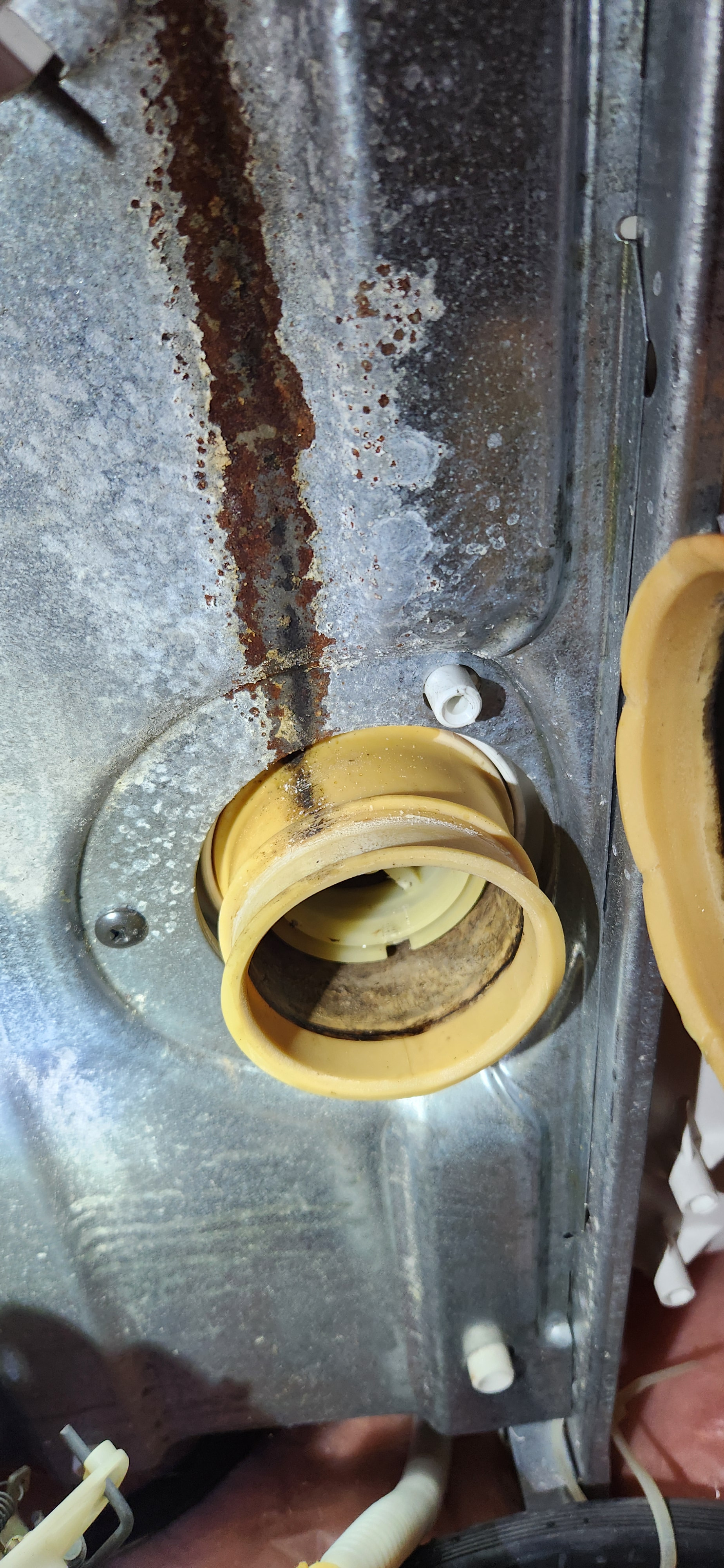

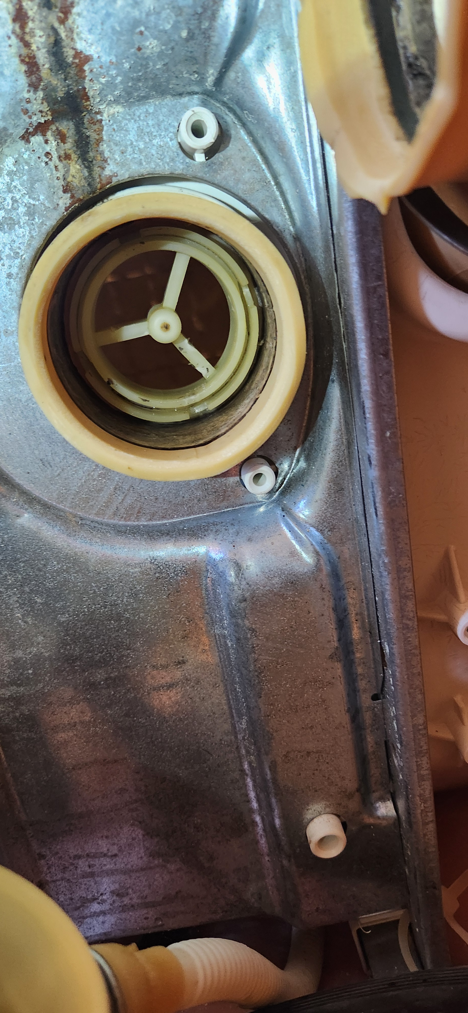

It actually looks like the lower piece that is the darker part is sticking up too high. See if there is a way that it will slide down in there further.
That is a hard plastic tube that sticks out cannot be pushed in further. It is the reason I have been told I need to replace the part. I believe I need to take that entire piece out. But I can not figure out how to remove it. This is how it looks from the bottom

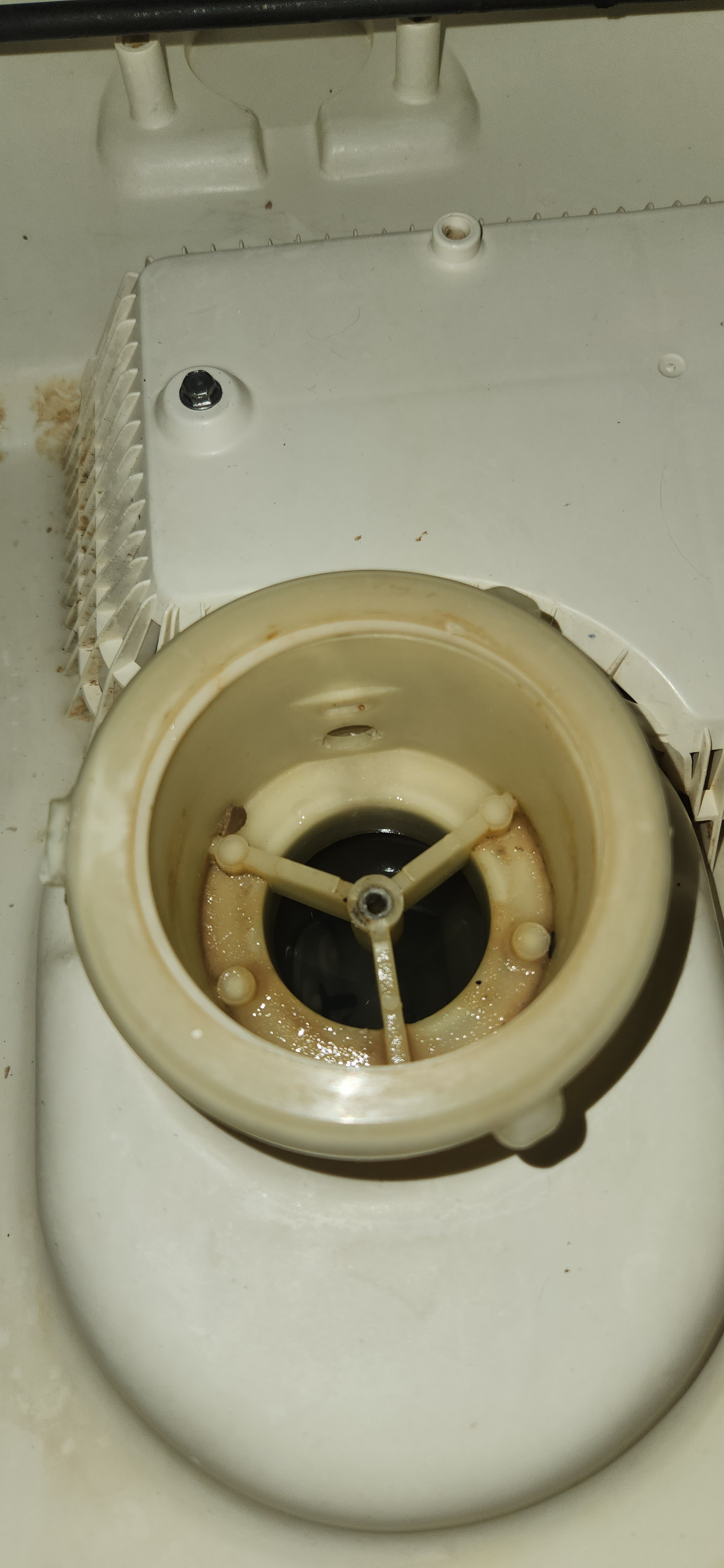

Here is the inside of the hard plastic cylinder.

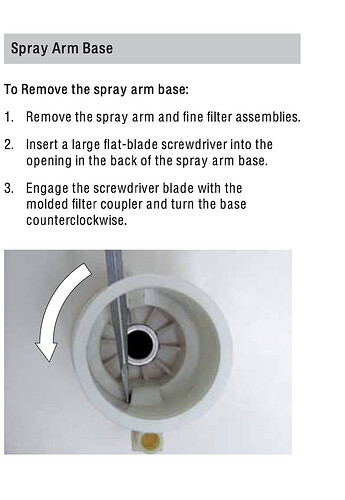

Maybe follow the instruction in this manual.
31-3010 GE GSD900X-03BA Dishwasher Mini Manual.pdf (877.0 KB)
Try something like in this picture!
