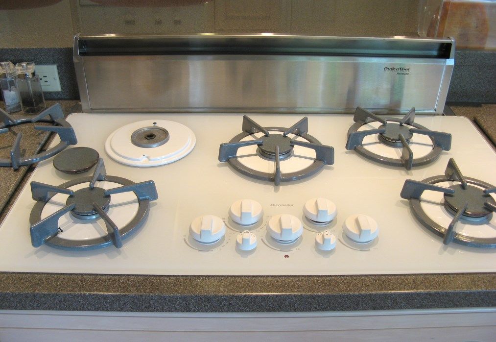

Problem: On my Thermador white glass top GGSCV365W cooktop, the rear XLO burner turns on and I can adjust the flame just like I always have. However, after about two minutes, the flame goes out, and the igniter continuously sparks. All other burners are unaffected and operate normally.
Here is a picture of the cooktop:
Question #1: Is this problem likely caused by a defective solenoid, or is something else more likely the cause?

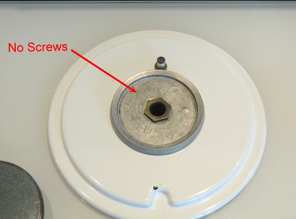

Question #2: How to I remove this cooktop for service? Other posts in this forum describe removing the screws under the burner cap, but my cooktop does not have those screws (see picture below). Instead, it only has a brass nut in the center. Here is what that looks like:
Thanks in advance for any help you can provide.
John
OK, I found posts elsewhere which describe how to disassemble the cooktop. However, I haven’t yet gotten any guidance on which part is the likely cause of the problem.
It sure seems to me like the problem must be something that is very near the burner and is therefore being affected by heat. I say this because the burner operates perfectly normally at first: it starts normally; I can adjust the flame up and down with no problem; and the sparking from the ignitor stops as soon as the flame catches. But, about 1-2 minutes after the burner is running, the flame goes out and the ignitor starts sparking repeatedly.
Therefore, it seems to me that heat from the burner must be causing a disruption in the flame-sensing mechanism.
This has to be happening somewhere near the burner, because the problem happens even when this is the only burner in use. It never happens until the burner has gotten good and hot, and it seems to happen more quickly when there is a large pot or pan covering the burner than when a small pan is used.

[edit]I thought I solved the problem, but it returned. I am now going to replace the ignitor. The following is what I did. This initially seemed to fix the problem, but it later returned. I assume that the ignitor assembly also is responsible for sensing whether there is still a flame.
I turned off the gas and electricity. I then took off the burner plate. This is done by unscrewing the brass nut (burner orifice) in the center of the burner plate. Before I took off the nut, I marked its original location with a pencil mark so that when I reassembled it, I would get roughly the same degree of tightness.
Once opened, it became quite clear that the only two things that could cause the problem would be a faulty ignitor, or a bad connection to the ignitor (it is connected with a standard spade lug crimp connector). I say this because there simply isn’t anything else anywhere nearby that could possibly be affected by the heat.
Since I hadn’t purchased any parts, I pulled off the crimp connector and, while I was at it, I took out the ignitor. I cleaned the ignitor carefully, and blew it out with 90 psi compressed air. I then cleaned the ignitor contacts with a wire brush, and also scraped the inside of the crimp connector. Then, very carefully, with a small thin-nosed pliers, I bent the crimp connectors slightly in order to create a tighter connection. I then reconnected the spade lug to the ignitor and reassembled everything.
