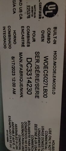

Model Number:woec5027lb00

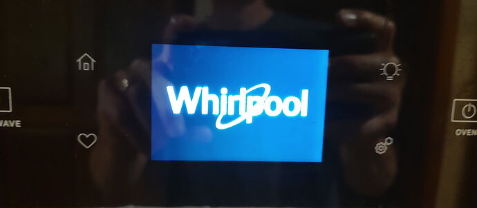

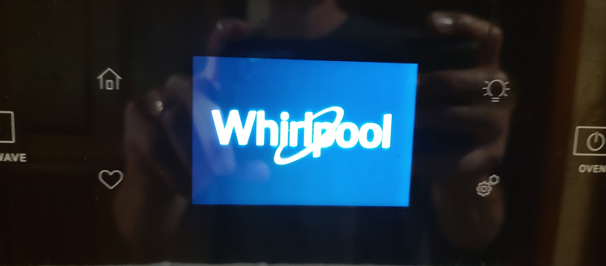

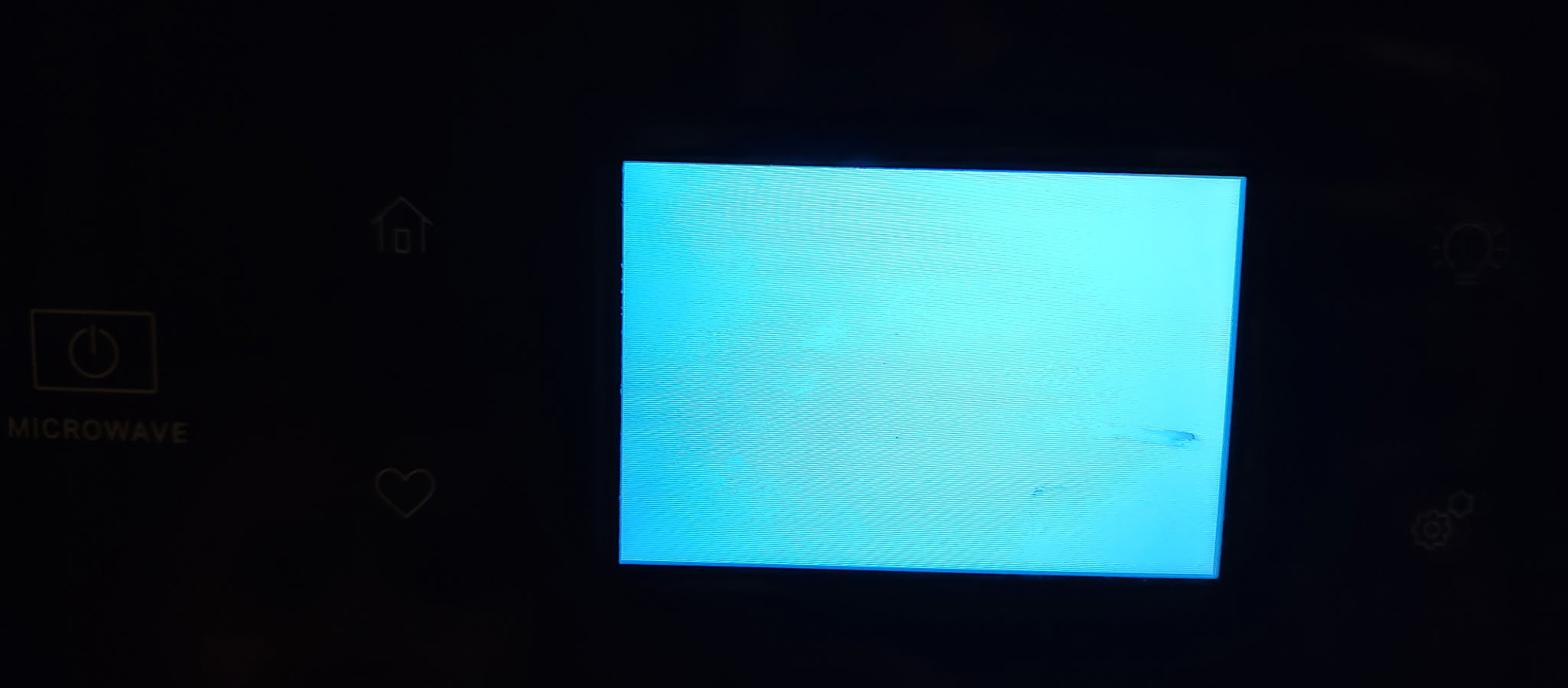

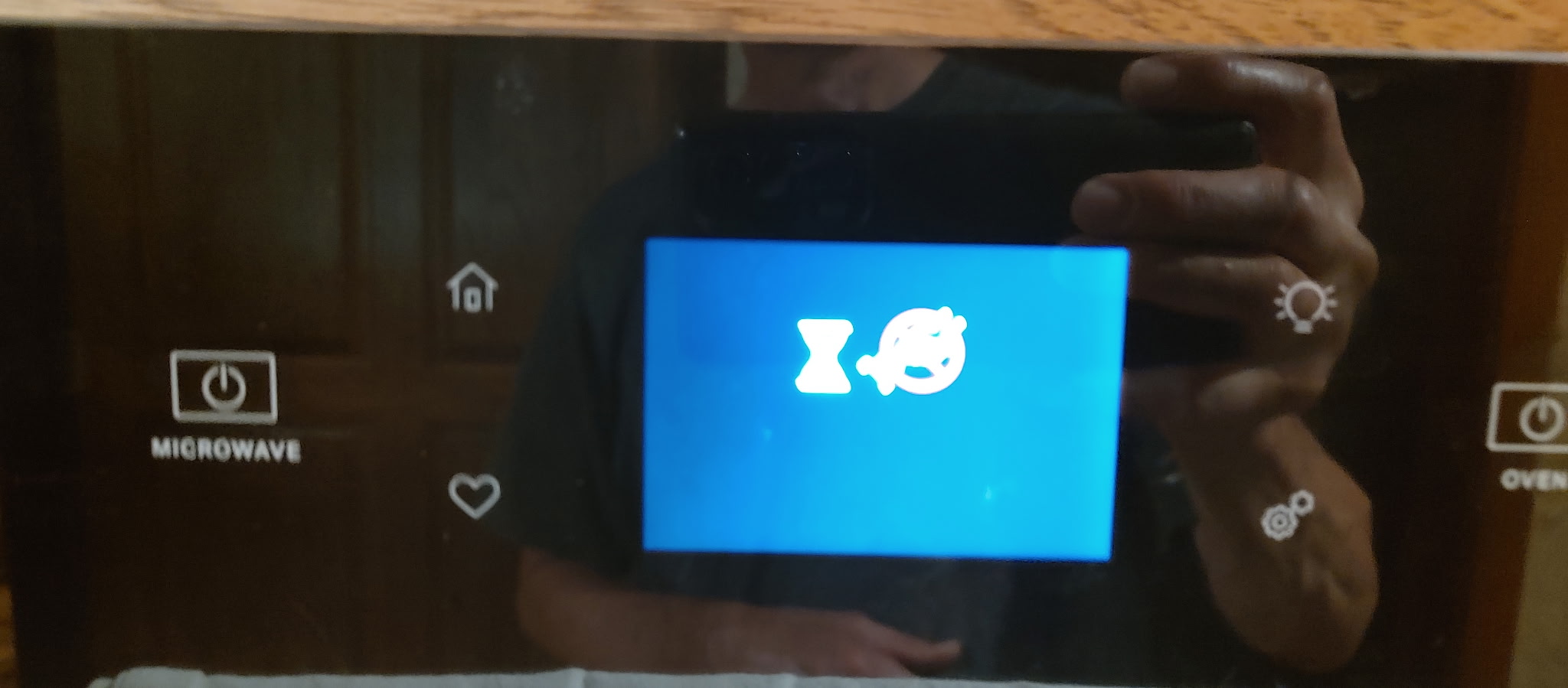

Main Symptom: cycles thru boot screen, whirlpool logo, blank screen, hour glass, then back thru again
Parts or tests already tried: replaced Wall Oven Electronic Control Board W11325603 (AP6872123) per the AI assistance on your site. Same cycle. Have powered off at breaker and back on multiple times, same result. Buttons don’t work. Problem occurred after home lost power in storm and when power restored, the problem started. This is my daughter’s oven unit and I’m trying to help her save money in the repair by helping her with this.

These are the three screens that rotate and continue cycling through after we restore power. Also provided the model number and serial number plate. The display screen is not black it does display these three screens.
Hi pshkdavis, it’s more than likely that the main control panel (HMI-Central/UI board assembly) is the culprit here. I read that you already replaced the control board, but that board mainly controls the oven functions like bake, broil, convection, and the related circuits. The issue you’re having appears to be with the main control panel/UI.
Here are some steps you can try, but if the screen will not allow you to move past that loop, the control panel may need to be replaced:
  1. Unplug the oven or disconnect power.
  2. Confirm that the HMI-Central/UI board Control Panel Assembly is properly grounded to the oven chassis. If it is not, repair the ground connection.
  3. Reassemble all parts and panels before operating the oven.
  4. Restore power and cycle the power to the oven.
  5. If the problem or error persists, disconnect power again.
  6. Replace the HMI-Central/UI board Control Panel Assembly.
  7. Reassemble all parts and panels before operating.
  8. Restore power and follow the on-screen prompts for model selection.
  9. Verify that the oven is operating normally.
Afterward, enter Diagnostics Mode, select Error Diagnostics, and clear the error history. If you replaced the HMI-Central/UI board Control Panel Assembly, there is no need to clear the previous error history.control panel W11468019
