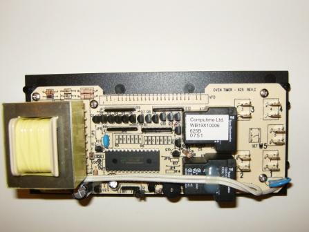

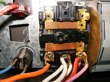

I’m replacing the old mechanical timer in my single GE wall oven with the WB19X10006 digital timer. I was concerned that the old timer has connections to only 3 of the 5 terminals: L1, Output 1, and neutral. L2 and Output 2 have no connections. Based on your post, I’m wondering if L2 and Output 2 are for the second oven.
Gene: any thoughts?
Thanks,
Tom
Hi Tom,
If you can post pictures of the old and new clocks and all available diagrams and instructions, it might help for more accurate advise.
Yes, please post pics, especially the instructions. I have replaced a number of these clocks, and when I had problems, it was a simple wire misplacement.
Here are the pictures:
The current mechanical timer, the new digital timer, and the instructions.
I believe the current connection has the pink and red wires on terminal 1(L1), the white wires on terminal 5 (N), and the orange wire on terminal 2 (Output 1). According to the instructions, these would connect on the new timer to terminals 1, 5, and 2 (respectively).
My assuption is that L2 and Output 2 would be used for the second oven, if I had one.
Does that make sense?
Thanks for your help.
Tom
Hi Tom,
You were absolutely right.
Thanks for the consult Gene! The new timer works fine.
It will be very nice to have the self-clean function back.
Tom
