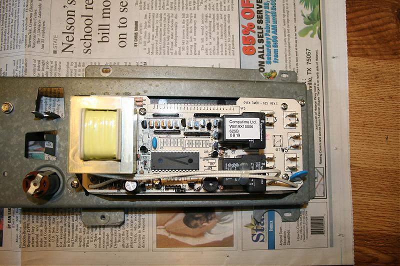

But— on the clock ordering page, there was a note about potential problems with alignment to the holes in the glass, and that’s exactly what I’m seeing. I’ve attached a photo of the new clock mounted behind the glass.
The alignment isn’t close enough for this to work, and there’s no adjustment room to move the new clock side to side. Any ideas?
Thanks, Keith

Try to play with this bracket. Might be drill a new holes?
Gene, I’ll see what I can do with adjustments today. Maybe see if the metal tabs that came with the new clock can be used together with the old bracket.
I wonder if there is a replacement bracket to go along with the new clock?
I’m attaching front and rear views of the new clock in the old bracket. Note in the rear view, the mounting screws are in the upper right and lower left.
Keith,
It looks to me that you have to remove the new clock from the bracket and cut the opening in the bracket on the right side, so you will be able to move the clock to the right.

I’m reposting the picture of the back of the clock timer, and I’ve circled in red the only jumper I saw. There are three “posts” and the jumper is over the two on the right. The word “CLEAN” is just to the right of the jumpers.
Just to finish the series of messages I’d posted on this thread, I never could get to a solution to make the clock/timer fit properly, so I returned it for a refund.
