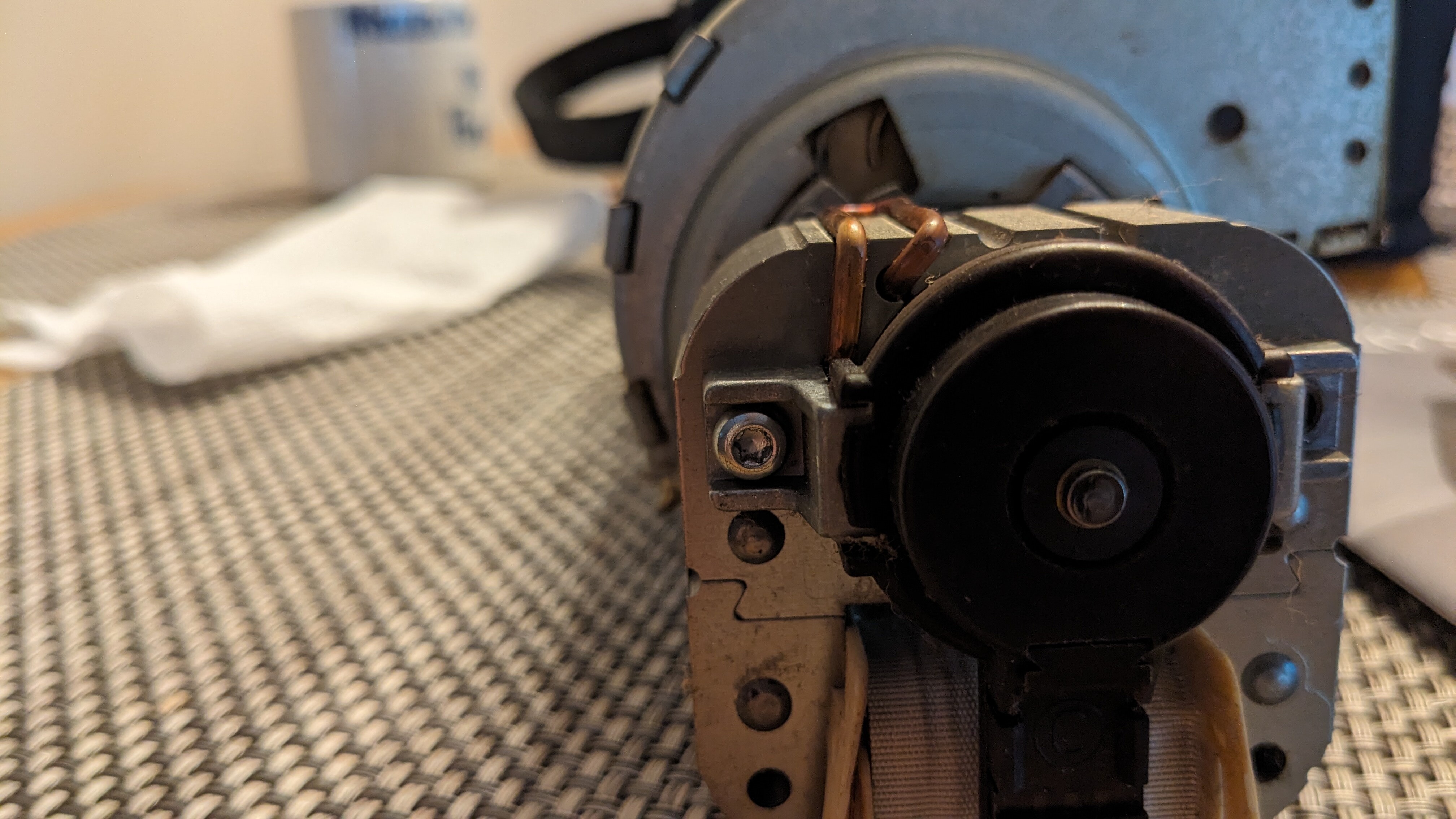

Changed out fan with Hall effect sensor, 00440604. N/C.
