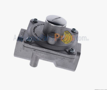

Stove top conversion from natural to propane gas
Brand: whirlpool gas cooktop
Model Number: wcg51us0db00
Main Symptom: unsure about configuring the regulator
What happens & when: doesn’t match regulator in video instructions
Error Code (if any): none
Parts or tests already tried: none
Take the cap off and unscrew the plastic plunger, flip it over, tighten it down and put the cap back on.
The videos have shown a ‘bolt’ like cap. This one is screw driver untightened. Just wanted to make sure.
That is why I gave you a description of how to do it. Yours is a little different; the concept is the same.

BigBuck1. Thanks!! Nothing like printed instructions with visuals!! This does it for me.
