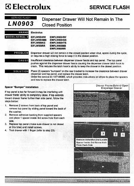

Contact Electrolux. They have had a number of complaints about this problem. They should offer to send you a repair bulletin along with the required parts (which is another latch and a couple soft plastic spacers.)
The latch is breaking due to the top being misaligned and pushed too far forward thereby stressing the latch. You will have to remove the top cover of the washer, stick the self adhesive spacers along the back edge of the washer frame, then replace the cover, and replace the latch.
I was a little confused about the directions at first. But when it states to place the spacers “inside the screw holes” they mean to the left and right of the exsisting holes on the washer frame. Not inside the hole like you’re going to screw back into the spacer.
It’s a very simple repair. Just a matter of removing a couple screws.

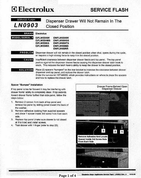

It’s service bulletin LN0903. I would think a parts dealer should be able to get you a copy. If not, I still have it and can email you a copy.
[FONT=Arial][SIZE=3]Samsmith, a big success! :slight_smile: Many, many thanks! With my model# and the LN# you gave, Sears Parts & Service found the bulletin easily and printed me a copy. Installing the spacers was simple, just as you had written in your first post. I probably could have gotten by without the bulletin; but having it, gave me assurance that I was doing it correctly. By the way, this forum & thread was t[/SIZE][/FONT][FONT=Arial][SIZE=3]he only reference to the problem that I could find anywhere.[/SIZE][/FONT]
[FONT=Arial][SIZE=3]In case anyone else needs it, the Electrolux bulletin is called “SERVICE FLASH LN0903, Dispenser Drawer Will Not Remain In The Closed Position”. It applies to these 7 Electrolux (front-load) washers: EIFLW55HIW, EIFLW55HMB, EIFLW55IKG, EIFLW55IRR, EWFLW65HIW, EWFLW65HSS, EWFLW65HTS, EWFLW65IMB, and EWFLW65IRR. For parts, ask Electrolux to send you a “Latch Kit”, part# 137146000.[/SIZE][/FONT]
I have the same problem. The latch was easy to replace but there is no instructions on what to do with the spacers. Could someone email me them please? My email is [email removed]. Thanks.
jbkulp, I’ve attached the first page of Service Flash LN0903. It tells how to remove the top panel, where to place the spacers, etc.. (The other 3 pages tell only how to install the latch itself.)

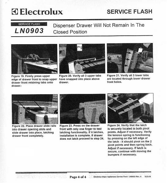

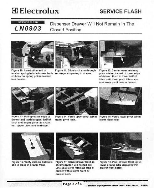

Electrolux is sending the parts (including a new latch). Would it be possible to also get the first 3 pages that tell how to replace the latch?
Many thanks!
[quote=petruncola;355242]Electrolux is sending the parts (including a new latch). Would it be possible to also get the first 3 pages that tell how to replace the latch?
Many thanks![/quote]
petruncola,
I’ve attached all 4 pages. (If this copy too fuzzy, let me know and I’ll try one with a higher resolution.) Good luck with the repair
Robby

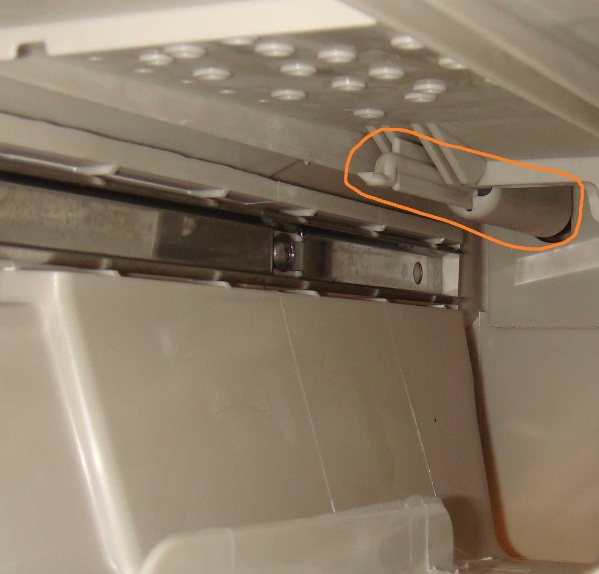

[COLOR=#000000][FONT=Times New Roman][FONT=MS Reference Sans Serif][COLOR=#000080]Have an Electrolux EWFLW65HIW washer. When the unit was moved the soap dispenser was damaged. Before it was damaged, if the “button” was pressed, the drawer popped open. Today, the service technician replaced the whole drawer unit (said the whole thing had to be replaced) but the drawer still doesn’t pop open. We have to manually pull it open. He couldn’t find any spring on the schematic and doesn’t know how to fix it further. What are we missing? Thanks.[/COLOR][/FONT]
[/FONT][/COLOR]
[quote=bwrby;561103][COLOR=#000000][FONT=Times New Roman][FONT=MS Reference Sans Serif][COLOR=#000080]Have an Electrolux EWFLW65HIW washer. When the unit was moved the soap dispenser was damaged. Before it was damaged, if the “button” was pressed, the drawer popped open. Today, the service technician replaced the whole drawer unit (said the whole thing had to be replaced) but the drawer still doesn’t pop open. We have to manually pull it open. He couldn’t find any spring on the schematic and doesn’t know how to fix it further. What are we missing? Thanks.[/COLOR][/FONT][/FONT][/COLOR]
[/quote]
[FONT=Arial]As you close the drawer, a small flange on the drawer pushes against a spring-loaded plunger that’s part of the housing, not the drawer. I’ve circled the flange and the plunger on the attached photos.[/FONT]
[FONT=Arial]I don’t know if the plunger is available as a separate part; but a replacement for the complete housing is available from a number of parts dealers, at prices ranging from $82 to $94 (plus shipping). Find it, by searching for part number 137108710 or 137108700.[/FONT]
[FONT=Arial]Incidentally, my washer is the same model as yours ([model]EWFLW65HIW[/model]).[/FONT]

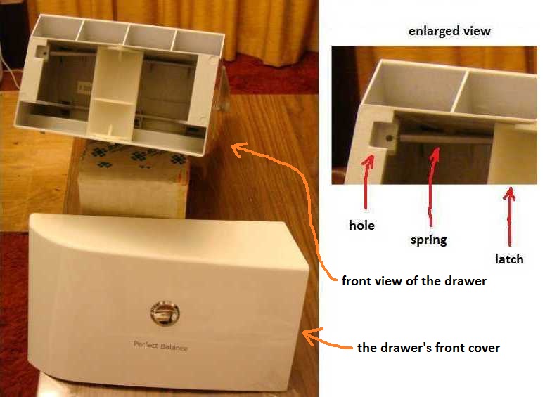

In figure 9 of the Service Flash, it says to attach the spring to the hole in the drawer - which one? The picture is too fuzzy, and I can’t figure it out.
[FONT=Arial][SIZE=3]I see what you mean about the picture being too fuzzy. I’ve attached a snapshot of my drawer (with its front cover removed. It shows the hole and spring more clearly; but let me know if you need any additional photos. Good luck with the repair.[/SIZE][/FONT]
That was perfect, thank you so much. Washer is now repaired, and I can throw out the masking tape!
