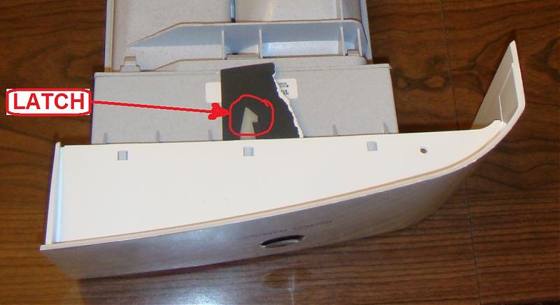

The plastic piece you spoke of did break and the drawer does not close, but does the latch kit fix a broken drawer or keep a new one from breaking? I don’t want to buy a $100 drawer if I can just buy the $10 latch kit!
Probably only the latch itself is broken, and the latch kit will include a new one. The attached photo shows the bottom of my drawer. On it, I circled the the tip of the latch, which on my machine, had broken off. Nothing else was damaged. Installing the spacers (included in the kit) eliminates stress on the latch, and should therefore prevent the new latch from breaking.
My warranty for labor had expired; but Electrolux sent me the repair kit for free. Ask for part number 137146000.
DSC01049 - Copy.jpg (36.4 KB)
