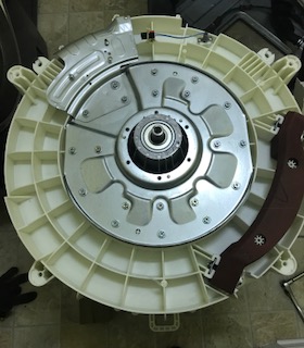

I’m following the on line video. I have removed the tub, and have removed the screws on the outer casing and removed one half of the outer tub.
However, my inner tub does not come out. It appears that I have screws on the back side that need removed. The video did not cover that situation. I have attached a picture.
Thank you for the assistance
Brian
Did you remove the bolt and rotor from the back of the drive shaft?
After separating the outer tub you should be able to remove the inner tub but you have to have removed the bolt that holds the rotor on and pulled the rotor off as well. The rotor may be hard to remove as it is being held by the magnets to the stator. Wiggle it completely off. when it is removed you will see the splined end of the drive shaft. If you take a heavy hammer or small sledge hammer tap the end of the shaft driving loose and pull out the inner basket.
BTW no picture came through.
Thanks… I did remove the stator and magnets.
I did everything per the video unless I missed a step. I still have an extra weight and another plate on the bottom side of the tub around the shaft. Close to 20 nuts holding the plate on
Picture Reattached
Thank you
No your good. Just take a good sized hammer or a small sledge maul, while holding the outer tub hit the drive shaft with a good swift hit. This will dislodge the drive shaft from the bearings and the inner tub will slide right out.
Your outer bearing looks to be in great shape BTW…
