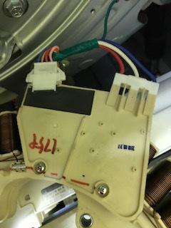

Yes that may be it. If the rotor doesn’t completely seat onto the drive shaft, it’s magnets won’t actually cover the sensor on the stator and thus the computer doesn’t recognize that it is spinning.
I will upload pics of what you should be seeing.
The rotor should be less than a finger width from the back.
Thanks for the picks. I have gotten the shaft flush and I only have a finger behind the rotor

When reassembling the stator / rotor and wiring you may have dislodged the RPM sensor. Try removing the rotor and checking the wiring and sensor position. You might see signs of where the rotor is contacting the sensor as well. Send a pic of what you find under there.
I have attached several pictures… hope they are what you are wanting to see.
As always…thank you for your time

I thought that I would bring you up to speed on the washer. The Samsung repair tech said that my circuit board was bad. He attempted to run some test cycles and the machine did not respond.
A New board has been ordered… hopefully, that will resolve my issue
