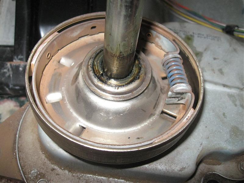

I dropped the transmission this morning and examined the clutch and basket drive per your sticky on replacing brake shoes. As expected the clutch ring was easy to turn in the housing (I could move it using just my pinkie finger) so I am probably going to need to get a new clutch. I have included a photo of the clutch assembly with this post.
The bottom of the basket drive looked fine (see photos) and the brake shoes did not seem to be sticking since the spin tube was easy to turn, using the plastic cam as a handle. I pulled the spin tube out enough to see the surface of the brake pads but I did not dissasemble it any further to examine the brake shoe rollers because I do not know where to find them at in the assembly. Do I need to examine these or can I focus my attention on the clutch repairs at this time without making any changes to the basket drive.
Also, since I am a newbie at this can you elaborate on what it means to check the brake shoe cam rollers for “excessive play” and is this possible to evaluate without taking the brake apart any further? The plastic cam had about 30 degrees of give to it (before pushing on the ‘release arms’ of the brake shoes. Is this a measure of the degree of play?

To check the cam rollers on the brake shoes, just push on them, if there is a lot of play in them, they are worn out.
[SIZE=3][COLOR=#000000][FONT=Times New Roman]I pulled out the drive block and partly disassembled the brake to see the rollers. All I had to do was to take off the C clip and the plastic cam as shown in the photos. [/FONT][/COLOR][/SIZE]
[FONT=Times New Roman][SIZE=3][COLOR=#000000] [/COLOR][/SIZE][/FONT]
[FONT=Times New Roman][SIZE=3][COLOR=#000000]One of the rollers (of the outer/primary brake show) was somewhat difficult to see but I could get a better view and could rotate both rollers by pressing in on the brake pads. Neither roller had ‘excessive play’ as best as I could assess. There was good contact between the shoes and the roller when the drive block was out but when I put I back inside the drum the brake pad were pushed back in towards eachother a bit such that the release arms of the shoes no longer contacted the rollers and the plastic c am had a bit of give (moving 30 degrees before contacting the rollers and releasing the backs) but I can’t imagine that this is a problem.[/COLOR][/SIZE][/FONT]

[SIZE=3][COLOR=#000000][FONT=Times New Roman]I have ordered a new clutch and will put it in early next week. My only remaining concern relates to the brass pin that fell out when I dropped the transmission as was mentioned in my earlier post. It is about two inches long and its shaft is flat on one side and rounded on the other with a hole at the end. It does not seem to fit in the end of the agitator spindle or the transmission. I have included a picture with this post. Any suggestions about where it belongs on the washer would be much appreciated. [/FONT][/COLOR][/SIZE]
