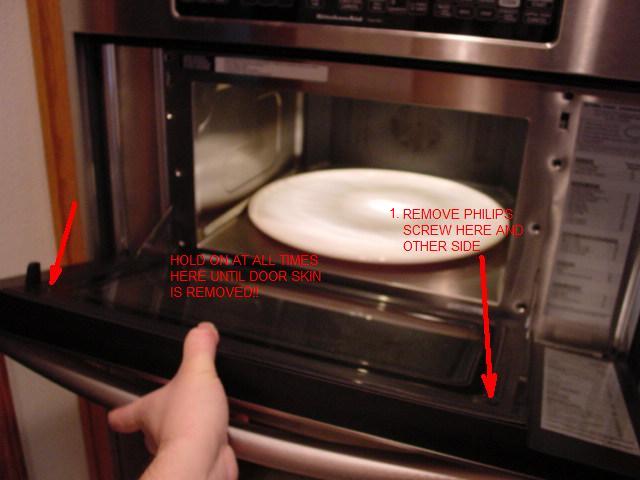

  3. Open door and hold onto the handle at all times firmly and remove two screws on the inside of the door near the top that are in recesses in the plastic door frame inner.
  4. Pull door handle outward away from the hinge ends and it will come loose from the brackets at the bottom. Put door outer somewhere safe.

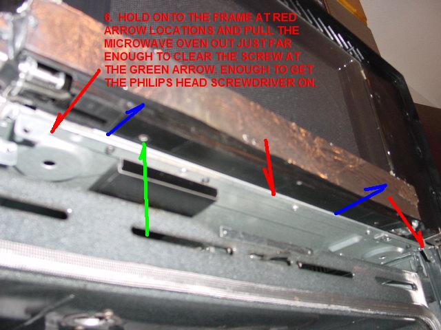

  6. remove 4 screws from the vent at the bottom of the microwave and remove the vent.
  7. Remove the two screws under vent that hold the microwave to the oven frame. They go through the brackets marked #4 on the diagram.
  8. Wiggle out the microwave just far enough to clear the screw on the bottom of the door that is blocked by the oven vent. (about 1 inch)

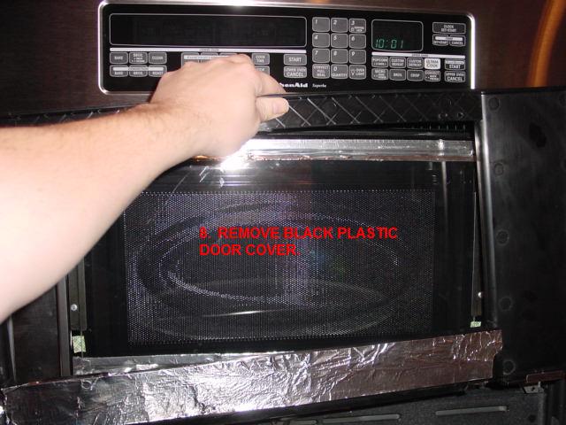

  9. Remove two screws from bottom of microwave door that hold on the plastic door frame marked #2 on the diagram.
  10. Open the door carefully.
  11. You can now remove the Plastic door frame #2
  12. Close the door again.

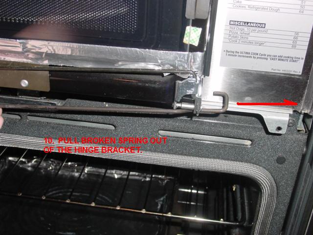

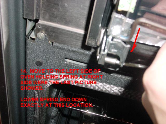

  13. The torsion springs (whats left of them) are at the bottom and criss cross attaching to the left and right Door hinge.
  14. I don’t have any pictures but the springs are identical just one has the end with most bends at the left and the other has the most bends at the right. Hopefully only one broke so you can see how it goes through the hinges. Just put the other one on exactly opposite.
  15. At the center where the springs intersect, put a baggy tie rap to hold the two springs together lightly or use aluminum speed tape. This stabilizes the springs and helps not to damage the door next time they break.

Hello. Both our spirngs broke and I am now struggling wih how the new springs go. The pdf picture doesn’t really help. Does anyone have a picture that is more definitive? Happy New Year!

When I went to remove the two screws that hold the outer panel and handle, they both went flying downward and landed on my foot. Luckily the glass did not break but a very sharp edge caught me on my leg and caused a deep cut. Ouch!:mad:

Enough on that. I was not able to slide the microwave out to clear the vent. The left side would come out about an inch but the right side wouldnot give one bit. I ended up forcing my screwdriver on the vent and bent it a bit. :o

Jorge8850 I see you didn’t read instruction 3 very well it says “Hold door handle at all times”, That was said so you dont drop the door outer (with glass) on your foot. :slight_smile:

Follow the instructions with the pictures the reverse to reassemble.

  • [FONT=Arial]The oven exhaust vent that blocks the removal of the left screw on the bottom of the plastic microwave door frame can be “unhooked” from the attachment screw located inside the vent by lifting the vent while pushing in on the vent and pulling out on the front oven frame. The attachment screw holding the vent to the frame goes through an oblong hole in the bottom of the vent. Once the vent is unhooked, it can be moved to the side to access the left screw. Wear gloves, its sharp and watch out for the electrical wires to the right of the vent. [/FONT][/LIST]

Only glitch in the process was that my microwave would not wiggle out far enough to get to the screw above the oven vent tube. Tried and tried and finally wound up hacksawing the head off the screw just inside the vent tube so that I could move the vent tube to the right just far enough to get to the screw.
