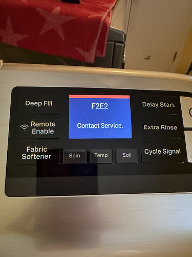

MVW7230HC1 UI F2E2 error code
Brand: Maytag
Model Number:MVW7230HC1
Main Symptom: F2E2 error
What happens & when: plug machine in, display asks to press START for English, pressing start does nothing, after a minute the code F2E2 is displayed and machine is frozen.
Error Code (if any): F2E2
Parts or tests already tried:New ACU, new UI wire harness, New UI
I’ve replaced all three: UI, ACU, wire harness. All this started with the old UI displaying F2E2 before going dark forever after unplugging and replugging power.
I’m worried the new UI is defective. Any advice?

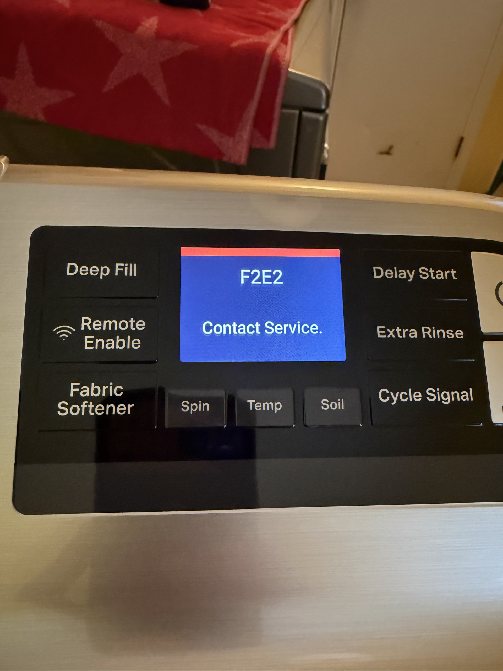

What it does now, with all three new parts:
  1. Plug in. Click (lid lock). Display comes up: press START for English.
  2. Pressing Start does nothing. Other keys do nothing.
  3. After about a minute it goes to F2E2 Contact Service and stays there.

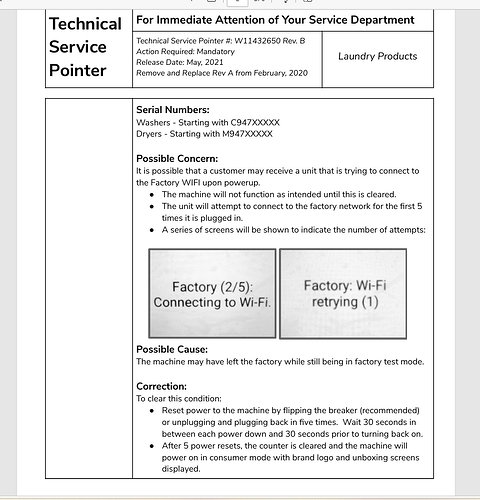

  4. Before F2E2 it also ran the factory Wi-Fi screen (Factory: Wi-Fi retrying, then Factory 3/5 Connecting to Wi-Fi). That cleared after power cycles. F2E2 did not.
I have not been able to enter service mode or run Factory Reset / DLMS calibration because the keys die before the 3-button sequence takes.
Harness is the new one, seated at the ACU and at the UI. I have not yet pulled the new console back apart to reseat the internal FLEXCONN ribbons.
Question: with ACU, UI, and harness all new, language screen up, and Start dead before F2E2, what is the next step? Or do you treat the new UI as defective and return it?

there should be a
@charlie2007
WTW6120HC1 service-pointer-w11498806-revc (1).pdf (1.4 MB)
