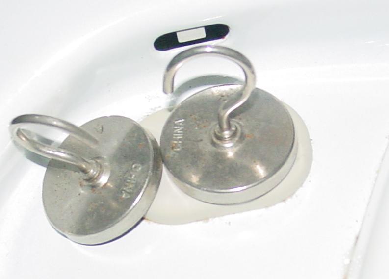

I am getting the od code on my maytag washer. I have tried the magnet down the side of the lid but it is not working. Any ideas?
FAV6800A correct?

Thanks… Doesn’t appear to have any broken wires, etc.. Magnet worked again. I will check out your other posts… Thanks much
“”Magnet worked again.”"
Are you talking about the internal Lid Magnet? See pic
If the OD error code pops up again I would check with a DVM to see if you are losing +12VDC signaling back to Conn P3_ pin 9 for +12VDC signaling Lid Closed Input/Lid Open Input referenced to Conn_P3 Pin 10 TDS Sensor Gnd. With the lid closed you would measure +12VDC and with the lid open you will measure no DC voltage.

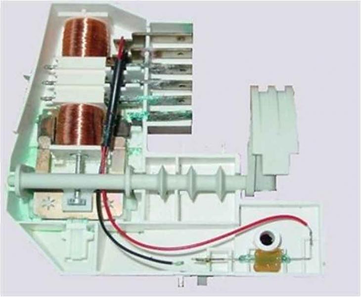

Thanks again Dick… I ended up taking relay apart and cleaning it up and seems to be working fine now… Thank you…
Good deal most of the time corrision issues come in to play to the point where the lead on the magnetic reed relay will break off. Glad it worked out for you and thank you for the update…Dick
Big Pic of Left Lid Lock.jpg (39.5 KB)
Check for open lead on Magnetic reed relay.jpg (34.5 KB)

[SIZE=3][COLOR=#000000][FONT=Calibri]The generic p/n is 25001048 for the Left Hand Lid Lock. [/FONT][/COLOR][/SIZE]
[SIZE=3][COLOR=#000000][FONT=Arial][FONT=Calibri]Appliance parts pro p/n is [/FONT][COLOR=#1455dc][FONT=Calibri]AP4033944[/FONT][/COLOR][FONT=Calibri] and you can get it from this site. Just confirm the p/n with whoever you order from to make sure I’m giving you correct info.[/FONT][/FONT][/COLOR][/SIZE]

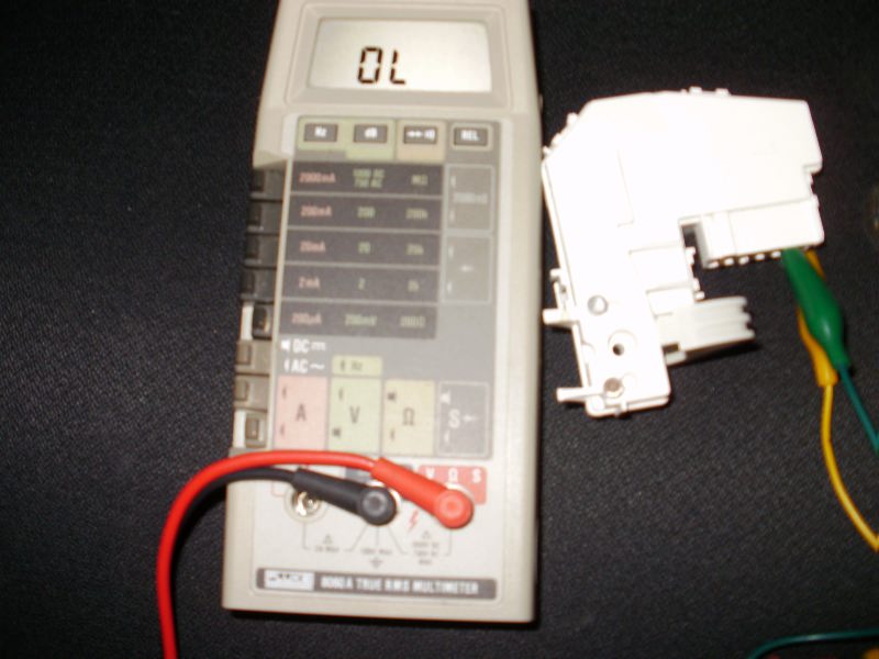

[COLOR=#000000][SIZE=3][FONT=Arial][FONT=Calibri]Do you have an OHM meter? I would check that the Magnetic Reed relay is closing with a magnet on the LH lid lock and opening when the magnet is removed as I show with the picks below. The other test I would do is to verify at the Control Board +12VDC at Conn_P3 pin 4 and trace that down to the Left Hand Lid lock and back to the Control Board Conn_P3 pin 9 “Lid Closed Input”. The Control board is looking for +12VDC to be removed from Conn_P3 pin 9 at the end of the Wash Cycle or Spin Only Cycle when you open the washer lid. [/FONT][/FONT][/SIZE][/COLOR]
[COLOR=#000000][SIZE=3][FONT=Arial][FONT=Calibri]The last Pic is measuring “Lid is Locked” +12VDC signaling at the Control Board Conn_P3 pin 8 just to show a typical +12VDC signaling at the Control Board. This is how I would confirm the +12VDC signaling at Conn_P3 pins for trouble shooting the “OD” and “OP” error code. [/FONT][/FONT][/SIZE][/COLOR]
[COLOR=#000000][SIZE=3][FONT=Arial][FONT=Calibri]That is all I can suggest in troubleshooting to get closer to the fail point if you can do this additional troubleshooting. [/FONT][/FONT][/SIZE][/COLOR]
[COLOR=#000000][SIZE=3][FONT=Arial][FONT=Calibri]I guess the Magnetic Reed relay contacts can fail stuck closed. I would make sure that you have the option to return the Left Hand lid lock if the replacement does not fix the issue.[/FONT][/FONT][/SIZE][/COLOR]
[COLOR=#000000][SIZE=3][FONT=Arial][FONT=Calibri]Dick[/FONT][/FONT][/SIZE][/COLOR]
[FONT=Calibri][SIZE=3][COLOR=#000000]Posting additional pic for Ohm meter connection measurements of the Left Han Lid Lock. I have the Ohm meter placed between the L.H . Lid Lock pins I have labeled P1 and P2.[/COLOR][/SIZE][/FONT]
[FONT=Calibri][SIZE=3][COLOR=#000000][/COLOR][/SIZE][/FONT]
[FONT=Calibri][SIZE=3][COLOR=#000000]The last pic is Conn_P3 on the Control board with some additional pinout info. [/COLOR][/SIZE][/FONT]
