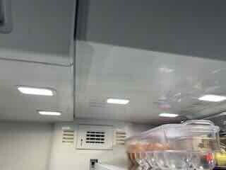

Hey there — lighting parts received. Problem was the freezer light was no longer working. Once that was replaced all of the other lights came back on … confirming wiring diagram that they are in series and this is the first/last light in the series. I however started with the refrigerator ice maker lights instead of the 3 lights grouped on the right side. Then went to the freezer light. Freezer light is harder to get to. Picture of lights working.
Part number needed: W11483116. Freezer light and left side ice maker refrigerator lights are the same part number. Lights on right size are a group of 3 in a single part number. Also replaced control board but that was deemed to be supplying correct voltage. Never located Aurora controller but I’m guessing it is on the new control board.
