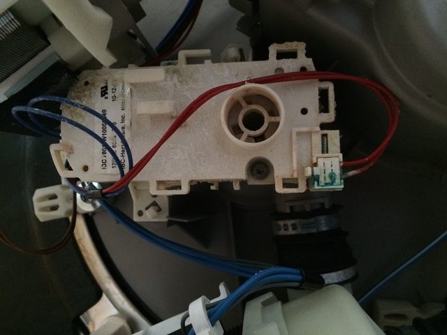

I’m glad that I found your posts. I too am having a problem with leaking through the diverter motor on the Kitchenaid KUDE70FVSS0. I had already purchased a replacement diverter motor from AppliancePartsPros since its operations was suspect. It did not come with a replacement washer. Today I removed the washer and noted that it was groove side up, away from the diverter motor. I did remove it, clean it up, and flip it over. I’m still getting water through the diverter motor. I guess that either the washer needs to be replaced, or there is some other problem with how the diverter motor connects to the sump. Anyone have any advice? I may have reached my level of incompetence and will have to call in an appliance repairman. Some have mentioned using plumbing silicone to stop the leak. How did you do that? Thanks for any help.
Yeah I got it fixed. The trick it to remove the seal, I cleaned mine with CLR to remove the gunk inside of it. I flipped it over so the sealing spring/ring is pointing down. I used silicone grease on the shaft. Slide the seal over the shaft all the way down. Then install the diverter. As I stated earlier the connecter for the small switch was essentially gone. I just soldered to the small board directly the wires. The seal goes into the housing but not as deep as if you install it first. That is the trick. The seal being lower on the shaft seals tighter and no more leaks. I have checked on it half a dozen times to make sure it’s still holding up and not a drop. The diverter motor on mine clacks a bit and I may look to see if the internals of the diverter valve are OK. I can hear the water being shuttled between the upper and middle sections now (the job of the diverter) so I think it’s working OK.
The pump on mine slightly shifted over time and it’s slightly hanging down from the housing. I tried to get it back into the original location a couple of times but the design sucks. I used a small piece of foam rubber under the pump motor to push it back up into position and that reduced a lot of the clack noise. Sad that this dishwasher is only three years old but it’s only designed to last at best about four to five years based on the crappy parts being used.
Thanks jp_austin. My situation is exactly as previously illustrated in fixya. The washer does not have a sealing spring, so we may have slightly different parts.
I did not use the silicon grease, so I may pull it all out again and try that. Another poster had mentioned using auto silicon as a sealer with the washer. I’m not sure about trying that as it may gum up the diverter rotation.
You mentioned that your pump had shifted position. On the KUDE70FVSS0 there is a rubber retention tab that holds the motor in place to the sump housing. I only noticed the tab when it fell out during one of times that I tipped the dishwasher onto its face.

I took the diverter motor off and like many others in this thread, the o-ring was installed upside down. I cleaned + reversed it, but it still leaks. Should I be able to spin the shaft with my hand? I was not able to, and wasn’t sure if this is because it’s so corroded (perhaps from having not moved in a while?) or if it’s just not something you can move manually while holding the part.
Has anyone tried to contact KitchenAid with any success about this? Seems like if this has happened to many people, they should at the very least be offering to replace the parts for free, if not send out a repairman at no cost to install the replacement parts. I intend to call them tomorrow.
I’ve come really close to just buying a new dishwasher, but this one was pretty expensive when I bought it, so it seems like a waste to not try to replace whichever parts are malfunctioning – but the fact that this has clearly been an issue since I bought it makes me so angry!
I’ve attached some images of the parts mentioned, hope they help someone out. It would be great if someone who fixed the problem (I am intrigued by the auto silicone solution) would show a photo of what they did to remedy the issue.

Replacing the diverter motor (and re-installing the o-ring cleaned + facing the correct way) has solved my issue, it is no longer leaking after 5 days of service. The connection points on the motor were still fairly corroded (as you can see in the photos) but I guess not badly enough for it to stop working entirely. I didn’t apply any additional sealant / silicone.
[QUOTE=eh270;878564]Replacing the diverter motor (and re-installing the o-ring cleaned + facing the correct way) has solved my issue, it is no longer leaking after 5 days of service. The connection points on the motor were still fairly corroded (as you can see in the photos) but I guess not badly enough for it to stop working entirely. I didn’t apply any additional sealant / silicone.[/QUOTE]
