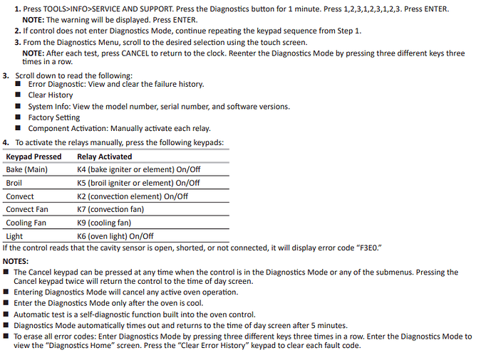

The first step would be identifying if the cooling fan is operating properly. This can be done through a diagnostic mode where it can be turned on without having any other part operating. Here are the steps. Let me know if the cooling fan seems like it does not push air through the vent well.
Thank you! I did diagnostics mode. The fan did not push out any air at all, and I did get an error code. F8E0

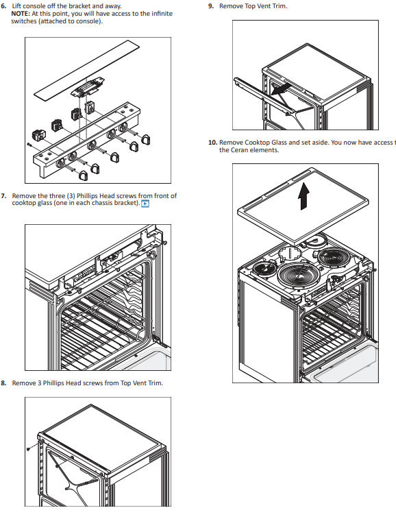

This is a failure with the cooling fan circuit. To test it, the power supply would need to be turned off or the power cord unplugged, the cooktop removed, and the left side panel removed. To do this, remove the center grate and the screws just under it. From there, remove the screws under the console, lift it up, and let it rest on the frame just enough to remove three screws securing the top panel. This image are steps for removing the top panel. Once that is done, the top screws for the side panel can be removed, along with any screws along the back, bottom, or front. The console can be set down back onto the frame where it should sit like normal. The cooling fan should have a purple wire and a white wire going to it. Set the meter to volts AC and place the probes onto the wires as securely as possible. Plug the power cord back in or turn the power supply back on and go into the diagnostic mode to activate the cooling fan test again. Does it get 120 Volts AC?
