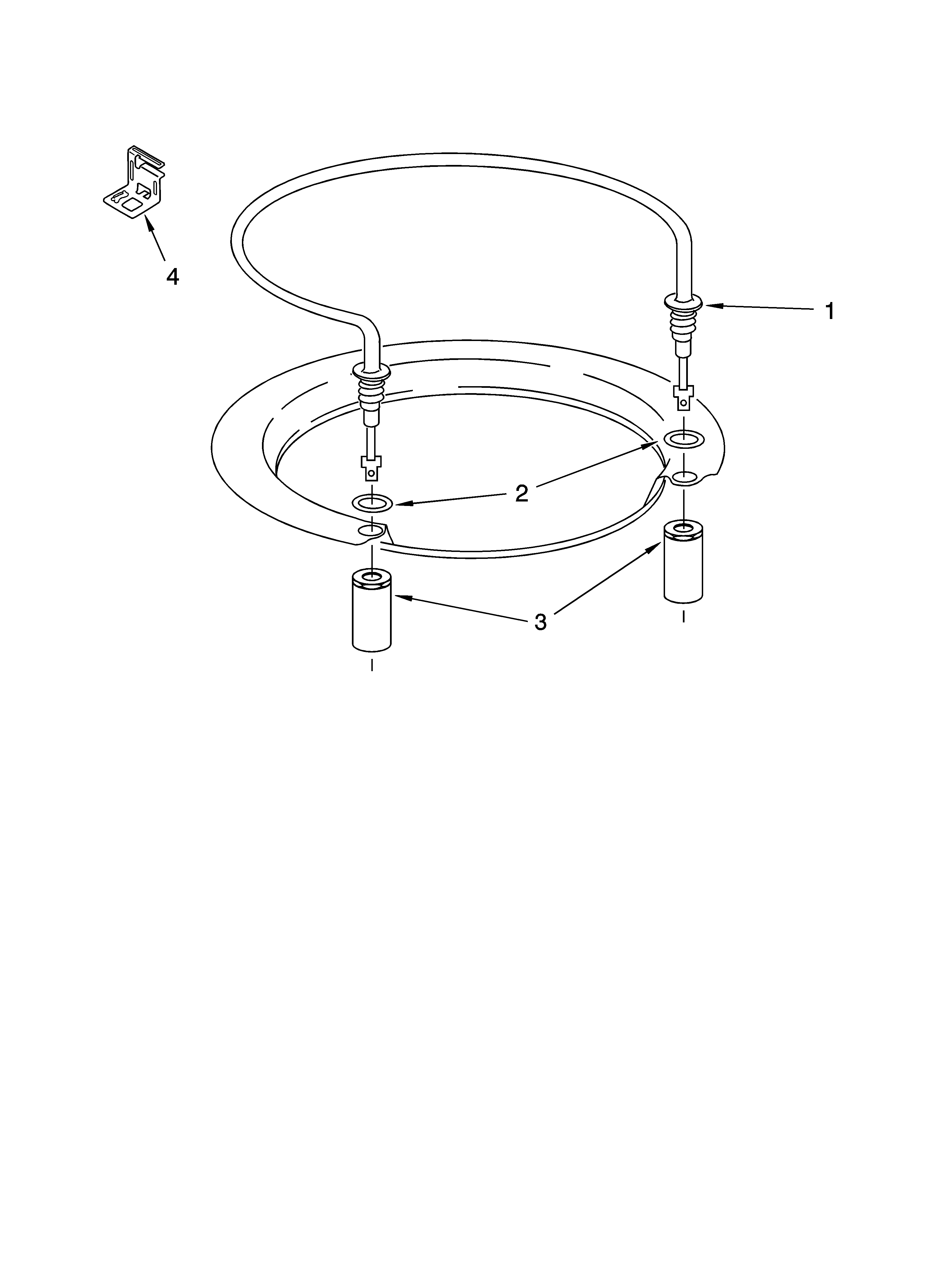

I was just looking at the inside again and it looks as though the heating element may be cracked at the very front, would that cause the machine to continuously run?
It is a bit more obvious after moving it(element) a bit, do you have the drawings on how to replace the element? It doesn’t look very healthy at all upon close inspection
As you can see on the diagram the heater is secured with the two plastic nuts (#3) under the dishwasher. You have to unplug the wires first. The new heater comes with the two washers.
  • The part number for the heater is AP4325066
P.S. The control board keeps the dishwasher running until it senses the correct water temperature.
Thanks Gene, I would like to buy you a beer! I will get the parts this week and let you know.
I replaced the element today (only $34) everything is cycling and the diswasher is working perfect, thanks very much for you help!
