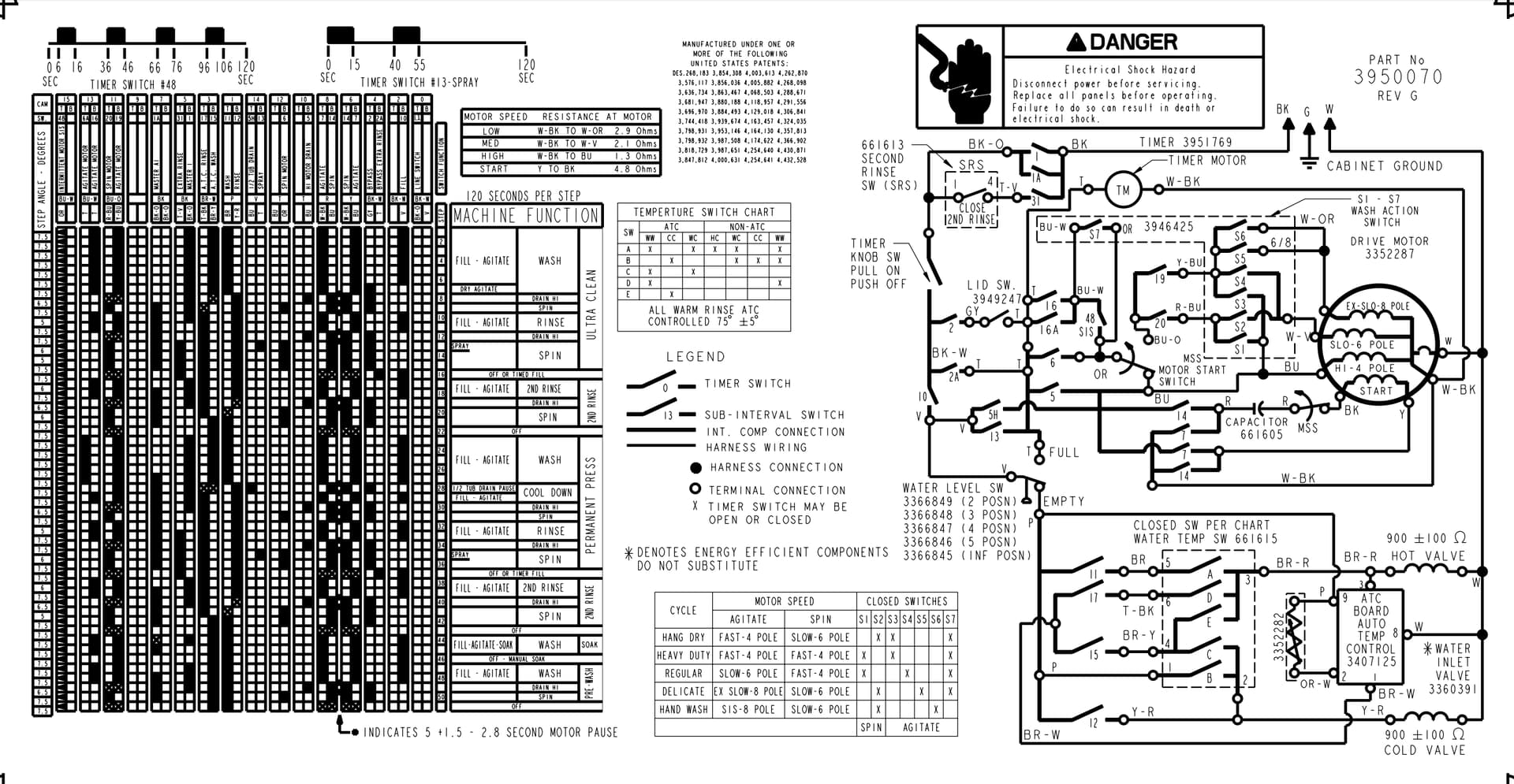

This would be the wiring diagram for the old girl:
Thanks, this is helpful - my eyesight isn’t good enough to read the label on the washer :-\
