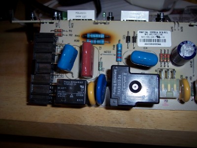

Found a problem, hopefully the root cause. On the circuit board inside the control panel found a burnt resistor and the circuit board is blackened. Now to find a replacement circuit board.
New micro-computer has arrived, been installed with all components, panels, covers, plugs, etc. reinstalled, connected etc. Refrigerator runs fine for cooling. Once reaching actual cooling temperature (confirmed by thermometer placed inside), keeps running. Now looking for why it will not stop running.
New micro-computer has arrived, been installed with all components, panels, covers, plugs, etc. reinstalled, connected etc. Refrigerator runs fine for cooling. Once reaching actual cooling temperature (confirmed by thermometer placed inside), keeps running. Now looking for why refrigerator will not stop running once it reaches proper temperature.
I’m going through a very similar problem with a very similar fridge…uses the same control board. If you only replaced the control board you have only cured the symptom, not the root-cause. It will probably be a pretty short period of time before you burn another control board. Something else is wrong that caused the burned resistor.
That board is too expensive to go through them like chewing gum.
FYI, I burned the adjacent resistor and am trying to identify the root cause now.
