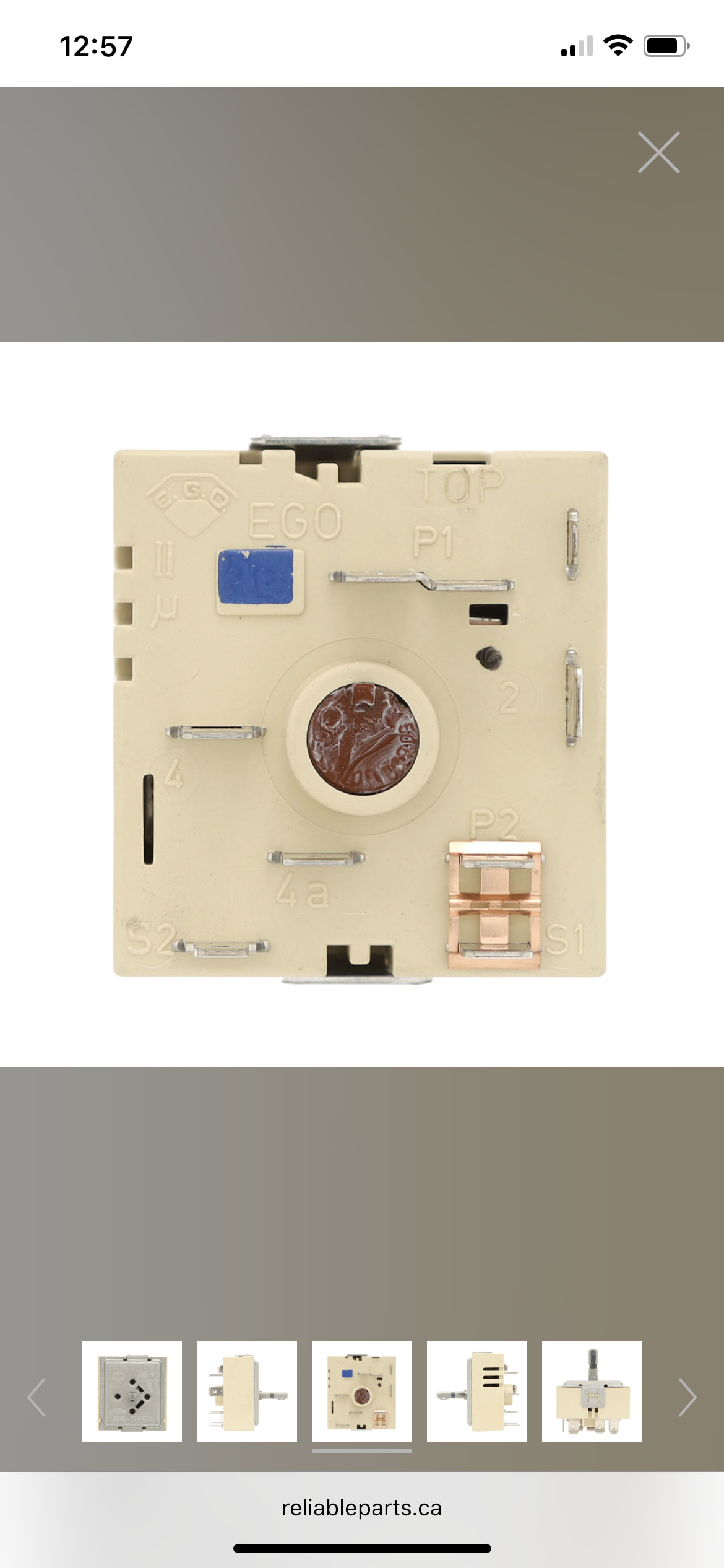

Yes — that picture confirms the WG02F04019 has these five usable terminals:
  • P1
  • 2
  • P2
  • 4
  • PILOT
It is the correct dual-element switch listed for JCBP800DT1WW, and it supersedes WB24T10058.
However, the photo does not resolve where the old 4A (blue/white) and S2 (purple) circuits are supposed to be transferred. The old switch used additional contacts that aren’t physically present on this EGO switch. The exact same wiring problem for this exact model/replacement has been documented, but the published discussion doesn’t yet contain GE’s conversion wiring table.

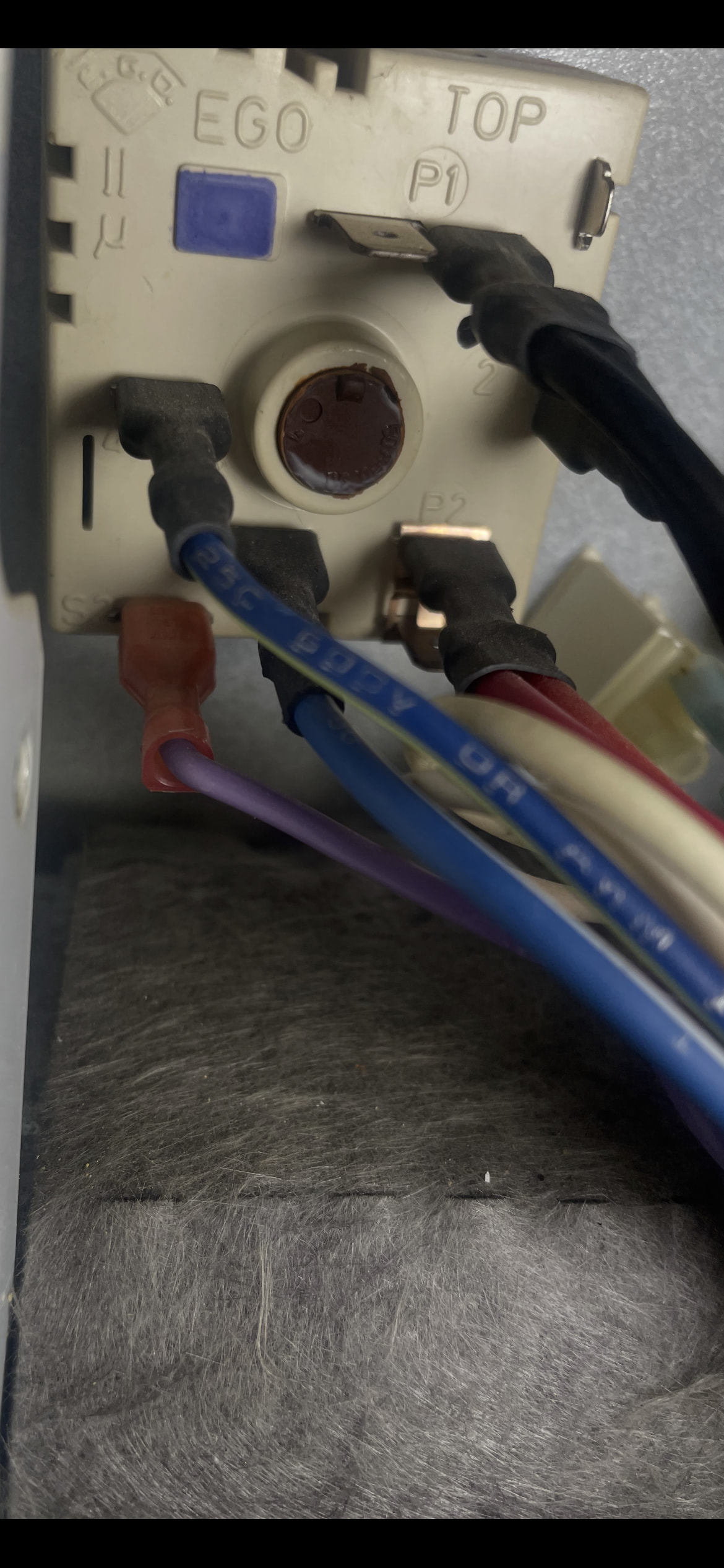

I DID MAKE A MISTAKE. TERMINAL 2 IS A BLUE WIRE NOT YELLOW. THIS IT A PICTURE OF MY OLD TERMINAL WITH THE WIRES
So again
p1-double black
2-blue
P2-double red
S1- is empty but jumped with p2
4a-blue with white stripe
S2-purple
4-blue with green stripe
This is the old terminal layout
And obviously you see the new designed switch wg02f04019
And this is my old wb24t10058

Those pictures help. The old switch layout is now clear, and the wiring shown matches the sketch:
Old switch terminal Wire shown
P1 Black — two black leads on the connection
P2 Red — two red leads
2 Yellow/light-colored lead
4 Blue
4A Blue/white
S2 Purple
S1 Jumper/circuit associated with P2
The important part is that this is not a simple terminal-for-terminal replacement with the 5-terminal WG02F04019. The old switch has separate S1/S2 and 4A contacts for selecting the two sections of the dual element. The replacement pictured earlier only gives us P1, P2, 2, 4 and PILOT.
GE’s mini-manual confirms that the dual controls select the large zone in one direction and the small zone in the other. It also specifically warns that these are current-sensitive controls and the leads must be connected correctly; reversed wiring can destroy switches.
So I would not connect the WG02F04019 yet based on the assumption that the extra purple and blue/white wires can simply be combined or abandoned.

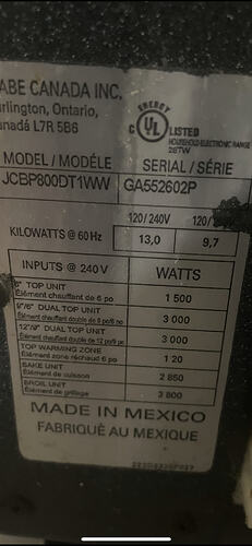

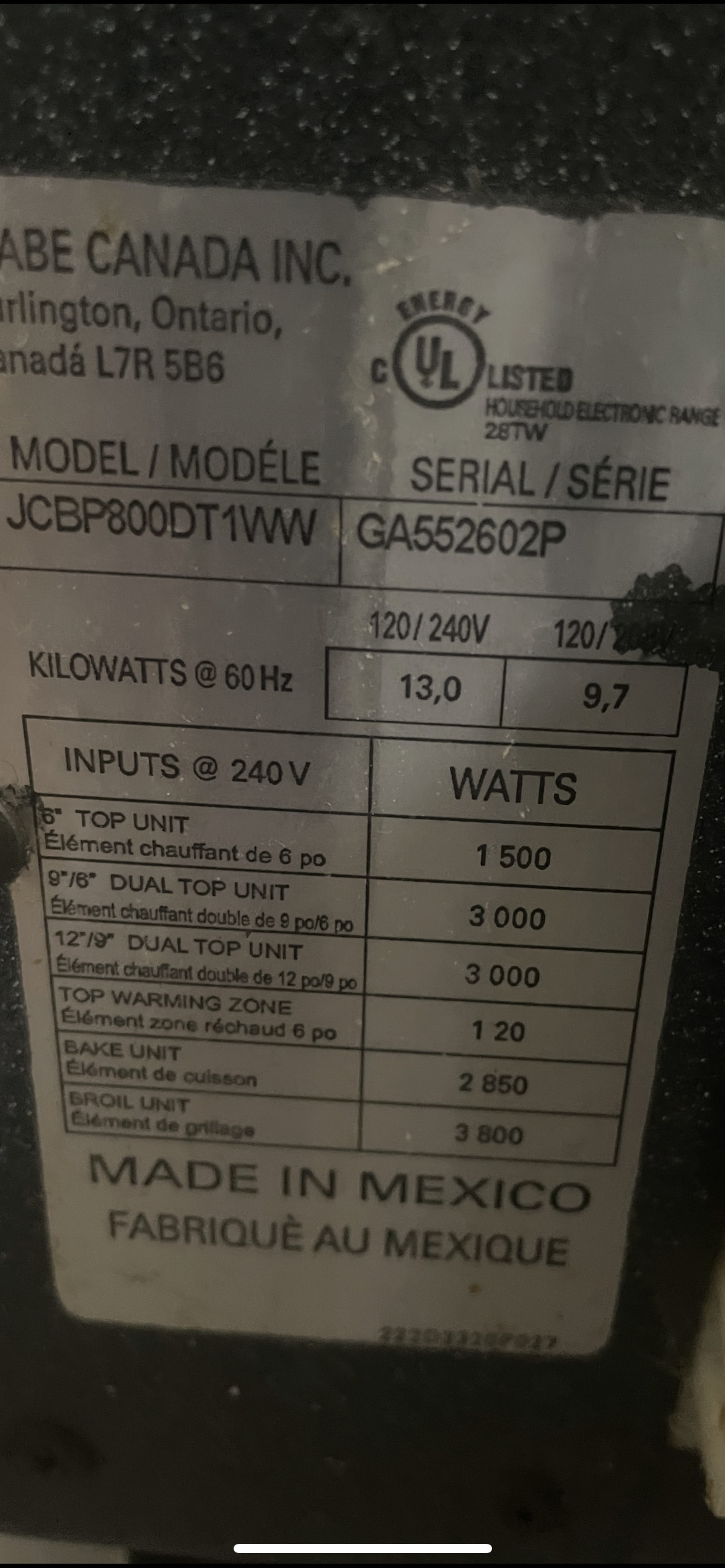

Can you send me a picture of the model # tag. I am having a hard time getting your exact model
I see the issue. It was made for Canada we have no direct info for units made for Canadian use
Well that sucks. I didn’t even notice it was made in Canada. I would think that it theoretically woks the same. Do they have different electrical up there lol.
So I’m out of luck ?
