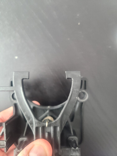

Per the video you mentioned the actuator seemed fine, but I’m wondering, is this part of it? I took off the actuator and appears one tab is rubbing and melting off and the actual white transmission cog is worn around the cylinder where the actuator tabs would potentially contact it (why they make it so tight left and right is beyond me) howver, it’s now worn smaller so shouldnt rub more) Unfortunately, the lower black cog is so sized up it will just not come off to be able to replace it all.

The only thing really left to cause the issue is the transmission itself
Was my thought too, though my understanding is that it’s a bear of a repair on the stacked spacemaker since you either need to remove the whole drum or turn the machine on it’s side, and we can’t just do it by removing the front panel - unless I’m mistaken?
