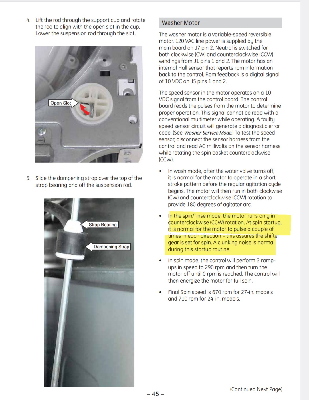

All good.. But interestingly this is what the manual says.
Missed that but it also says it should spin a lot faster than it does in the next paragraph

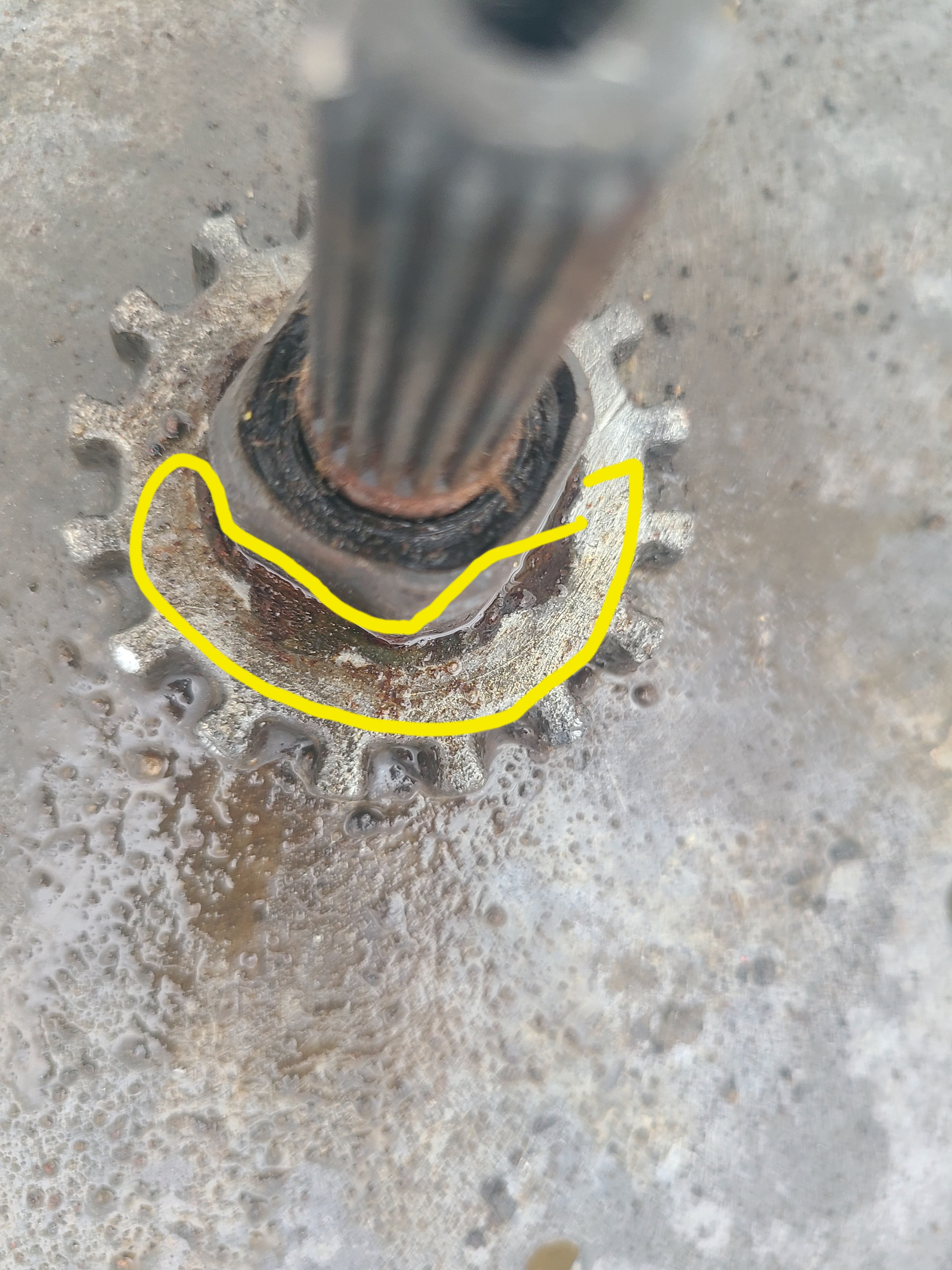

So the teardown is moving along but we’re stuck here. Obviously it’s rusted in. Since I do not have a comparison, does this square transmission shaft ordinarily rotate freely in this hole? Or does it lock on? In other words, would I be fairly safe to drill out all around this?
If you have already removed the retaining nut that is just a washer it should just slide up the shaft, of course it’s probably llocked on by corrosion
