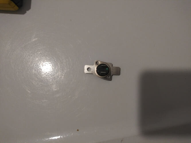

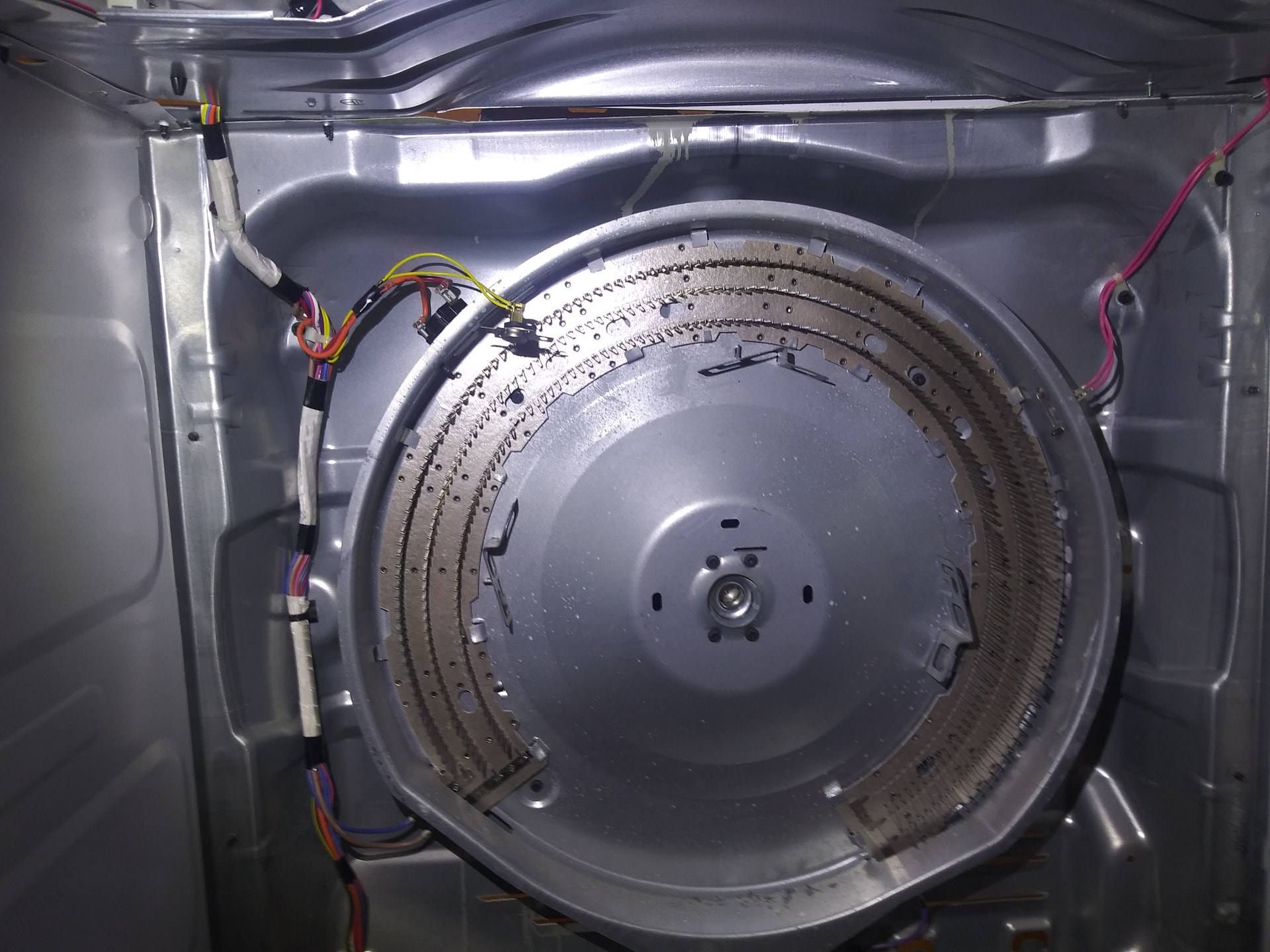

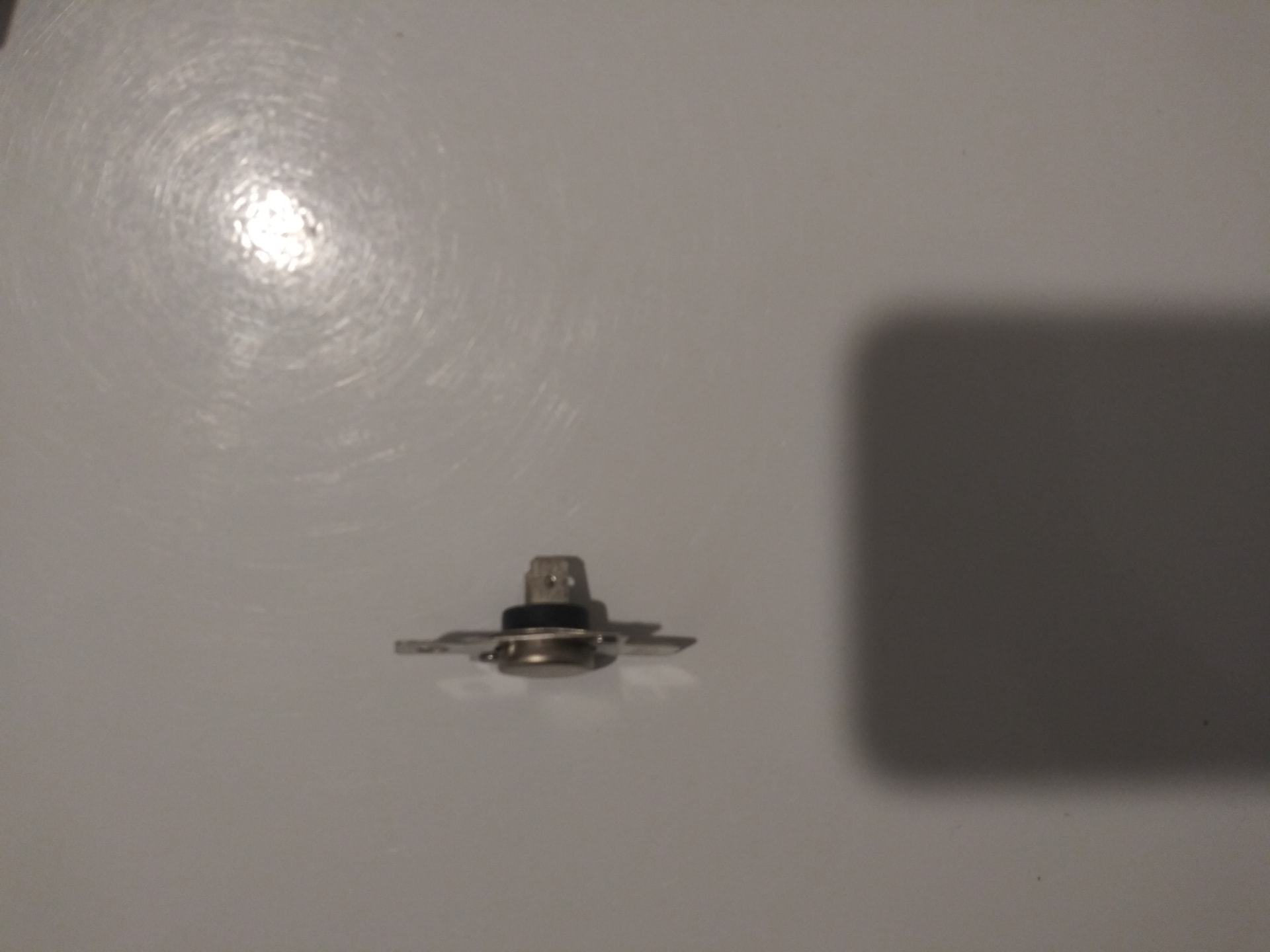

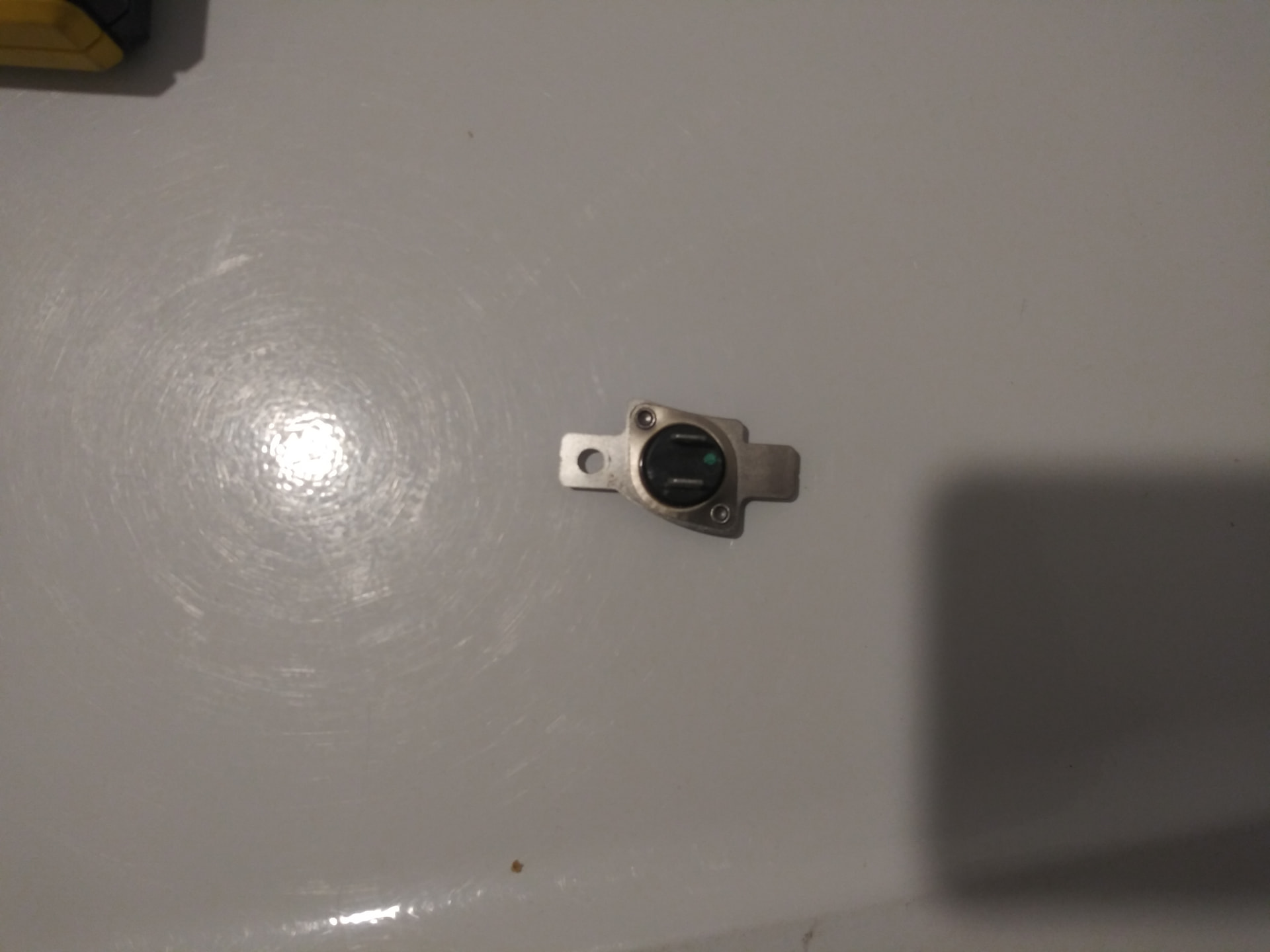

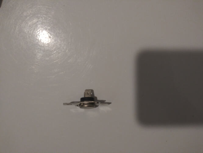

Ge GTD72EBSN0WS dead from one day to the next. display is dead
Brand:GE
Model Number:GTD72EBSN0WS
Main Symptom:NO POWER. DISPLAY DEAD.
What happens & when: from one day to the next wont turn on. the display is dead.
Error Code (if any):no error codes. screen wont turn on
Parts or tests already tried: tested what i believe to be 2 thermostats, one on the left (orange and red wire) and the one to the right (pink wires) and thermistor (yellow wires). the thermostats had continuity and the thermistor. Will a failed thermistor keep the dryer from getting power?

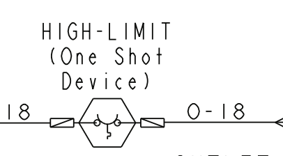

There is a one shot High - Limit that would do this.Here is the tech sheet!
31-3000200 GE GTD72EBSN0WS Electric Dryer Mini Manual.pdf (850.5 KB)
