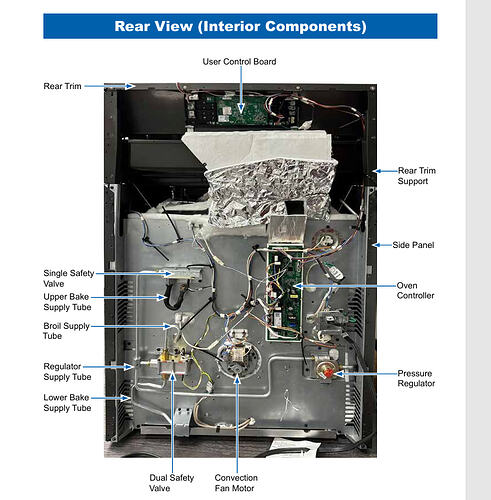

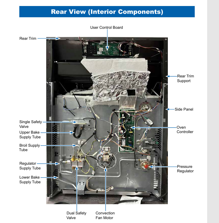

First question did you change the control board on the control panel or the oven control board on the back of the unit? To me the original issue sounds like
jgb860dej3ww 31-17182-2-Mini-Manual-21579.pdf (651.7 KB)
it is being caused by the oven control board. I am going to attach a tech sheet for reference. As far as setting the personality code I could find nothing in the GE service manual about it
Interesting, from the information I could find the interface panel assembly was the main control point. I don’t see another controller associated with this oven but if that is the one that I need that would be a great thing to know.
This is what it calls for in the service manual (GE WB27X36806 Wall Oven Electronic Control Board | Genuine OEM Part)
I did not see this on my review of the oven’s parts list but it does make sense that this would be the part that would fix the problem.
I will reply back when I know more.
Thank you!

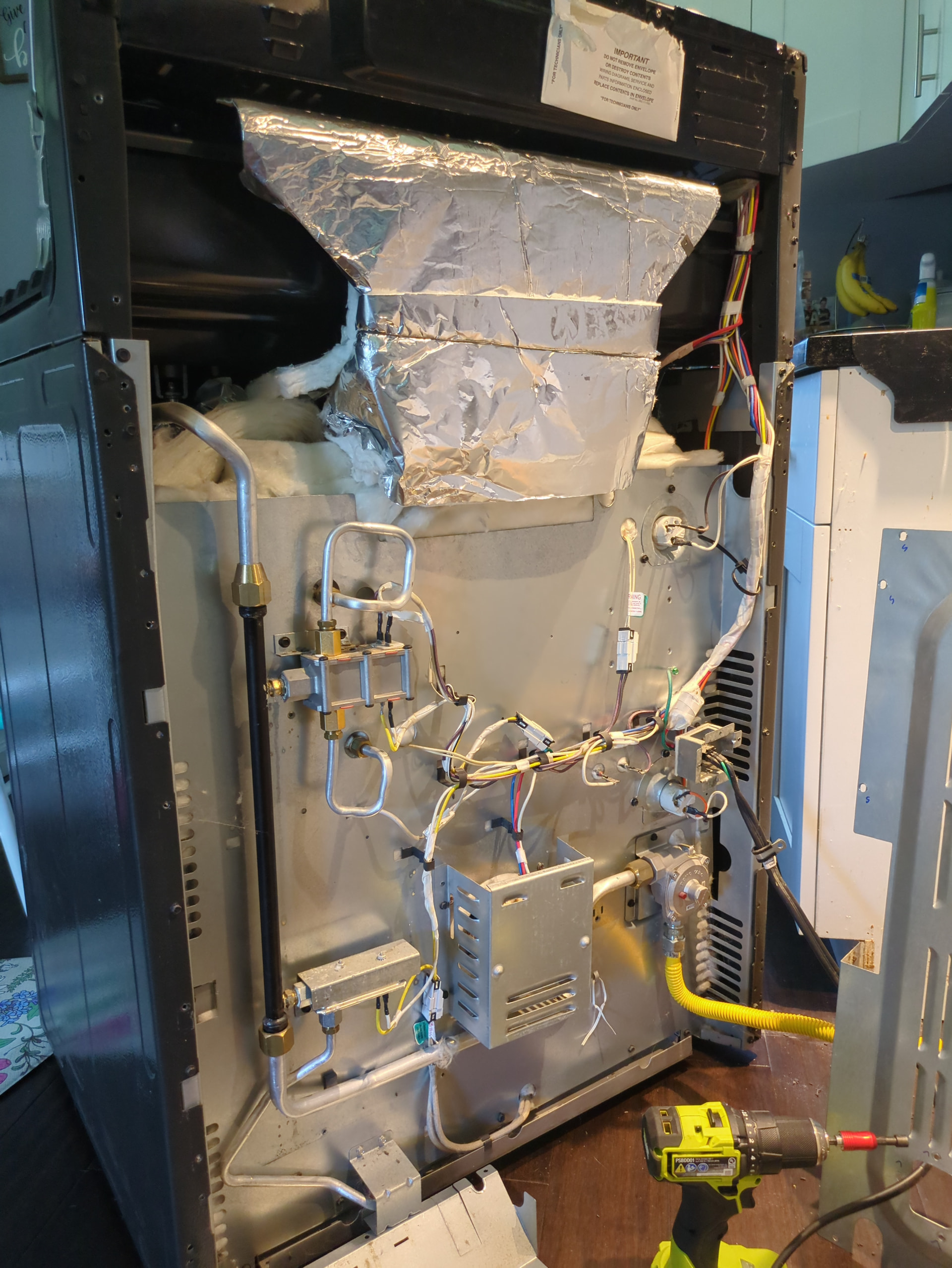

Is there a reason that appliance parts pros website lists that board as incompatible with my oven? I can’t find any information that ties that control board to my oven.
Yeah I’m getting conflicting information about whether yours has a separate board, Have you actually looked on the back and seen if there is a board, GE says some ovens in this models class have 2 , some don’t.
My unit does not appear to have a secondary control board.
No it does not.
