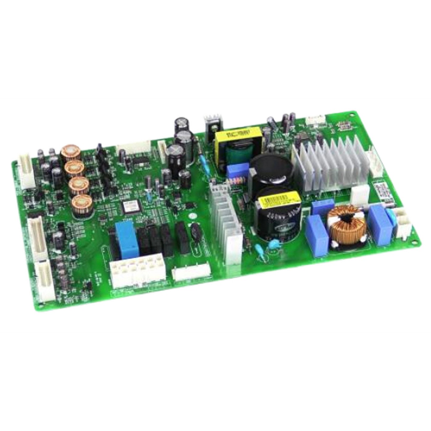

I don’t know of a way to test, but I’d think the power board would be a good place to start checking…
LINK> Power sub board.

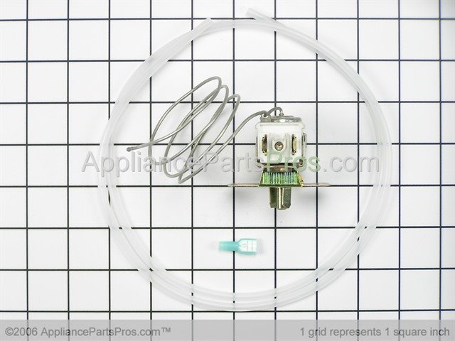

Jump the 2 wires on the thermostat /cold control together and see if the compressor comes on and fan motor!
That one is quit different :wink:
Like Bigbuck1 mentioned just remove the power cord, join the two wires together (no green wires) and plug the refrigerator back in to see if it jumps back to life.
If it does = new control time.
LINK> Cold Control

Thanks. I spent a while checking relay, compressor, etc and found nothing. I then removed the 2 wires from the cold control and connected them to an old control that worked. Like magic it started up. You are right on the money, thanks for the help!

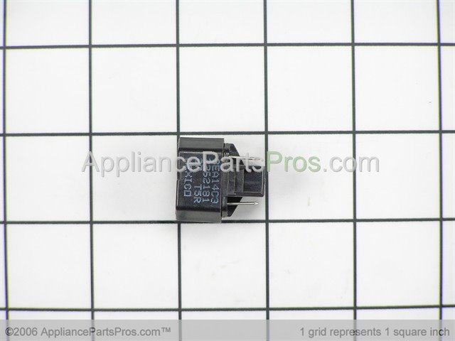

This is the replacement relay for the 106.7625463 fridge. My original relay is the old style copper wire electromagnet. It has one tab for the red wire connector that sends voltage thru the overload protector . The instructions offer explanation for connecting if the original relay has 2 or 3 tab connections, no explanation for my situation of only 1 tab. Can you tell where i would connect the single wire when the relay fails?
According to your model# (the second one posted) shows this as the replacement start relay…
LINK> Start Relay

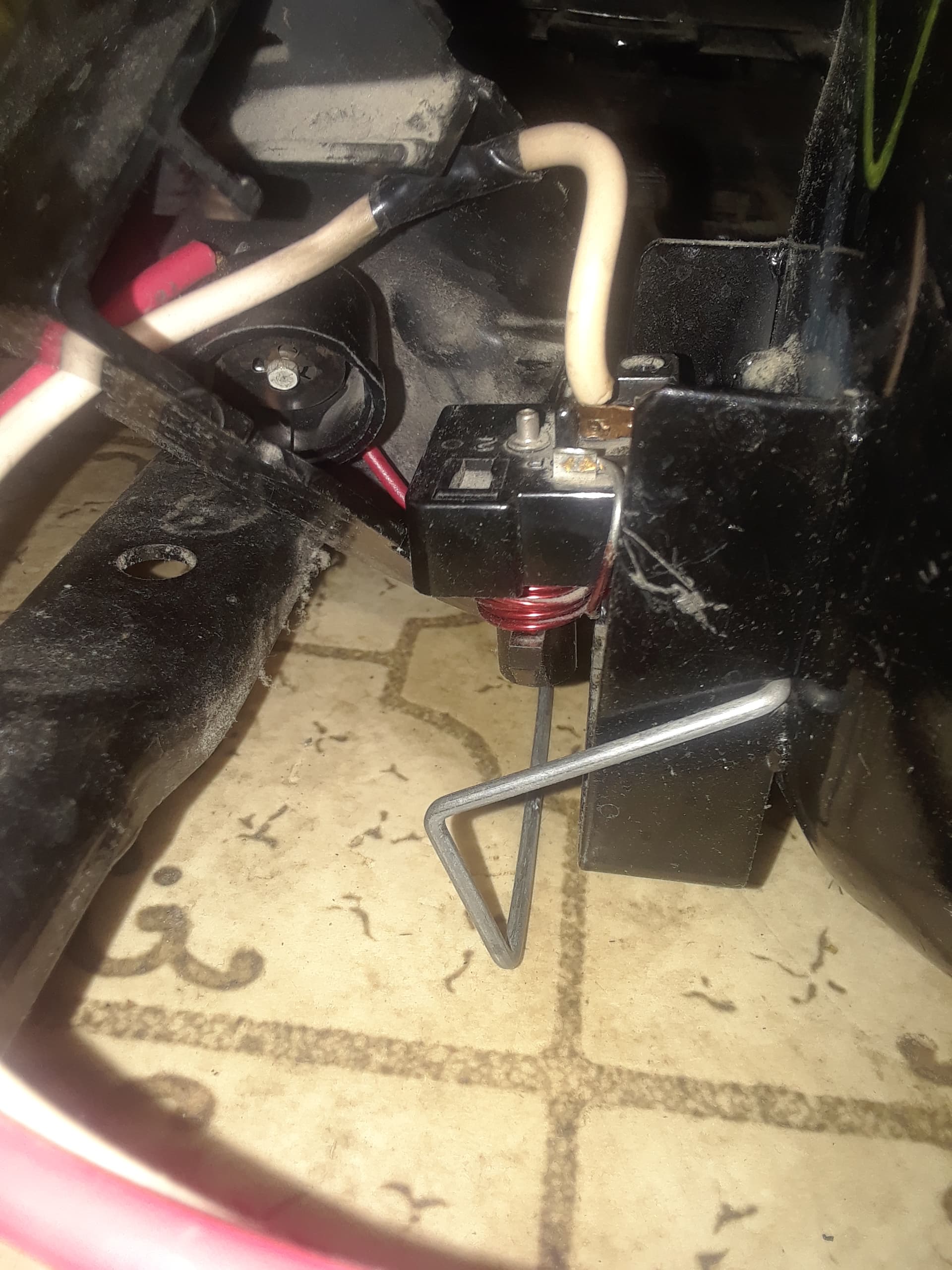

TERMINALS ON THE RIGHT SIDE OF THE RELAY ARE CONNECTED TOGETHER AND THE ONES ON THE LEFT SIDE ARE CONNECTED TOGETHER.This is probably upside down picture of the relay because it can be used on different style compressor design.The overload is usually hook to common terminal on the compressor.What was wrong with the original relay?

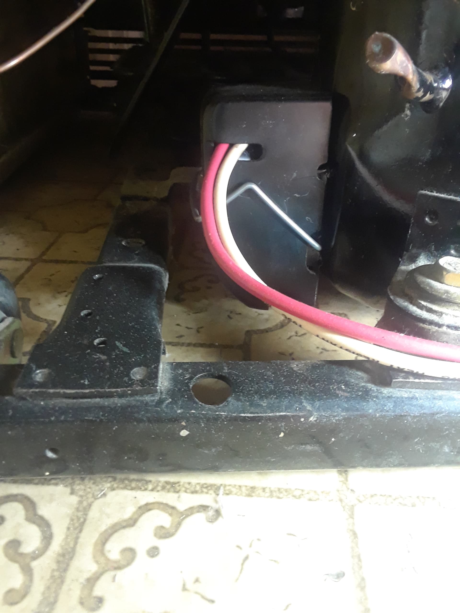

Here are pics as Jeff sr requested. Bottom pic show only 2 wires.
Top pic show white wire to top pin of compressor. Red wire attaching to overload and then smaller gauge red coming from overload to the only tab on the relay.
No capacitor, no other wires.
Thanks bigbuck1 for the diagram, yes it is upside down for my application. With the pics and explanation, where do I connect the single red wire coming from the overload?
