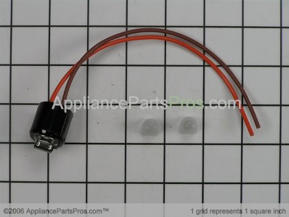

any idea of the part no. of that thermostat on photo?

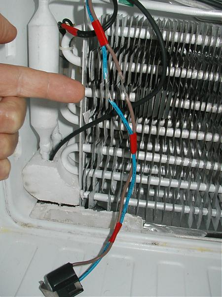

hello ,I connected the bare wires in the photo shown .Instantly some small chips of ice flew off a wire at the top of the coil,but after 1 hour the frost build-up was all still the same .would this point to a bad defrost heater?
I do not think it was a good idea because of poor connection and possible shortage to metal parts.
As abadfish66 advised, you have to cut the thermostat out and connect the wires using a wire nut.

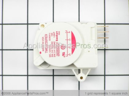

The defrost timer must be in “defrost” position at this time to provide power to the defrost parts.
ok,how do i get it in defrost position?,i cant use my model # to see the breakdown.i cut out the switch and put on a wire nut,same result.

Most likely it is somewhere in the control panel and it should look like this:
[CENTER]
[/CENTER]
[LEFT]Using a flat screwdriver, slowly turn the shaft in the middle CW until it clicks and the compressor stops.
Gene.[/LEFT]

I’m not able to tell you where the defrost timer is located because I do not have break down diagrams for this model. You have to search your refrigerator for a part looks similar to the picture I posted earlier.
