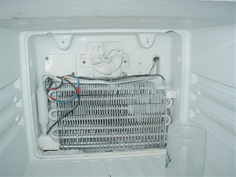

,the back of the freezer was a big chunk of ice,i defrosted it,
it looks like i can manual defrost by unplugging? until I can find out what the defrost part looks like i need to replace sometime.
If you can post a pictures of the fridge, it might help to provide more accurate advise.

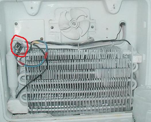

ok here are some photos of the inside etc.im manual defrosting every 5 days now.it seems to help leaving the cover off as shown.
thanks
chlear909,
One of most common problem is such situation is a bad defrost thermostat (in the left upper corner). Check this part for continuity while it’s cold and replace if it’s open.
The part number should be marked on the old part. If it’s not ,then it suppose to be the temperature mark, like L50-35 or something like that.
Post your findings and I’ll help you to find the right replacement part.
