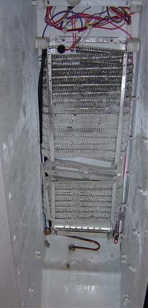

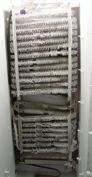

Hey Gene, i didn’t see any blockage in the damper…do you think it could be part #257 ? Check the pics of the coil. one was on 7-4 about 15mins with the door open. Check the one from today july9, taken immediately…let me know what you think…
Sorry, i meant #424
The coil looks good. The part with #257 is the defrost timer which has nothing to do with your problem. There is nothing wrong with the defrost system.
There is something wrong with the air flow. Did you check the duct air return? Be sure the damper is wide open.
#424 is the temperature control which is has nothing to do with this problem too.
I removed the foam nozzle #426 from the wall #428 with no obstruction. Correct me if i’m wrong but if warmer freezer (sliding 428 to the left damper wide open) equals colder fridge what does #424 have to do with the fridge temp. It seems odd that this just failed with no movement of the damper.
