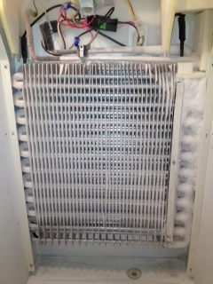

KitchenAid side-by-side built-in fridge (7 yrs old) is not defrosting properly. After manually melting the ice off the coils with a hairdryer, in about 7-10 days it ices up again and then the temps in the fridge go up. The frost pattern seems to be normal, except the top right hand side starts to build up excessive frost. The location is right next to the air return vent. See pics taken one week after manual defrost.
What could be causing the evaporator coils to build up this excessive frost only on one side? How does this get fixed?

In the meantime, I’ve replaced the defrost thermostat and the thermistor. I have also confirmed that the fridge IS going into the defrost cycle about very 8 hours. However, in about 7-10 days the frost builds up again on the right hand side and I need to manually defrost the coils with a hairdryer to keep it working properly.

It looks like it is an air flow problem.
See the attachments for the info I could find on similar problems.
Perhaps moving the defrost thermostat to the left would help.
Problem with this would be that it might cause too mush heat in the freezer when doing a defrost.

I took a good look at the insulation and behind where the heater threads through the foam padding it has curled downwards in the back and doesn’t have a snug fit. All he other insulating padding looks good and snug.
I will look into replacing this. As well as moving the thermostat as you suggested.
Also, when I took a look today the drain hole was completely iced-over. Could this be either a sign of something or a contributor?
Just a thought, is there any possibility that the heater could burn out in that section only? Would it be worth it to replace the heater as well. Looks a little tricky to do, so I don’t want to mess with it if not needed.

Back again…I have still been dealing with this issue, although now the fridge will last up to 2 weeks till I have to manually defrost with a hairdryer.
I looked into the airflow and DID notice that on that right side the foam insulating piece directly above the evaporator coils was a little warped and not fitted perfectly snug. Since the foam replacement kit for my model is a little pricey at $50, I decided to see if I could fix it myself. I wrapped a thin piece of cardboard with ducktape and stuck in under the existing foam piece…propping it up. Not a perfect solution…but, I just wanted to see if it would make any difference. It did! Problem is not solved, but now it takes twice as long for the fridge to totally ice up on that side.
I am ordering the insultating kit and will replace all the pieces.
I am still concerned about the heater, and got lucky the other day and was able to observe during a defrost cycle.
I noticed that the bottom section of the heater glows bright red at the start of the defrost cycle for about a minute. The top right section of the heater (where the coils have excessive frost) remains black in color and I don’t notice any change in color…that section does not burn red.
Is this normal? Should the entire heating coil turn red in color during the defrost cycle. Also, how long should the heater be giving off heat?

I do not know if the entire defrost element gets red but if it is just one area then I would say that this would not be normal.
