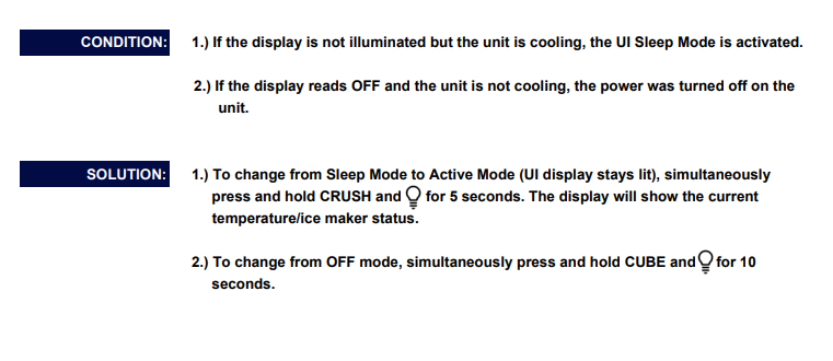

Brand:frigidare
Model Number:GRSS2652AD6
Main Symptom: no electric in unit outlet is fine
What happens & when:running fine then just died

These apparently had a known issue with getting turned off somehow. Try this first to turn it back on:
If that doesn’t fix it let me know. There are some voltage checks that can be done at the board. Here’s the tech sheet for this model as well.
GRSC2352AF0 A18520603.pdf (507.7 KB)
