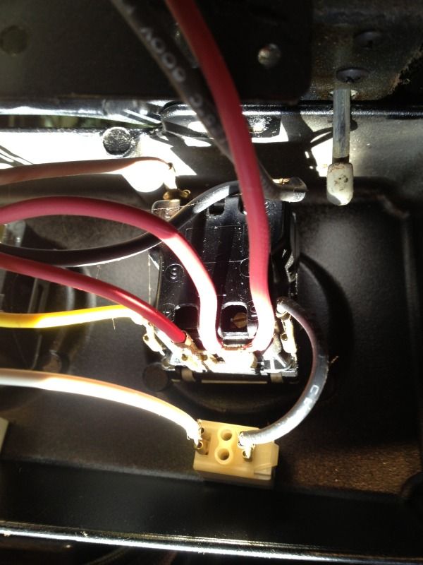

I hope you’re still here Joe, I’ve got a question. I too replaced the switch per your instructions and tested. The dual element burner turns on both large and small rings but only on high. When I turn the dial I can hear the thermostat click but no reaction from the burners? Was my switch not the problem afterall? I replaced the infinate switch because the RF dual burner only went on to high with no adjustment to low? Help
Zinger, So far everything sounds normal, and operational. You did need a new infinite switch. If the burner remains on “HI” Regardless of setting, this indicates the “cycling” switch and circuit contacts have arced together and the switch needs to be replaced. When you use the dual element burner, the “low” setting(right side of switch) operates the inner ring only. When you select the “HI” (left side of the switch) this operates both the inner and outer elements, and they cycle off and on in unison. Right now, you’ll need to check and make sure the Red L2 wire is attached to the P2 terminal of the new switch. (The L2 red will be “hot” 120 VAC as long as there is power applied to the range, and common to all the infinite switches). The other two red wires will attach to the number two(2) terminal of the switch (these red wires will enter the wiring harness junction connector and attach to the heater elements in the cooktop). If the wiring at the new switch is not correct, you wont have any L2 power to the element and it wont work. Thanks
Hi Joe, thanks for the quick response. I wired the new switch exactly like the original poster was advised. Here is the wiring from old switch to new:
#1 Blk to S2
#2 Dual Blk wires to P1
#3 Tan (Brn) to 4
#4 Red to 2
#5 Dual Red wires to P2
#6 Yellow to 4a
There was no markings on old switch to determine the “L2” labeling, just numbers?

Zinger, Everything sounds and looks correct. Here’s another check to make, using a multimeter, set for 240 VAC ( You need to be careful, this is a live voltge test) re apply power to the range, at the new infinite switch check across P1 (dbl black wires) and P2 (double red wires) switch terminals, you should have 220 to 240 VAC wether the switch is off or on. This will confirm you have the proper power supply and the switch is wired correctly. You can then turn the switch on low and check for 220 VAC across red and tan at the element, then high setting red to yellow. If you have the correct voltage, then replace the element, if not, you’ll need to trace wires back to the switch.

I need help! I have wired the Dual infinite switch to the wiring instruction but when I leave the two red wires together on P2 the dual burner does not work. When I put the red wire coming from power to the P2 and the red wire going to the next switch in line on 2 the dual burner works but rest of burners do not. It is on a Jennair cook top. Model number CVE3400W.
Mdeudy, Presumaly we’re working with the
AP4008679 Dual Infinite Switch Kit.
You almost had it. The Red wire, common to all the infinite switches will attach to the P2 terminal of the new switch.
The remaining Red wire ( common lead to the left rear element) will attach to the #2 terminal of the new switch.
As long as the remainder of the wiring to the switch is proper, you should be fine.

I have a Jenn-Air JES9800AAB the the Front-Right Double Burner would only operate on High. I ordered a replacement infinite switch and ran into similar issues that others have had, in that the enclosed instructions were a little confusing. I followed the instructions on the first page for the JES9800AAW which seems to work just fine. The only difference was a minor difference. The ‘brown’ wire was actually ‘tan’ on my stove. I figured tan = brown, so it didn’t cause much confusion.
For the JES9800AAB, the wiring was:
Install the jumper wire from one of the two P1 terminals to the S1 terminal on new switch.
Connect the Double Black wire to the second P1 terminal on new switch.
Connect the Single Red wire to the 2 terminal on new switch.
Connect the Double Red wire to P2 on new switch.
Connect the Single Black wire to S2 on new switch.
Connect the Brown or Tan wire to 4 on new switch.
Connect the Yellow wire to 4A on new switch.
