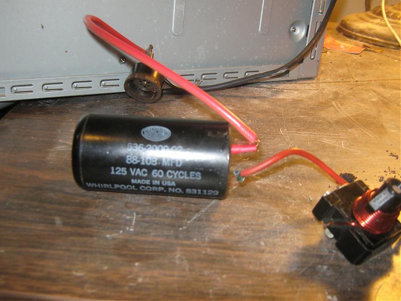

I recently had mouse the eat the white wire that goes to the compressor.
There is two red an white that u hook up to give electricity to power the compressor.
A relative took the off the compresor where common start run prongs
he made a mess.
This unit has four prong running capacitor.
i need diagram on how rewire it back up a few of the wire on the capacitor
an overload relay were showing signs of age.
So the wiring diagram would be helpful
I have hooked up other refrigerator compressors fine fine just not one that has this 4 prong running capacitor

This is a very old refrigerator. The wires from the refrigerator are red and white. The two red wires get shorted together and go to the spade terminal on the coiled start relay, the white wire goes to the round overload, there is no run capacitor. The start relay plugs into the bottom two compressor terminals, the overload plugs into the top terminal.

On the capacitor there should be two red wires then white an blue
On this setup there was wire going to common i think i maybe wrong/
I tried a different relay over load the compress on 10 secs came then shut off
I also took pics of the relay an capacitor.

`The old compressor terminals where common pin on top , start pin, bottom left and run pin bottom right. The overload wire (the round item) plugs in the top pin, the relay plugs in the bottom two pins. One fridg wire plugs into the overload, the other plugs into the coiled relay. The condensing fan wires are in parallel to the refrigerator wires.
On the relay the bottom of it I see the coiled copper wire.
Does a red wire plug on there.
On the top of relay there is blue from start capacitor going to the relay.
See there was a white wire the one that was broke on top
Would a picture of the relay help

I have a white an blue wire on the start capacitor the blue goes to the relay/
the white wire i have going the overload switch going to common.
Next we have the red wires on the start capacitor.
I see only one place on the relay to plugin a wire on the top side.

You probably have a bad component. I would order a new start device, AP4503032 for this, comes with wiring info.
Here is my relay an start capacitor.
I know relay is not rats a wire into thats all
I have red wire red wires on on one side of the start capacitor
I assume one of the red wire is attached to overload that goes to common
The other red wire is made onto the relay the bottom of relay
Next we have the other side of start capacitor that has two prong
the blue coming off the side of the relay next we have a white wire
i see a place to plug wire beside blue wire
next i see a a place to wire on top of relay
