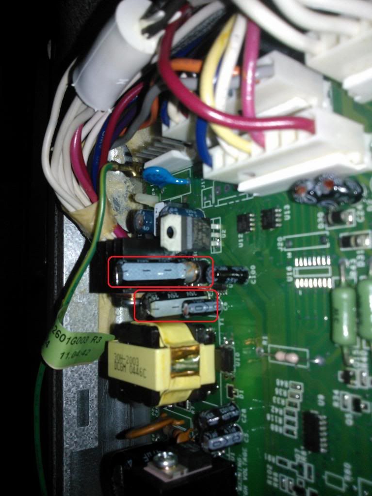

I was searching through the site and found this post:
http://forum.appliancepartspros.com/refrigerator-freezer-repair/2538-clicking-noises-back-ge-refrigerator-29.html#post779125
Both of the 470uF/25V capacitors were bulging, as you can see here.
I have a soldering iron and a little experience soldering from college, I’m willing to take on a $0.50 replacement as opposed to a $130 replacement. I will replace the capacitors with the exact same specs, unlike the OP. Do you have any advice or objections to trying this? As I see it, if the board is already broken, I can’t hurt things.
I have no experience on this, but you might be wasting time, capacitors usually don’t go bad unless there is some power supply problem which is hard to fix.
