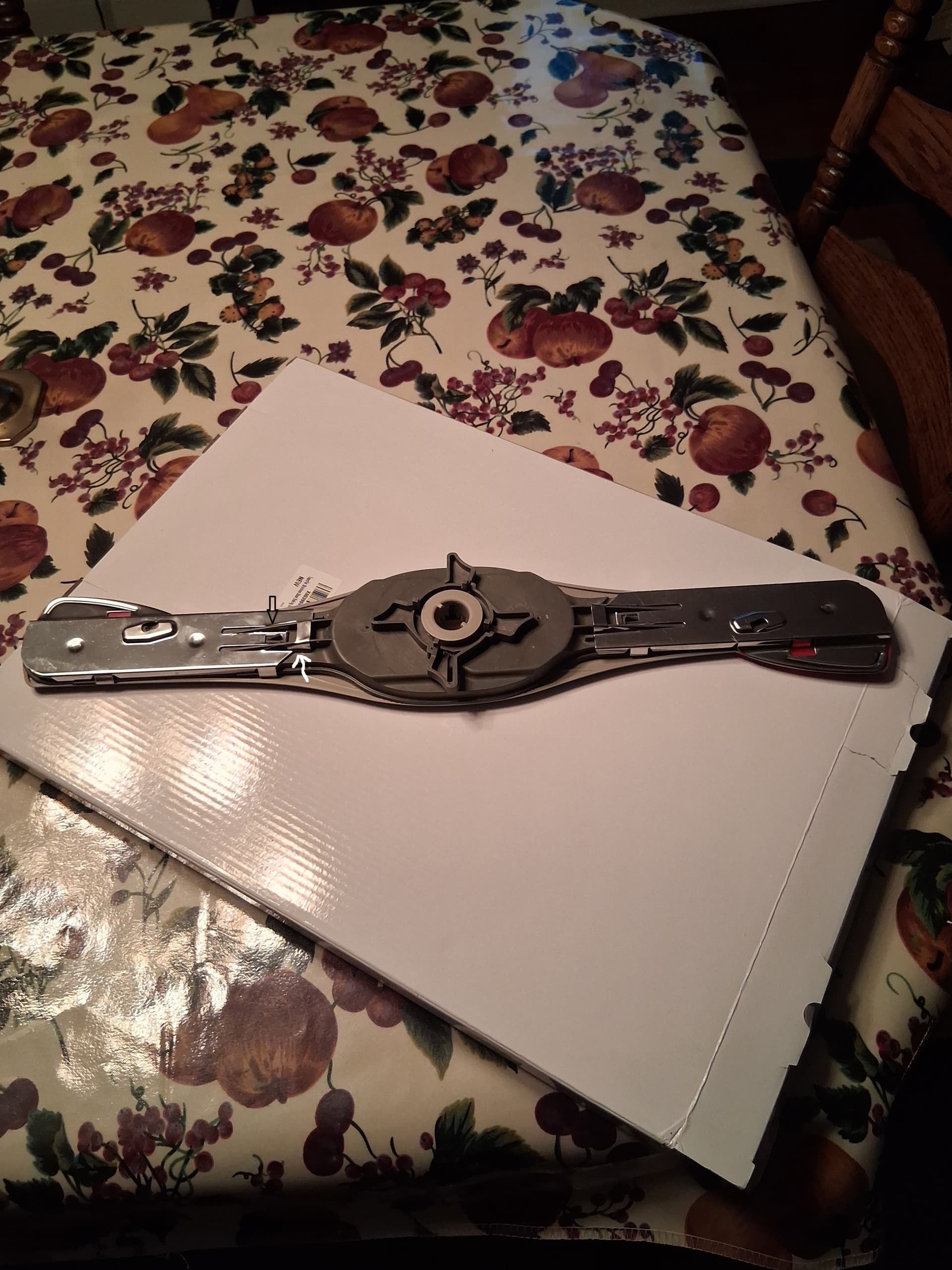

Is there a trick to confirm leak or crack in the lower spray arm? I guess water only exits thru the holes. Can I confirm leak by hose into center hole or submerging in water to see bubbles? Don’t want to buy one if not the problem.
Also, isn’t there an electrical on/off switch for the float that could fail, even though the mechanical rod is moving when the float elevates?
Removing the lower spray arm and visually inspecting it would be the easiest way to identify if there is a crack. Regarding the float switch, it can fail in a closed position. However, if that were the case, the dishwasher would overfill at the beginning during the initial fill cycle and any time the dishwasher calls for water.
I have read that the lower spray arm can be checked by immobilizing it in the 12/ 6 o’clock position to see if it still leaks. Do you think that is worth trying and not harmful?
While not harmful, it would not be a way of verification. Placing the spray arm in a 12 to 6 position would cause a leak if there were a crack. On that same note, if there is something else causing the leak, this would not eliminate the spray arm as a possibility.
When I fill arm with water, water leaks (see arrows) where chrome meets plastic, only on the left, not on the right. Is this the culprit?
Regarding immobilizing the arm at 6/12, I am think that if the arm doesn’t rotate, then the turbulence is sideways and not forward to the door. Am I wrong? Just wanting to double check with you. thanks.
The direction of turbulence when setting the spray arm at the 6 to 12 position is very dependent on what is occurring with the spray arm. The spray arm should not leak from there and this would certainly cause the issue. From what I can see, it looks like the new spray arm for this model has been revised. WPW10491331 Spray Arm | Genuine Whirlpool OEM In Stock

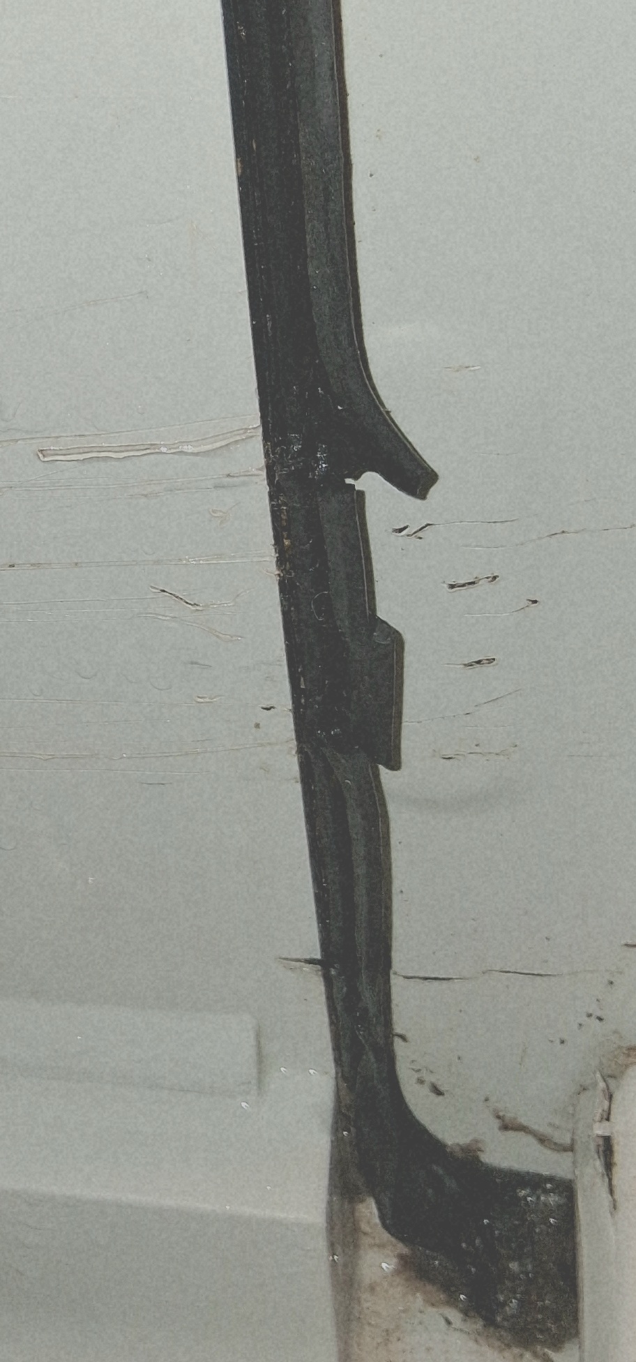

. Leak is still there, gushes out the bottom of the door at 9 minutes of the 18 minute quick rinse. I stopped it by opening the door, activated drain until complete, started cycle from the beginning again and the leak occurred immediately at the bottom center door. The right corner insulation behind the door is wet, the left is not. I have taken a pic of the door gasket on the right side where there is a tear that was dismissed by repairman years ago, and it looks the same but hasn’t leaked, unless it is the source now.
Seems to me that a door gasket leak would be constant and start at the right corner as a drip, not a gusher from the center after 9 minutes. It’s as if water is collecting at the bottom of the door until it overflows. That could explain the delay in leak when dry but an immediate leak when I restart after the leak occurs. Am I wrong?
This unit does not have a seal on the door bottom.
