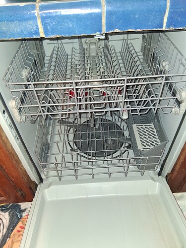

Would it be possible to provide a picture of the entire trough section of the tub from gasket to gasket after the water has filled? While it is possible for a microswitch to click and fail, it is very unlikely that it has failed in a closed circuit position and still click as if it is opening the circuit.
I have tested the float switch and it ohms out correctly, closed with button pushed in and open otherwise. Are you asking me to let it fill normally but stop before it overflows, and then take a pic with the door open. I will do what you wish if you clarify how I should do it.:slightly_smiling_face:
If you could send a picture of the trough after the initial fill, which should end within 2-3 minutes of starting the dishwasher, this will allow me to see what the water is doing. This will also allow me to see how far the water level is reaching. An up above view and a 45 degree angle from the front view would help give me an idea of what you are seeing.

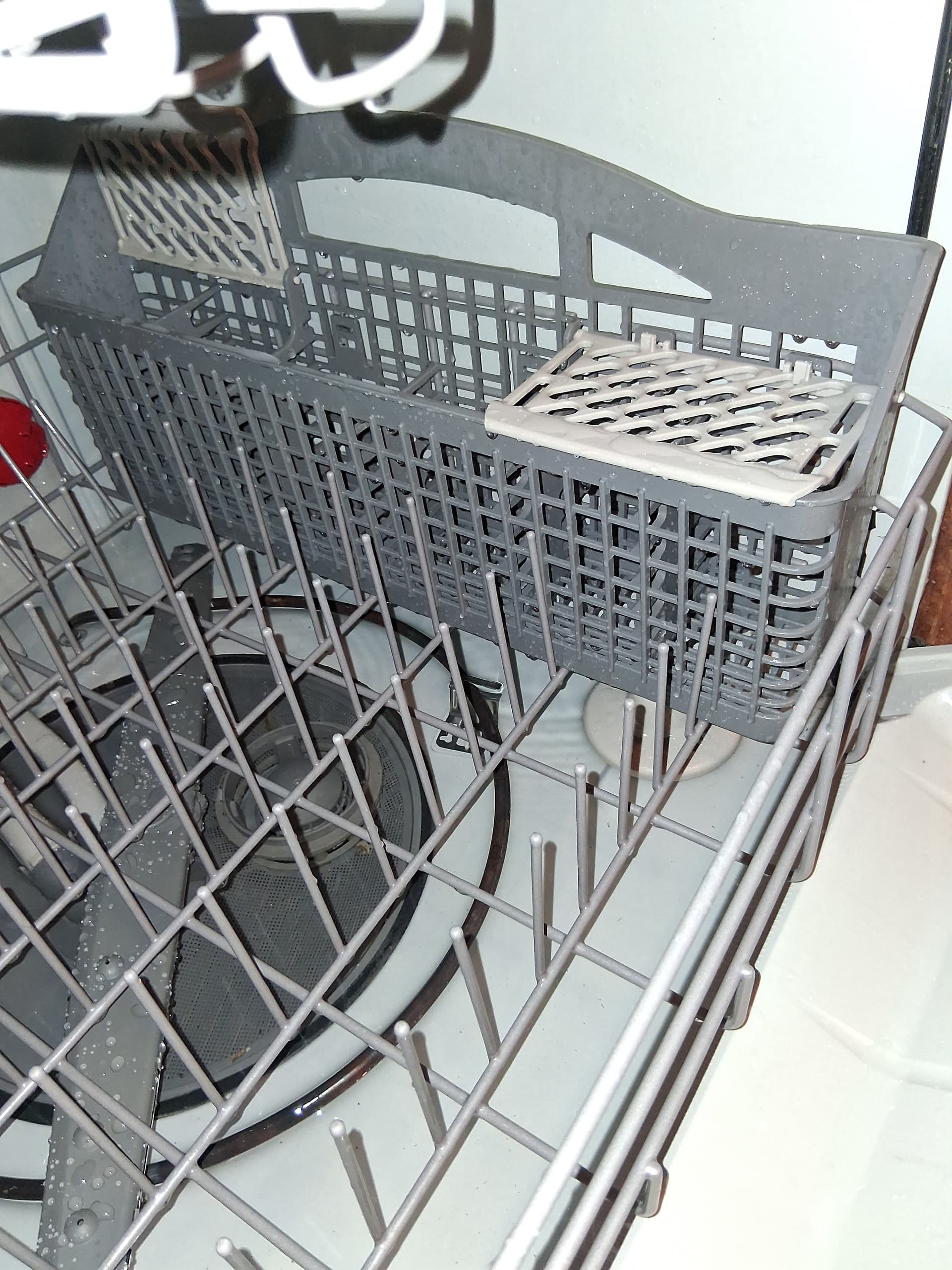

I have 4 pics, click on them to see label, pic 1 and 2 are before start, nothing from valve port on left, dry bottom.

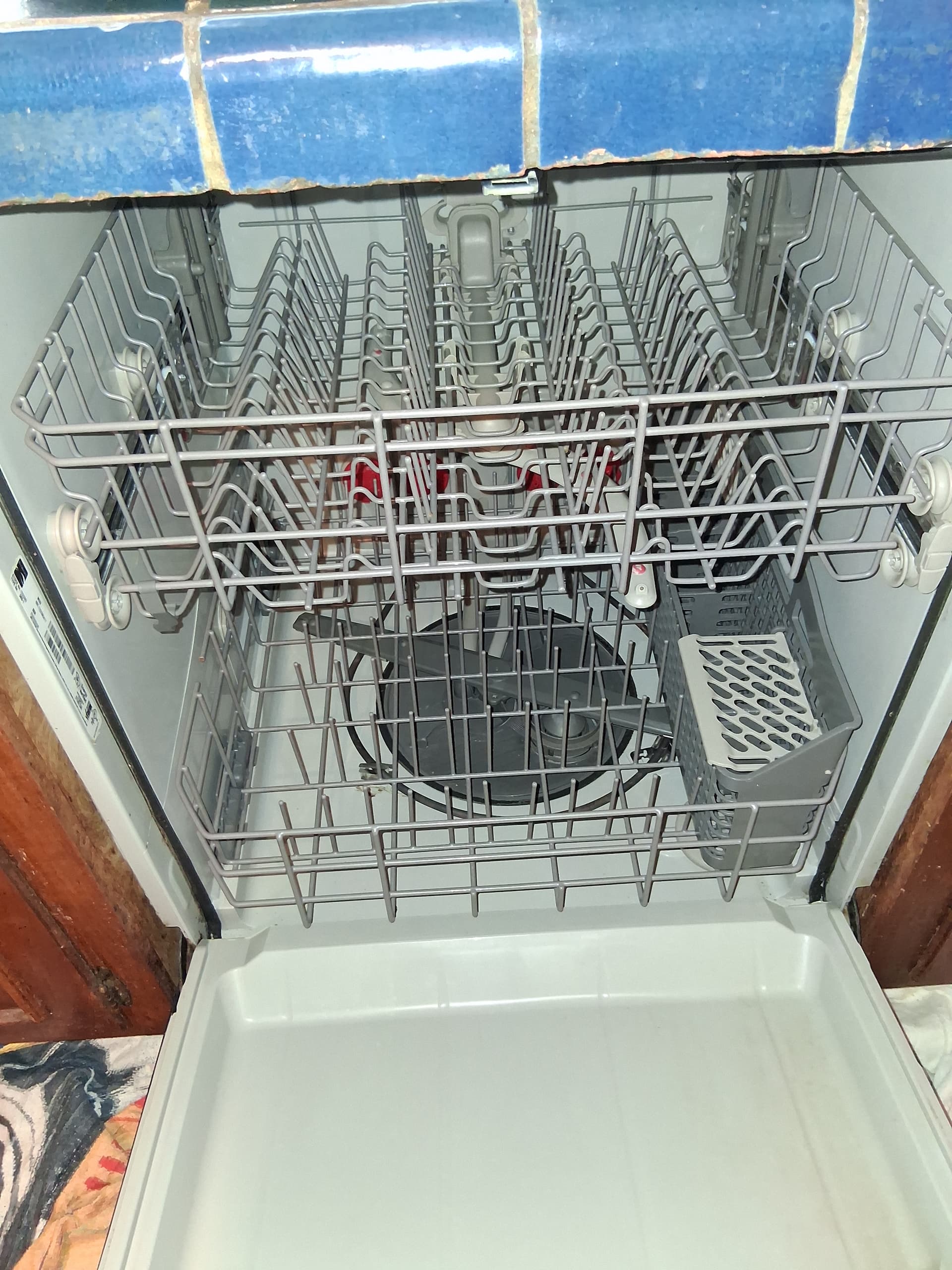

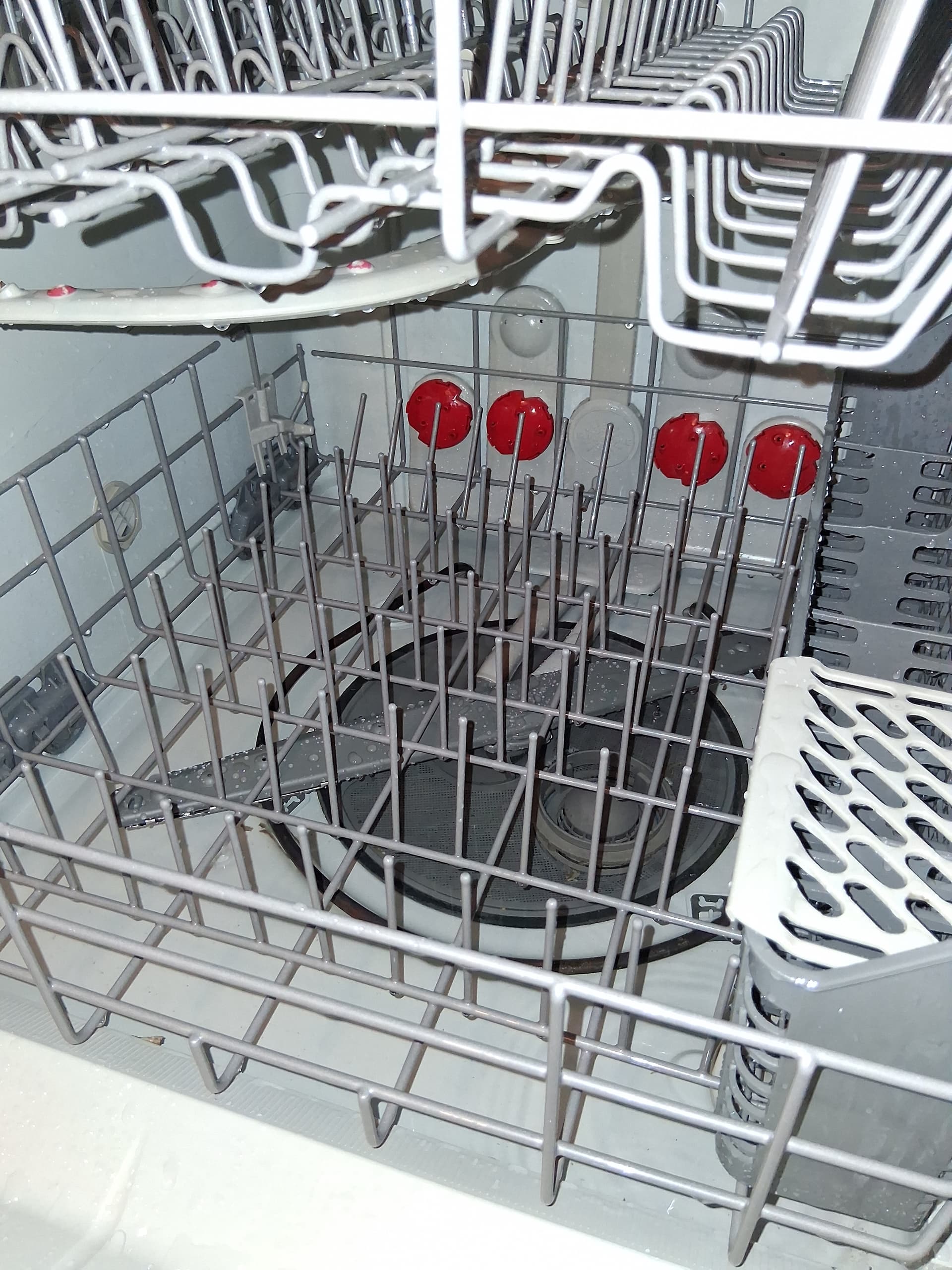

3 and 4 are after running 3 minutes, door open, nothing coming from valve, water at level of element and base of float.

Hope this helps.
In the picture where the float can be seen, is the float submerged under the water?
Water at level of element and base of float. The float switch tests okay and the float moves up and down w/o binding.
