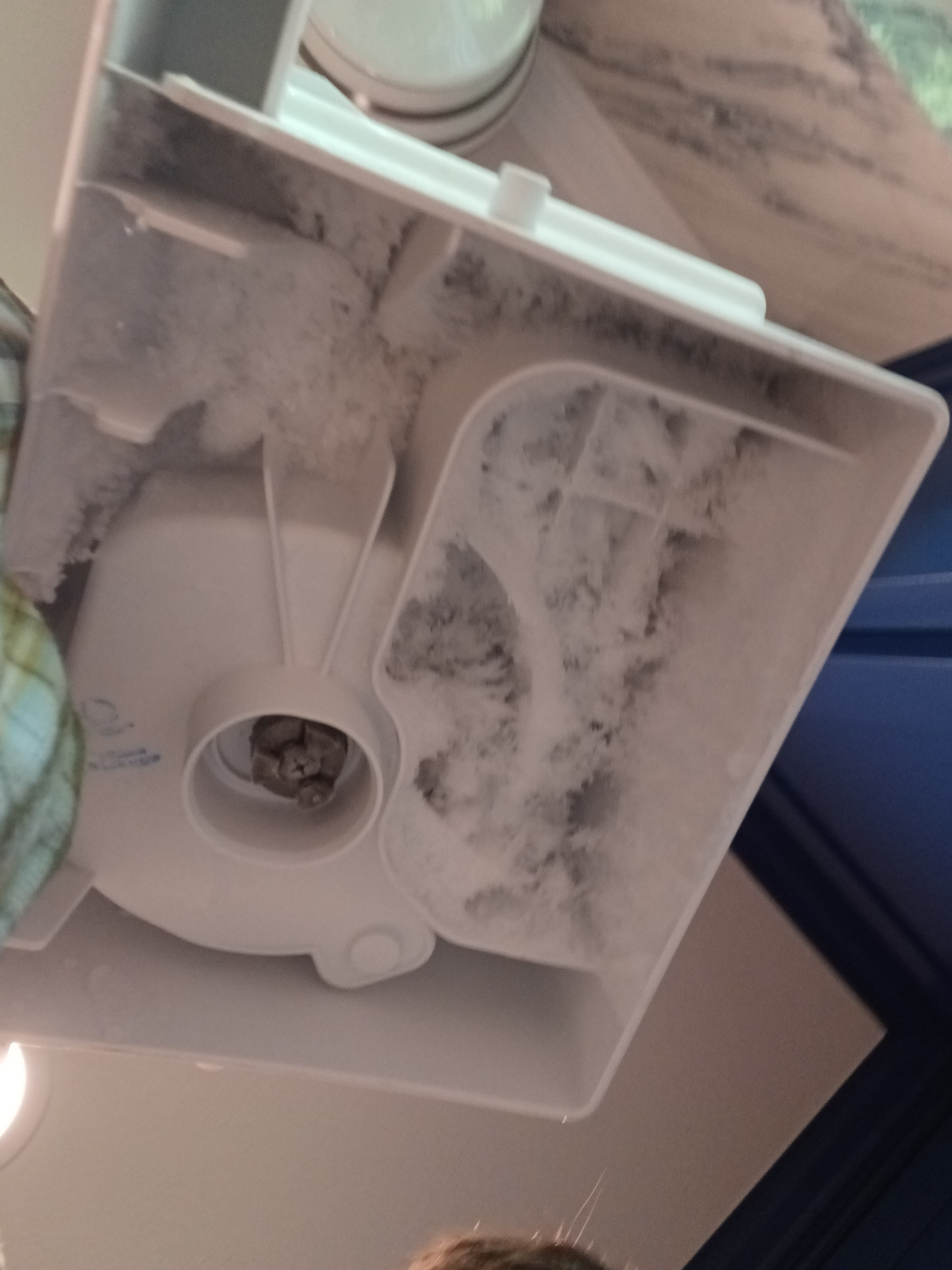

No filter, pwr outage or service related to code. Ice reservoir was removed recently for empty and cleaning.

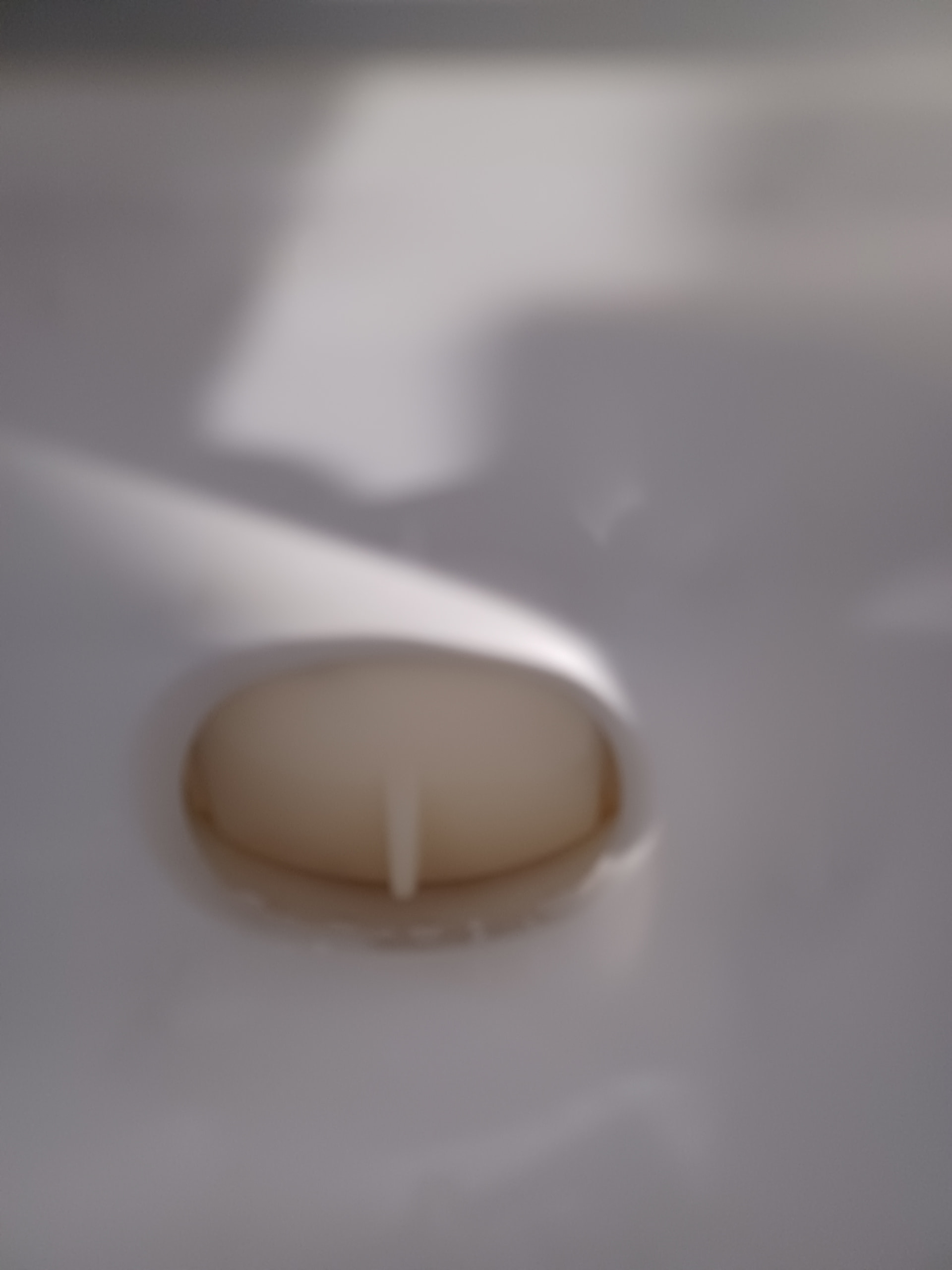

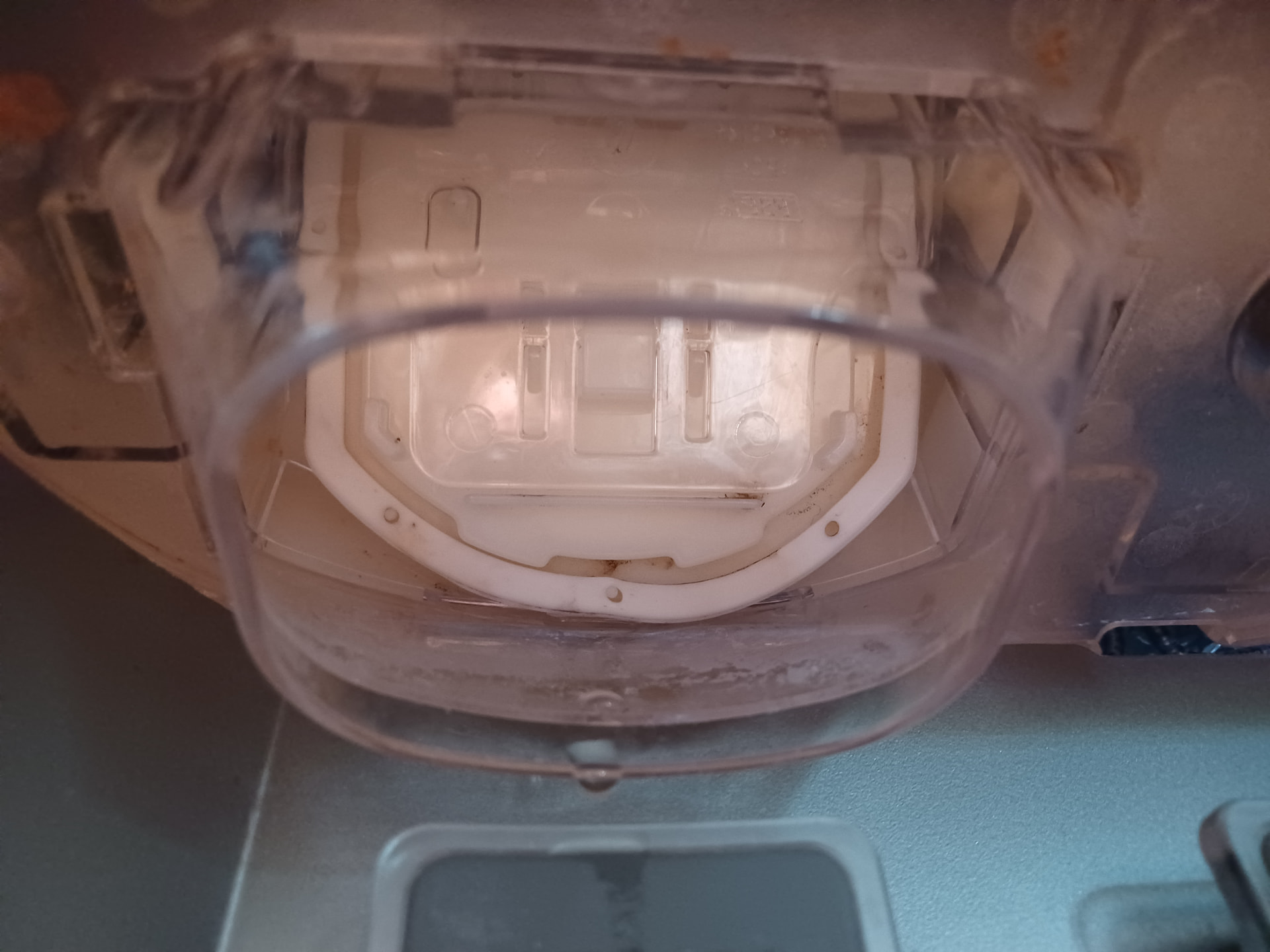

Seems ice flap may not be fully closing.
If the ice chute flap (dispenser door) on your Whirlpool WRS588FIHZ00 is staying open, that can definitely cause strange electronic behavior, moisture intrusion, frost buildup, and in some cases control/display issues. The flap should snap closed immediately after dispensing ice.

The flap seems to close correctly after dispensing ice.
The ice/water display panel was replace about a month ago when the measured full water function would run without prompt.
The ice dispenser door does not fully seat. It can be closed the remaining 1/4" by hand gently.
I suspect there may be an issue with one of the control boards, the ice maker motor, or the dispenser auger motor.
To help narrow down the cause, could you please answer the following questions?
  1. When the ice maker is turned on, does the fault occur only while dispensing ice, or does it also occur during normal ice maker operation?
  2. Does the “01” light still illuminate when the ice maker is turned off?

The error code only clears if the power is turned off to the unit. It doesn’t throw the code again of the ice maker is turned off.
Once the 01 code appears the fridge/ freezer stops cooling, neither of the lights inside work. The display panel shows 01 but none of the buttons work.
Sounds like something is shorted in the Icemaker or the motor is going bad. At this point I would suggest replacing the icemaker ( W10873791 Refrigerator Ice Maker Assembly | Genuine Whirlpool OEM In Stock ) and then see if the issue returns.
Before getting a new icemaker I would carefully inspect all wiring for burnt or loose connections
