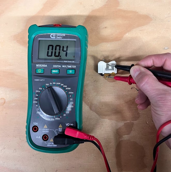

passed - electrical resistant test of thermal overload device (low resistance of 0.4 ohm, see photo below)

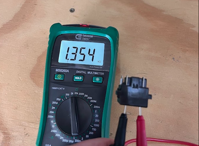

presumed failed - room temperature resistance across compressor start PTC relay (high resistance of 1.3 kohm, see photo below, should be 3-15 ohm)

Your testing points toward the start circuit, but I would not spend $100 on the PTC relay solely because it measures 1.3 kΩ.
For the GE GFSS6KKYASS, the symptoms—no cooling, compressor getting progressively hot, and periodic clicking from the compressor area—are consistent with the compressor trying and failing to start. Your compressor winding readings are internally consistent: C-R = 3 Ω, C-S = 9 Ω, and R-S = 12 Ω, and no winding-to-ground short is a good sign.
The important catch is the PTC measurement. A PTC starter’s resistance specification depends on the exact device and how/where you’re measuring it. I wouldn’t assume that 3–15 Ω is the correct specification for this refrigerator’s relay without confirming the service data or exact part.
Before ordering anything, I’d do these checks:
  1. Verify voltage at the compressor/start device. When the refrigerator calls for cooling, you should have approximately 120 VAC supplied to the compressor start assembly. If 120 V isn’t reaching it, replacing the relay won’t solve the problem.
  2. Identify what is actually clicking. If the click is the compressor overload opening, followed a while later by another click as it resets, that’s classic evidence of a compressor that isn’t starting.
  3. Inspect/test the complete start device. A bad PTC relay or overload can absolutely produce your symptoms. If the PTC is cracked, rattles when shaken, is discolored/burned, or its measured behavior is demonstrably outside the specification for that particular part, replacement becomes much more compelling.
  4. Don’t rule out a mechanically locked compressor. Your resistance tests establish that the compressor windings aren’t obviously open, shorted to each other, or grounded. They do not prove that the compressor can physically start. A locked rotor can pass every resistance test you performed and still click the overload repeatedly.
The most useful next test is an amp-clamp measurement on the compressor common lead during the attempted start. If current immediately shoots close to the compressor’s LRA (locked-rotor amperage) and then the overload clicks open, the compressor is failing to start. A known-good start device can distinguish a failed starter from a mechanically locked compressor.

For GE WR07X10112, the compressor PTC start relay, GE does not publish a specific ohm/resistance specification. GE’s own parts listing gives no electrical test value, and AppliancePartsPros specifically reports that the manufacturer provides no PTC resistance spec.
Recommended check: with the refrigerator unplugged and relay removed from the compressor, check the PTC for continuity. An open/infinite (OL) reading indicates a bad relay.

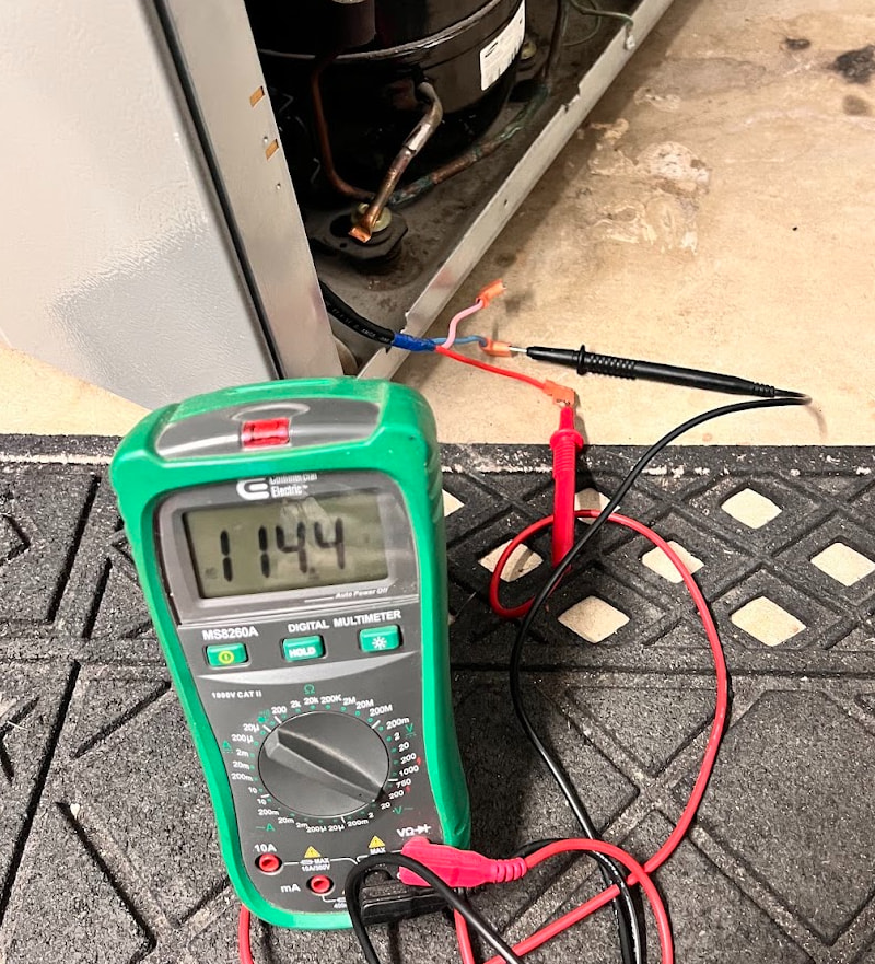

I did check for 120 VAC coming from the control board measured relative to both return lines and confirmed that it is present in the images below.
The identification characters on the PTC relay are PTHTM 100MD 3M87 (as shown below)
At room temperature (approx. 77°F / 25°C), a functional PTHTM 100MD refrigerator PTC start relay should read between 4 to 15 ohms across its primary active terminals
Got it, and mine is 1.3 kiloohms, so fundamentally is stands to reason its the problem, right?
That would be my first impression and where I would start at replacing
Wrapping up this thread. I did try replacing the PTC with a cheaper and slightly different variant but something that should have worked. The thermal overload continued to trip after turning the system on. I then tried to manually power the compressor with direct voltage application and had a hard time getting it to spin, so presumably the compressor was bad/frozen. The fridge was replaced.
