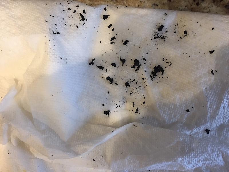

Thanks for all of your input. So something interesting happened. I decided to take out the water inlet valve to take a look. When i disconnected the black hose that feeds water into the dishwasher, the water drained back out onto a paper towel and covered it with a black charcoal like substance. i have attached a photo.
I took the black hose off and it looks like it may be deteriorating on the inside and i could keep flushing out the black charcoal substance from the house. i blew aw much out as i could and also cleaned the valve and the part inside the dishwasher that the water comes out of but still looks like im not getting enough water. how likely is it that the inlet assembly is faulty? im leaning towards the inlet valve
Just an update. I fixed my dishwasher, the water inlet valve was faulty, the black in the dishwasher is a different issue. I need to get the hose replaced.
